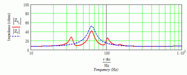

Like I said in my previous post, I am trying to get some measurements from my bib's. For now I am only measurnig impedance/phase, but soon I will be able to do fr, and rest...
Results are totaly confusing at this time, and I hope someone here can help me 🙁
Here's impedance chart:
When I saw that, I wondered if my equipment was malfunctioning. Then I checked with some different drivers and boxes and eliminated that posibility.
Then I removed the driver (fe126e) and set it up for free air impedance measurement. Here's the chart for that:
How can this be? Datesheet says fs=70Hz, and I get 100hz.

Welcome to the reality that manufacturer's specs are often not just off, but way off, though if this is a new driver with no break-in, then Fs will be somewhat higher.
GM
GM
What GM said. And if you think that's bad, you should see what Lowther are like for creative T/S claims. 😉
Expanding a little, it'll probably also depend on how you're measuring. If you're using a low voltage driver, then Fs for example will tend to be off, plus, as Greg pointed out, it depends on how well broken in the drivers are. An Fs of about 90Hz is typical for a loosened up 126 IIRC.
Scottmoose said:Expanding a little, it'll probably also depend on how you're measuring. If you're using a low voltage driver, then Fs for example will tend to be off, plus, as Greg pointed out, it depends on how well broken in the drivers are. An Fs of about 90Hz is typical for a loosened up 126 IIRC.
This is part of it, your driver is fresh is another, and with the luck of the draw your 126s seem to be at the highish end of normal.
I have measured some 100 FE126 and Fs (with my measure kit) is typically 85-100 Hz before mod and 3-5 hz after.
The same driver can also vary ~5 Hz depending on the weather.
Keep in mind that T/S measures are a curve not a single isolated number. If Fostex measured 100 drivers with 1 V drive and you measured with a computer with millVolts of drive, the results are totally consistent. Further, the factory numbers will be an average... driver to driver variation for the 126 is quite tight box-to-box (10/box) at about 10%, but if you go across multiple boxes across time it goes up to 20%. Other name brands are not as tight, and from some manufacturers i wouldn't be sirprised to see 30%.
Note that FE127 measures similar and i regularily use the factory data to model boxes and i get the expected results.

ok that's a partial relief 🙂
they are broken in for sure, and broken in well (~700-1000 hours )
i measured with 1V drive aprox, because my ears cannot stand 2.82V (1W).
Ok, I was afraid that my drivers were bad, and that the box should have been different.
Now the tough question. What do you think of the first graph? Does it in any way resemble expected bib behavior? I couldn't find any graphs depicting impedance of a normal bib.
Red line is without damping behind the driver, and the blue is with a layer of damping directly behind the driver.

cheda13 said:Now the tough question. What do you think of the first graph? Does it in any way resemble expected bib behavior? I couldn't find any graphs depicting impedance of a normal bib.
That curve is reflecting all the resonances in the BIB... the smoother you can make the impedance -- damping & panel stiffening -- the fewer and smaller all the differences between the in box & out of box.
dave
cheda13 said:Does it in any way resemble expected bib behavior?
Yes, it shows that the cab is tuned to a lower Fp based on a 70 Hz Fs. A BIB is ideally tuned to an octave below Fs in which case the driver's impedance peak will be mildly damped by the horn and there will be two smaller peaks equidistant above and below it. Regardless, in a simple pipe horn it's academic, so you're fine.
