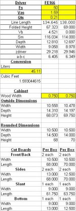

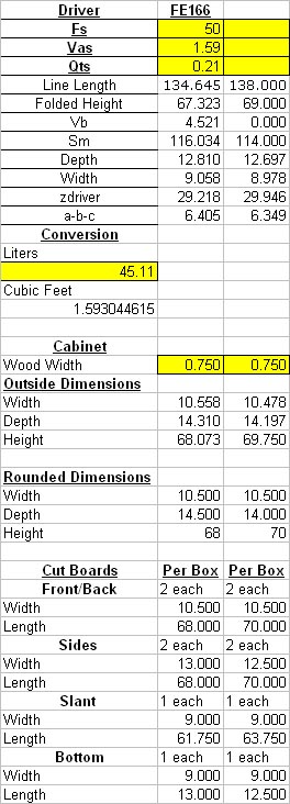

Re: ordered FE166ES
tilroh said:
Thanks Zero One, I quickly ordered two FE166es before I thought too much about other speakers. As suggested, I'll bolt them face to face, out of phase and play radio white noise to break them in.
I found Godzila's spec.s on the FE166ES-R and entered these in to his wonderful BIB calculator and got the attached. Does it look correct?
The VAS was not converted to Imperial from metric. Here is and updated view of the spreadsheet. Also, I plugged in the numbers from TC's original like GM suggested.

Re: Re: ordered FE166ES
Thank you zayne!
I've just ordered the 18mm ply. It's interior grade Hoop Pine with harder pine on the outside and softwood on the inside. I think the duel density will cut down on resonance. At least the idea sounds good.
Thanks again.

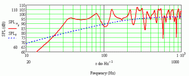

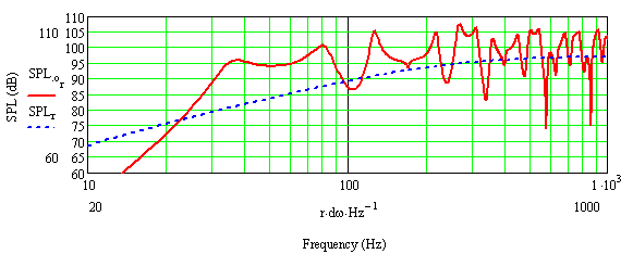

So upgrade to the 225 Jeff. 🙂 Nothing to stop you. You don't necessarily have to make them taller / longer or match to the driver Fs. That just sets the frequency it's tuned to (bit simplistic, but close enough. OK, so it's not optimal, but it still works fine). Just tune to whatever frequency you like & use WxD dimensions to provide the appropriate volume. Won't go much lower than your 165s, but you'll get better power handling & a much greater scale.
Just for you mate: a Godzilla shortened BIB for the FF25K. 136in line for a 68in tall box. W = 10in, D = 14.5in (including a 0.75in thick internal baffle). Zdriver 29.5in. About 2 years back I made a pair with 225s using roughly similar dimensions (few inches taller, bit narrower) for some friends. Suffice it to say, they work. Really rather well.
