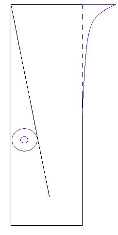

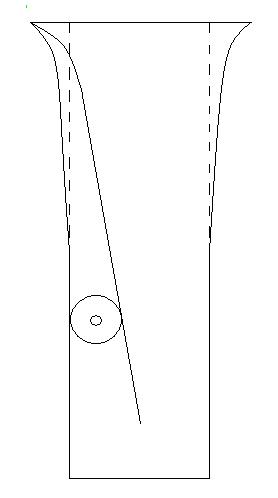

Thanks Scottmoose, I was thinking to compare bib conical expansion with tratrix calculator results and find compromise mouth size. And for
iiiiiiiii s, I was just trying to sound like Meg Ryan shawing off neckless...Perhaps my idea was not so briliant. javascript:smilie('
bawling
bawling
Tractrix = not much cop for bass horn use IMO. I generally prefer conical, or some form of hyperbolic / hypex. Still, YMMV.
