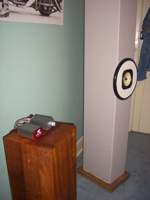

I own a pair of FE166E BIBs, and I wasn't much satisfied with the "plane jane" response of the slender BIB front. Just a matter of personal taste.
The usual answer that can be read here is either to add a BSC filter, or try with a suprabaffle. I resisted to believe a circular suprabaffle would provide much help to counter the BSC need. I did a simple test, and wasn't much satisfied either.
After this real world hearing tests I decided that the BIB deserved some more R&D, and did some simulations with Tolvan's "The Edge".
This are the results of the simulations, and the design of my alternative SDB.
First: standard BIB, FE166E build to the results of the BIB calculators that can be found at Godzilla's site, with GM's formulea.
Drawing
FR
Second: BIB with simulated circular-like suprabaffle. Rest of dimensions unchanged. Notice the "bump" in the mids, the rapid fall in the midbass, just where the BIB mouth output is falling down, and the dip in the high mids...
Drawing
FR
Third: BIB with an "optimum" SDB (side-baffle). Rest of dimensions unchanged.
Drawing
FR
Of course this is only one side of the reality. It doesn't show the integration of the mouth and the driver radiation, but to me was evident that the sound without an addition was lacking "something"

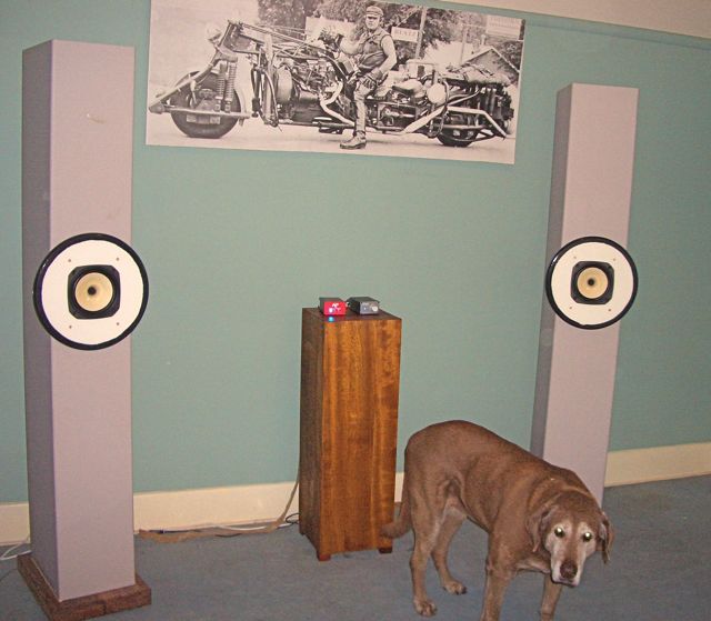

What I found is that this additional side-baffle not only looks well on paper, but it sounds well too. The FE166Es got the ability to "disappear" like the FE108ESigmas do !!!
I did the tests with just the leftovers of the build of the BIB, asymmetrically mounted . The right BIB SDB, was mounted to the left of the BIB, and the left BIB SDB, mounted to the right of the BIB.
I think it is a very easy test to do, with *no mods at all* needed just to see if you like how they sound, so totally worth a try.
The left BIB is on its own corner, and the right one is just wall supported.
I will definitely mount the SDB with hinges to improve the WAF, so as I can "transform" the BIBs for listening and make them slender looking for when they are not in use (or when I have guests 😉 ).
I hope this can add a new dimension to the BIB world, and give the sawdust-addicts a good excuse 🙂
Gastón

Wow Gastón... maybe you are onto something - leaving BIBs in their corners and adding a piano hinged 'wing' that conveniently folds out for listening and back when not in use. If your measurements reflect upgraded performance (smoother and more extended bass) and listening tests are encouraging, your wing could become an 'add on' option for critical listening. I will try it and see how it sounds. The only problem i can see in my crowded listening room is having enough room to unfold the wing. But i do think it's a neat idea and can't wait to try it out. Thanks for putting the thought into this and reporting your results!

Yes, they do... they are only sims, and of course results are depending on each different setup. I would say that for the straight BIB and the simulated "dish" suprabaffle, they feel like right for what I heard.
zBuff said:There should be still a lot of flexible to change the wing baffle to something a bit more stylistic.
[/B]
The reasons of the shape were: wing width = width of the leftover I had (now it has been promoted from leftover to BIB Wing. One SW fan could name them "Wing Commanders" 🙂 ).
Height and angles: This I sized to minimize nasty peaks.
What I intended with this is just to show an alternative approach that could work (adding a full body baffle, and that symmetrical things appeal to the mind but not necessarily are good in the FR domain. Also that perhaps the "dish" should be correctly sized with other than an aesthetics approach.
An interesting thing I got from the sims were that symmetrical wings of any shape always added a peak in the response. With the right sizing that could be used to iron some particularly annoying dip.

I tried adding a few different sized wings today. There is a definite change in the sound. I hear added weight to vocals (i spent about 30 minutes listening to a Squeeze CD with and without wings). Vocals are fuller, especially on multi singer harmonies. I liked the change but have to decide what size wings to make. My BIB uses the 165k driver so it is in the 165, 166, 167 family of Fostex drivers. To me, the best sounding wing was about 6 inches wide by about 60 inches tall as compared to a wing 11 inches wide by 30 inches tall. I may split the difference and make some cosmetic alterations ending up with a wing 7 inches by 42 inches and call it a day. This way i can enjoy the improved sonics as well as enjoy this unique wing feature. I may play around with more sizes but am convinced for now this will only make the BIB even better. I have no measurement tools, just my ears. But i did like what i heard. If you think vocals sound thin on your BIBs this is a tweak to play around with.

I noticed the same added weight when I added a BSC. I like the fullness and I'm sure the "wings" are doing the same effect.
Yeah, but they are doing it without adding anything inline with the signal/source . This has to do with wave propagation off the baffle, and is IMO a MUCH better alternative to a BSC circuit , being closer to a cure rather than a quick fix.
