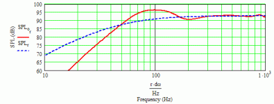

Well, to get the drivers down to ~ear height, the 'stock' ~48.78 Hz (Fp = 24.34 Hz) solves the height problem, but due to the medium high Qts and Vas we're still talking a ~27 ft^3 cab, fairly large even by my standards, so it's going to be impossible for these to 'be all they can be' in any reasonable size cab unless you want to buy two more to make them isobaric, assuming you consider a ~13.5 ft^3 cab 'reasonable' as I do.
Here's a modest size Alpha TL that when properly positioned to get some room to fill in the bottom octaves should be OK for most music:
L = 44.44"
W x D (CSA) = 214.985"^2
All dims inside (i.d.) and approximate. Place driver at the top front and the vent cutout = CSA at the bottom. Can be one big hole or spread out around the sides/rear. Make it as wide as practical to reduce/eliminate the need for any BSC. Stuff to 'taste'. Note the sim is 1.0 lb/ft^3 of polyfil.

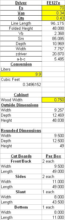

A small review is needed
My BIB is a year old or so.
From measuring the one I have regards line length, something looks off.
Is there a place (which I thought there was) where all the
measures are given for the Fostex FE127e? The usual Zilla page I go to has line length of 97. That would mean a divider of 48 plus inches.
Remeasuring, my divider is 45 in. I know I did everything carefully
and that the A-B-C was 4" and my front is 49 1/2.
It's puzzling that these are different. That or I have forgotten something-- always a possibility
This one will have the double baffle board front so the driver clears
the space available at 19.5 in down from top. My width is 6 3/4.

Was able to download and use the BIB Calculator .xls file in my
Open Office Calc.
I got out my spec sheet from the FE127e and started to plug in some values:
Fs 70Hz
Qts .43
Vas 9.9
Wait. The 9.9 did not look like the examples made for the
FE103 and FE165K. But that is what is on my data sheet: 9.9L.
I need some schooling on this. I got a bad value for A-B-C.
Thanks to Jeff and GM and all for making the calculator. I have not had experience with it before today.
loninappleton said:My BIB is a year old or so.
I quoted myself back here because I learned some things which I had overlooked before.
Open Office Calc.
Fs 70Hz
Qts .43
Vas 9.9
