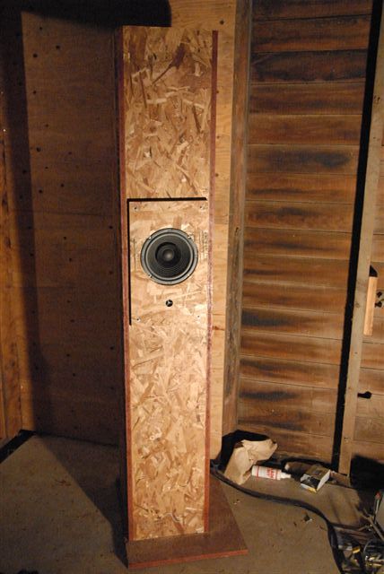

The OSB (flakeboard) cabinet DOES look cool. It sounds great too! Costs $16 a 4x8 sheet!We haven't put urethane on it yet because we are hoping to try a transparent yellow or orange stain on them first, to bring out the pattern more we hope.. Possibly paint the small baffle the drivers are in also.

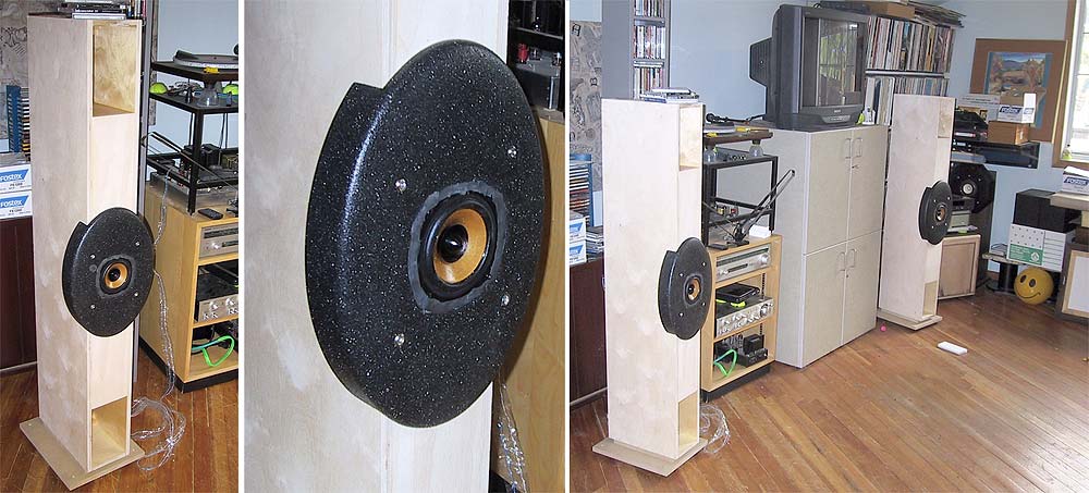

The Aiko is an alternate enclosure and the best i've heard the 108 (doesn't go as low as BIB and maybe even a bit bigger). Many more pieces to assemble thou (but really no harder)
dave
Scottmoose said:
I have to admit, they're pretty little boxes aren't they? 🙂
if you mean the Aikos - yup, and I ever get a chance to try them in my little room they might get past prototype stage. As Dave notes, of 3 or 4 different enclosures we've tried, the best sound yet from a unassisted or "corrected" pair of FE108ESigmas.
