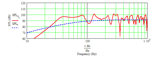

I'm playing with the spreadsheet and have some questions. My 166e BiBs measure out @
Line - 144"
sm - 88^2"
z-drv - 28"
yeilding a ratio of 1.79 ... and I am really enjoying them a great deal. I'm still amazed at just how low these things go.
Now, if I used the spreadsheet dims of
line - 134.65
sm - 116.26
z-drv - 29.22
ratio - 1.41
What changes might I expect?

You should be able to adjust the dimensions a bit Jeff; a longer line will go lower; so long as you preserve Vb, though tuning too low will cause problems in the mid - upper bass. Best to stick to the ~optimal ones IMO. That's why I didn't add any extra options to my own little sheet.

'Correct' is a floating target based on the driver's excursion limitations, room placement, etc., with T.C.'s original alignment being merely the 'default' one, so not the 'correct' one per se, only 'correct' for the 40-1354 and any other driver with similar specs if you believe it will play loud enough in your room to suit you.
Calcing a pipe horn using its T/S specs is strictly a starting point, so if you want the driver at a different height than the default tuning calcs, then change the driver's Fs to suit. Ditto lowering/raising Qts if you want a smaller or larger 'Sm' than the default calc, or change both if need be, though of course unless you know what trade-offs to expect performance wise I recommend you sim it before 'burning' wood.
For instance, you probably want to tune a low Fs driver much closer to Fs than an octave below, so increase Fs up to 2x (tuned to Fs) to get the basic height, etc., dims and since the calc'd Vb is based on a lower tuning, Qts could be lowered by the same ratio as the increase in Fs without any real penalty.

As I noted, nothing's 'cast in stone' and since this is a fairly low Fs driver a higher tuning than 'standard' seems a more reasonable alignment, though even a 'standard' height BIB may be too large for some:
http://www.diyaudio.com/forums/showthread.php?postid=1307286#post1307286
For example, using the 'standard' T.C. tuning of 48.78 Hz based on MJK's worksheet's 342 m/sec SoS rather than the Excel's SS too high value (IMO) to get the same height, driver location, then to calc the somewhat smaller 'Sm' and associated dims:
Fs ratio = 30/48.78 = ~0.615
Qts reduction = 0.317*0.615 = ~0.195 Qts
