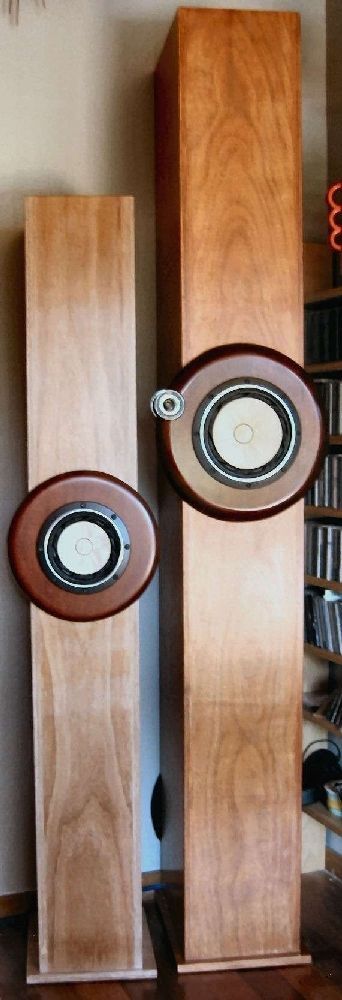

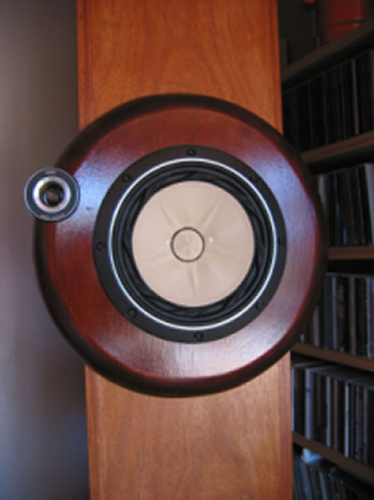

Just completed my FE208ESig/T90A BIBs so here are some pics.
Bit early for any real impressions or comparrisons with my beloved 168BIBs but clearly large scale sound and those T90As sound sweet.
Initially dissapointed with constricted sound and lack of bass but I had not done any break in on the 208s before the went in the BIB cabs whereas the 168s had 100 hours before I listened to them. Getting better tho and droping the cap on the T90 from 1uf to .68uf was definitely a help to reduce mid band dominance.
Build is regulation BIB and peretty much as I built the 168s (family resemblance obvious!)
Anyhow - the pics
Anyhow - the pics

Lovely work Chris. Give those 208s a hundred hours or so & wath the LF come up as the suspension loosens.
wow Chris! They look awesome!
Both the 168s and the 208s....
What kind of wood do you use? Nice finish!
How does the 168s sound? I have a pair but I haven't build the cabs 🙁 Hope in Septeber I'll start the project.
Thanks.
The timber on the 168 is marine ply but I don't know the type of timber, simple polyurethane finish . For the 208s its similar ply but not marine adhesive, in fact I was quite disappointed with the quality of the ply for the 208 tho the grain of the outer ply was really nice. I used a stain which brought out the grain and merged the end ply well before applying the poly. Both use MDF supra baffles with a redwood stain brushed on to look somewhat like wood grain.
Th 168s are awesome speakers - I wouldn't have gone for th 208s if it wasn't for that DIY urge to build bigger and better 🙂
You will find plenty of comments around the sound of 168 BIBs on the thread including plenty of my own!
