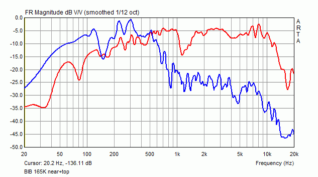

I think that the published graphs for the BIBs are simulated with none or just very light stuffing of the closed end above the driver. In my simulations heavier stuffing in this area will reduce the peaks in the response graph, but strangely the dips seem to get deeper (but very narrow, so probably not important). A little stuffing somewhere along the line does not seem to significantly affect the simulations.
A layer of foam, felt, or wool at the bottom will help reduce any mid+hf coming out of the open end. This will however already be reduced due to the bend at the bottom, and another bend through the room to reach the listener.
The attached graph is a measurement of my BIB with microphone just in front of driver, and at the open end respectively. The sound from the open end drops sharply above 600Hz. Due to the bend at the bottom it drops more than the simulation curves. This measurement is with a little damping at the bottom. The curve for the open end (blue) from 1KHz and upwards is probably mostly sound coming from the main driver which I am not able to isolate.
Apart from this, the curves seem to conform well to simulations, with some room irregularities below 200Hz.
SveinB.

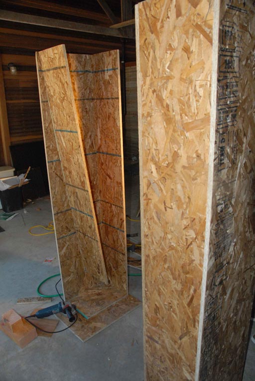

Here is an in-progress shot of a BIB with a BOFU What some of us call the Pioneer B20FU 8" It will probably be another week before I have it running. Obviously we used OSB or "flake board" . It costs only $15 a sheet in 3/4" (took 3 sheets) and is kind of cool looking. We hid the pieces with printing on them on the back and the side that will be in a corner..
OSB is made of soft wood like conventional builder's plywood but has a lot more glue, so it will probably be livelier (similar to birch? - we'll see) Total cost for a pair, with drivers is $100!!!! Just what the youth of today need to get into audio! And they will be able to drive their parents out of the house!
I plan to have it to demo at The BURNING AMP show October 20 &21 in S.F.
