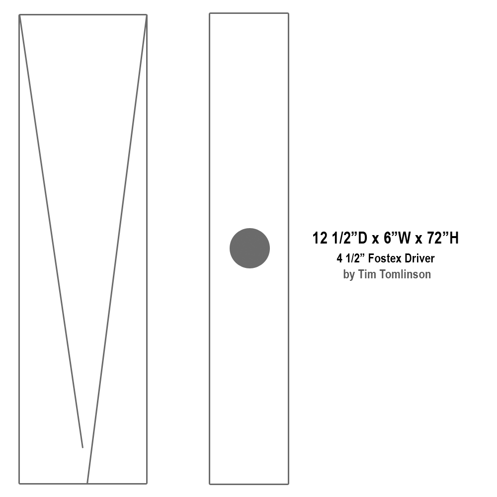

Here is the layout of the BIB I completed! I hope it helps someone. I also purchased Nagaoka Tetsuo's Mook Book #5 & it has many designs for the Fostex drivers, Folded Horn, Acoustic Suspension and Bass Reflex Designs. Detailed cabinet drawings and numerous photos are included. I got it at Madisound.com.
Interesting, I don't have the book, so is the right side triangular space unused? If true, then this would technically be a BVR style BLH rather than a BIB. If the plan is designed 'close enough' to your driver's specs it should easily out perform a BIB overall. Regardless, thanks for sharing!
A couple of questions........
Please explain why.....& what's BVR?
Does the small opening only allow lower frequencies to escape?
Would you then stuff the top & line the back & the bottom?
Would you use the same basic measurements as for a BiB or does the box-like inclosure need to be bigger?
Would this design eliminate the need for a close ceiling / corner?

re some of the above questions:
The BIB has linear expansion, so deviating means it's no longer the same thing. That doesn't mean its bad, just that you've done something different.
The narrow gap near the base will act as a filter, as in a regular BLH, restricting the passband of cabinet operation. What you've got here is a very large, tapered back-chamber (the first half), coupled to a horn vent (the 2nd half), so you have a blend of reflex & some horn action (view it as a BR box with a horn loaded vent). No bad thing, albeit arguably the diametic opposite of a pipe horn like the BIB. Yes, it probably would eliminate the need for wall / corner positioning as they're not needed to continue a horn expansion given that we've now simply got a reflex box with a massive vent. As for whether it'd need to be the same size -who knows? They're completely different in design terms & would be better off being designed with this in mind. A BVR is best done as a regular reflex alignment, and the vents then proportioned for optimal end correction / loading / whatever the design goal happens to be. It probably won't need much damping as little in the way of HF is going to get through. Again, best to treat it as a reflex box, get some material behind the driver to prevent reflections back through the cone, and then some lining at strategic points.
