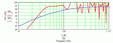

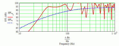

Without the box dims about all I can say is that unless BIBs are corner loaded and carefully damped to suit there will be some audible ripple, though all the reviews I've read said it wasn't a big deal overall, but as always YMMV.
Just 'running the numbers' using the formulas in post #3180, I get an alignment close enough to use the 'stock' BIB height and driver location, though with a larger Sm = ~135"^2. This should have a resonant structure very close to T.C.'s and many other same line length/height alignments that folks seem pleased with.
GM
Re: New BIB Project
Greets!
OK you did the math right, but I assume these will have the mouth capped off and a cutout added to the front for half space loading, so the ripple will be nearly as bad as the sim predicts, with no useful loading below ~100 Hz, so what you see is ~what you get if not at least corner loaded, ergo at least an 80 Hz XO will be required for HT, defeating much of the BIB's tonal benefits.

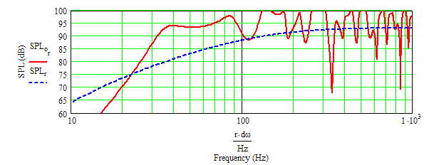

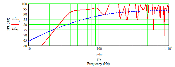

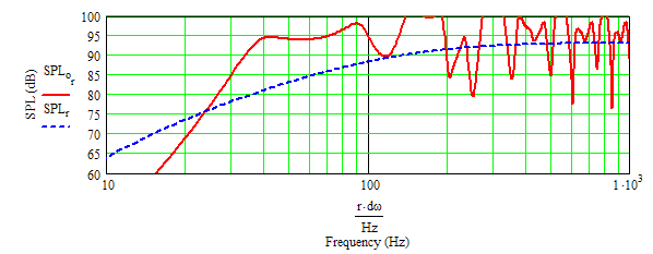

Thanks for your kind replay.
Here are the set of dimensions given by Scott buried some place in this huge thread but I had save a hard copy of it.
Quoting Scott answer:
“Tony, two ideas you could try for the FE164, a “small” and a “large”.
Small version:
65.75” tall
Driver 26.25” down from top
14.75” deep
8.5” wide
Large version:
65.75” tall (131.5 total line length)
17.75” deep
10” wide
These both assume ¾” material as usual and W&D are external”.
Greets!
You're welcome!

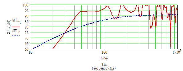

OK, using these specs:
Fs 50 Hz
Qts 0.31
Qms 4.0
Qes 0.34
Vas 32.2 L/1.137132 ft^3
Re 7.1 ohms
dia 13 cm/5.1181"
Xmax 1.0 mm
calc'd:
Sd 132.732 cm^2/20.573"^2
BL 7.1743 N/A
eff/sens 92.59 dB/W/m
The BIB I suggested:
L = 138"
Sm = ~135"^2 (9.75" W x 13.81" D)
a-b-c = 6.905"
zdriver = 30"
All dims i.d., not o.d. like Scott's.
GM

Obviously, the small one's bass output is enough to be audible, but the other two is ~ a toss-up, so whichever dims you prefer.
GM
