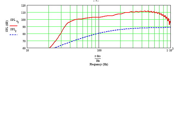

For a Fl = 122*0.52/2 = 31.72 Hz flare rate, Leach calcs:
CC = 2.772"^3
St = 1.889"^2
M = 0.542
Sm = 1792.325"^2 for 1/8 space
If the new WS doesn't plot based on flare rate/factor, then use a 256.811" long expo with a Sm = 3584.65"^2 to approximate it. It won't be as flat/well damped, but close enough to get an idea what an ideal BLH is capable of.

It does, though the simplified sheets are tricker to work with than the sections one IMO (ironic really). Anway, er, here's the calculated response. Oh boy...
Confession time: I never could figure how best to use Leach's math for a regular BLH. Any advice on that Greg? Off topic I know, so perhaps I'd best ask via PM.

So, solid to 36-38Hz? Is that the best you can do

The former (using the cut off frequency & M value), still in 1/2 space. I'm a little wary of the newer sheets though -the section one's fine, but I find the others tricky to get singing right. I'll shift to the old sheet & check again. Love that 105 - 110db sensitivity & 35Hz cut off with a 3in driver. 😉 Greg is The Master of The Horn.

Hmm, what length did it calc? In half space it should have much more gain around Fc. If the WS doesn't calc the length, then using the expo length will make it too short, screwing up the expansion. Anyway, when a BLH is long/large enough, it's completely reactance annulled and FR, phase, impedance, and excursion are ~flat lined to just above Fc, where it slightly peaks.

Aha! That would explain it: length still needs to be entered as a separate parameter to M value.
It shall be done. Thanks Greg.
