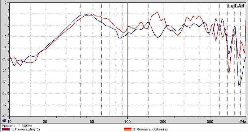

I'm still having problems understanding this resonator bit. Example, if I take a 600 ml. plastic water or soft drink bottle and blow softly over the neck a note is produced. I know my lips produce an air vibration over the neck, presumably quite a complex vibration, but one note is produced and all other tones are suppressed. If I then fill the bottle one third full with water and blow over the neck with as far as I can tell the same sort of breath and therefore the same vibrations caused by the lip of the neck in the airstream, a higher tone is produced. The resonator is producing a higher output of one tone each time. If this is so could it not be of use to correct dips?

Hmm, between the link I posted and Dave's explanation, I don't understand why you can't 'see the forest for the trees', but for sure a Helmholtz resonator can't fill a dip unless it's a minor one up in the vent's 1/2 WL pipe resonance, which is what you don't want it to do and one reason why it should be stuffed.

peterbrorsson said:An ellipse would be better.
I agree. Not only cosmetically, but sonically too (from an edge diffraction point of view -- Ron Clarke made some comments that suggest that a properly sized & shaped circular one might have better wavelaunch).
dave
peterbrorsson said:it's funny but according to Olsen's? work a circular disc is not good. Audio is funny, so many opinions! If there are
more than two people............
Yep. That's why i qualified my comment. Without Ron's comment i would have called the elipse better with no qualifiers.
But Ron has software that literally allows him to see the wavefronts, so when he says something i pay attention.
Also keep in mind that any suprabaffle should have a trailing edge. The trailing edge makes a heavily champered circle into something closer to a sphere, which Olson's graph show as best.
If you have seen the iBIBj drawings it shows at least one layer of trailing edge -- more would be better.
dave
It must be a heck of a chamfer/thickness of baffle, if it would be useful, compaired to a sphere. Well, compromises as always......
Cheers
Peter
Going to step in hee and make some comments on what i have seen in my sims.
If you take a very large area flat baffle and IB loading you see the true FR curve.If you add a given shape baffle that has a given diffraction pattern the end result is a combination of the two.
A circular baffle will support a spherical wavefront an ellipse that is narrow will support a wavefront that takes on the shape of the baffle at a given frequency. As the frequency rises the support of the shape becomes less.
It all comes down to what wave length needs support and what shape you want the wave to be at a given frequency. Remember, at a given frequency the baffle is a secondary transducer with a wavefront that takes on the shape of the baffle. The edges of the baffle produce a later timed slightly attenuated wave. All in all its easier to design in a spherical baffle or a near pyramid shape because there is less edge diffraction than having to desing in the diffraction pattern to match the natural FR curve.
