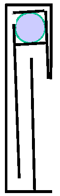

This is really rough (I'm at work, what can I say ;p), but I was wanting to see what you guys thought of this design.
This is for a Pioneer B20. This would be 48" tall by 12" wide and I'm assuming an internal depth of 7" (though I'm sure I could move up to 8" with just a shorter mouth opening without issue). Basically just folding the recommended BiB up into a space I can place using as much standard precut lumber as I could. Line length and zdriver match the recommended design almost exactly.
So, think this will still work? Is this like having a compression chamber on a horn? Might the chamber, which by itself would model a pretty good hump right above 100Hz, help negate the first big dip on the BiB response?

Scottmoose said:Within reason yes.
ok..........................let me guess...higher F3?
And Sm stays at 133.875 in^2 ?
Kensai said:So, think this will still work? Is this like having a compression chamber on a horn? Might the chamber, which by itself would model a pretty good hump right above 100Hz, help negate the first big dip on the BiB response?

No, it's a low pass filter chamber, same as the front chamber of a FLH. The room is a BLH's 'compression chamber'.
Could, but if the pipe doesn't damp it well enough it will audibly ring all the way up, ergo it will probably need to be a lot bigger than your sketch implies, but only one way to find out AFAIK. Not many 'free lunches' in audio design.

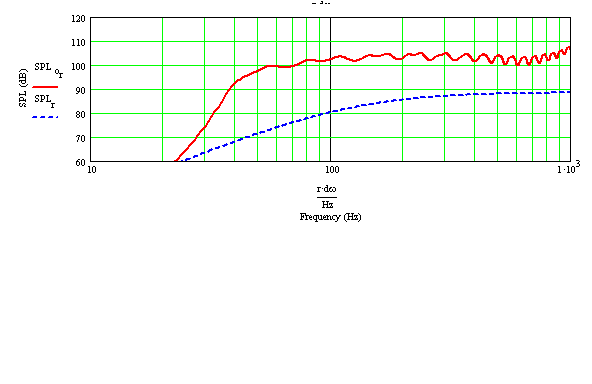

This the sort of thing you had in mind, 'regular' BLH-wise for the FF85K Greg? This is about the best I can do -stays within Xmax to ~60Hz, below that, I can't get it down. I sized the mouth assuming corner loading (the size here is what gave the attached response). A trifle excessive I suppose, given that gain is so far above nominal for the driver alone, but I figured best to go with what you taught me: go for gain as it can always be damped.
Exponential flare. Rear chamber volume 0.65 litres.
Length = 192in
Throat = 2.2in^2
Mouth = 1147in^2

Now THAT is an impressively oversized enclosure for a 3" driver. For anyone not keeping score, just the mouth alone is almost exactly the area of a 2'x4" sheet. Folding the 16' exponential taper line up into something that could actually be built and fielded would/will be a hell of a task, but I'm thinking the thing would be 6'-8' tall, 2' deep and at least 2.5' wide (not to mention weighing 200+lbs).

Not small is it? 😉 Makes an interesting exercise anyway. I don't pretend this is a good 'design' -I knocked it up in less than 5 minutes, but it gives the contrast between the hybrid cabinets usually seen, and something designed more from horn theory (or very nearly). I really should have refined the design a bit, but this was just a quick thought experiment.
