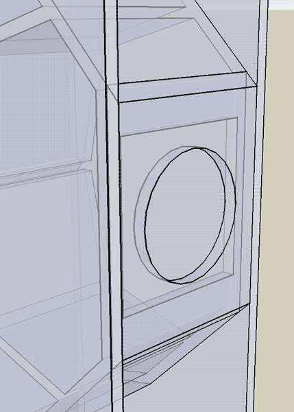

I have a quick question that shouldn't take much to answer.
I am just putting the fronts on my BIB enclosures and have offered up the drivers to the holes (no supra baffles yet - still need to find a turner). The hole dia for the FE168ESig is 155mm and looking from the side, 18mm thick ply leaves a little of the driver with free air behind it to breath. Surely when I place my drivers in an inch thick supra baffle, the combined thickness of 1 and 3/4 inches will completely cover the driver, affectively putting it into a 155mm dia pipe?
What do folks do about this? I see from the sketches it looks as if the front 'panel' of the enclosure is actually in two parts. If this is the case then I would be worried about having enough material to secure the supra baffles in to using t-nuts. Only have top and bottom.
I was hoping to be able to screw the supra baffles on (say using 6 t-nuts and bolts) so they can be removed for tuning the stuffing until I am really settled, and then glue and screw to finish.
Can someone enlighten me please?

The internals will need back-cutting & chamfering as much as you can achieve to give the driver a bit more breathing room. Like Derek did with his Ariel's here: http://www.iol.ie/~waltonaudio/ariel5.html
Thanks for that Scott. I don't have a router and so am going to have to put some work in here! Do you advise to cut the front of the enclosure in to two peices as per the diagram on Zilla's site?

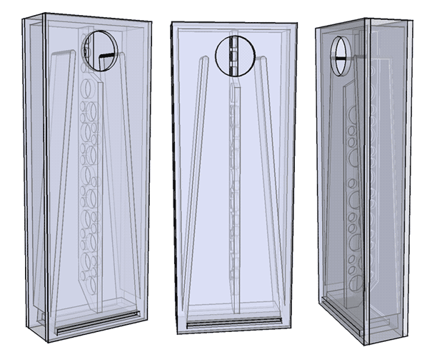

One of the things I love about the BIB is that the basic concept is so simple it lends itself to modifications and tweaks. There's been a few suggestions of late -here's a couple more simply based on altering the flare-rate away from the linear expansion. I've had a very quick & rough look at them in the TL Sections sheet, without attempting to optimise anything, and they do indeed cause some changes to the response. The first if shaped 'correctly' gives almost a parabolic flare / expansion for the 2nd half of the line, the latter closer to conical. Thought I'd post them here in case they're of interest to anyone.
Well, Jeff doubled the front panels on his, but he didn't cut it in two. Are you thinking of the top diagram on the 'How to' page? That's not cut in two -just a lighter shade was used around the driver.
Depends what materials / driver / cabinet combination as to the effect. Derek didn't have a router either (nor do I come to think of it), so it's a bit of a pain, but should be worth the effort. The more you put in at this stage, the better they should end up being.
I was referring to the lower, new, transparent diagram with the oval front baffle. It looks as if the ply front to the speaker has a section cut out (with a 45 degree shamfer) to allow more space behind the driver?
I was just concerned that the drivers will be suffocated by placing them in a wooden tube that fills all the driver depth up to the magnet.
Ah, I see what you mean. I hadn't noticed Dave had done that before in that render. No, I wouldn't chop the front in half, but you could cut a square out of it if you felt so inclined, and chamfer the edges to smooth them. Then there'd only be the suprabaffle thickness for you to worry about.

In this close-up of the Bruce visulaization you can see how the inner layer of the baffle is opened up -- that is how i approach this problem. (note: the visualization does not show the 45 degree angle that we would relieve the back of the circular opening with -- if you don't have a router, a big rasp will also do the job.

Martin Prothero said:Surely when I place my drivers in an inch thick supra baffle, the combined thickness of 1 and 3/4 inches will completely cover the driver, affectively putting it into a 155mm dia pipe?

Scottmoose said:Ah, I see what you mean. I hadn't noticed Dave had done that before in that render. No, I wouldn't chop the front in half, but you could cut a square out of it if you felt so inclined, and chamfer the edges to smooth them. Then there'd only be the suprabaffle thickness for you to worry about. /QUOTE]
At the time i drew it as 2 baffle sections... in practice, i'd do it like the Bruce visualization above. If the driver cut-out does get out wide enuff with respect to the width of the front of the speaker, a rectangular cutout might leave little enuff at the sides that it effectively becomes 2 pieces to the front baffle.
Also not shown in these visulaizations is that in practise i would have a holey brace from the back of the driver to the internal partition and then a brace on the other side of the partition that carries the load to the back panel (or as in the visualization of Mileva attached to the back of the cab -- Mileva could almost be described as an ML-BIB instead of an ML-Voigt)

Thanks for that Dave. Looking at the pic, it seems that I can cut a square in the speaker fronts and then angle the inside edge of the suprabaffle. But this doesn'y leave a lot of material to screw the suprabaffles to. Most of it cut away when making the square cut out.
Maybe I should glue the suprabaffle on and keep the fronts of the speakers just fixed with screws until I am happy with the tuning?
