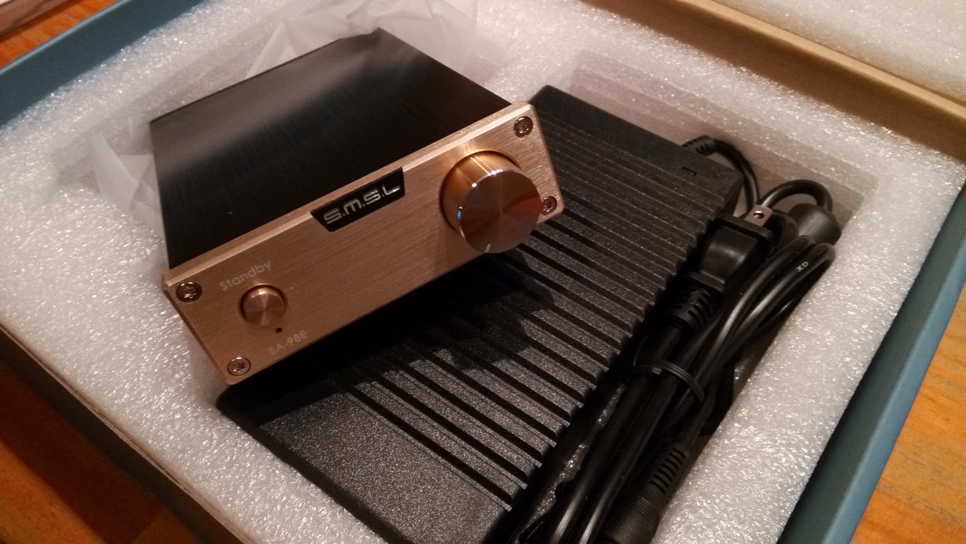

Got the new toy from the mail today.
This is the TDA7498E, rated up to 160W per channel, shipped with a 36V power brick.

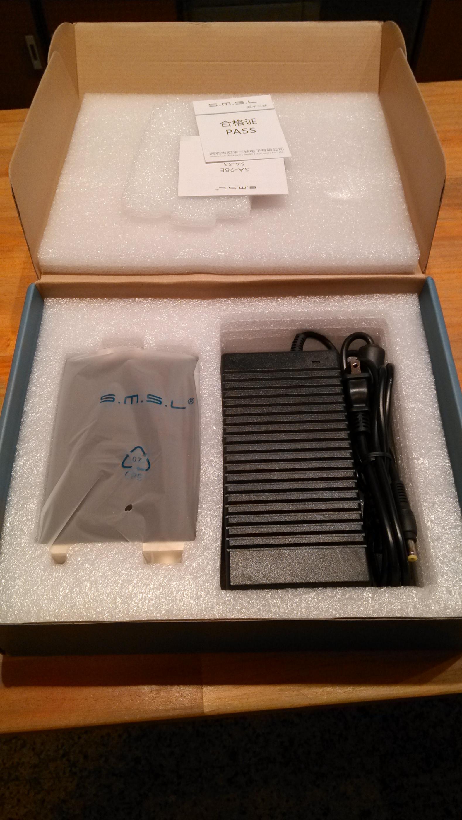

First impressions:
- I was impressed with the packaging. It came in a sealed plastic bag, wrapped in 3 layers of bubble wrap, in a cardboard box, with the foam inserts inside like in the pictures.
- Took out the parts, the amp and the "brick". True, the power brick is quite large. Rated at 36V.
- The amp looked very nice at first, but the volume button is just cheap plastic that rubs inside, creating some friction sound, and feels pretty crappy.
- The brick seemed DOA as it wouldn't power up the amp. The LED on the brick turned on, but the amp didn't.
- I took out my 19V power and plugged it in, the amp fired up. One thing that will need some getting used to:
When idle, the amp's LED is green. When turned on, the lamp LED is red!
Also, the power is on when the button is pressed out, and off/idle when the power button is pressed in. Maybe they wired the switch inverted!
- I only tested it with my sub and it worked ok. Didn't have time to test with my TABAQs yet.
- the power brick problem seem to be coming from the end connector. It looks to be too big for the amp's input connector. I used a multimeter and I was able to get 36V, but the amp can't seem to see it. I think I will need to cut it off and use a smaller one, something like the smaller one on my 19V power brick, which works fine.
Too bad about all the issues. The knob looks like aluminum plated plastic at least - typical volume knob but the rub makes it feel cheap since not butter smooth. The button does say standby, so green is standby. That is lame that the connector on the 36v brick is not compatible. What amp rating does brick have?

Yes, it's official... my power brick is DOA. It's not just the connector. I can't get any juice anymore.
I've contacted the seller, we'll see how it goes.
Until I get news, I won't attempt to open up the brick... in case of warranty issues.
