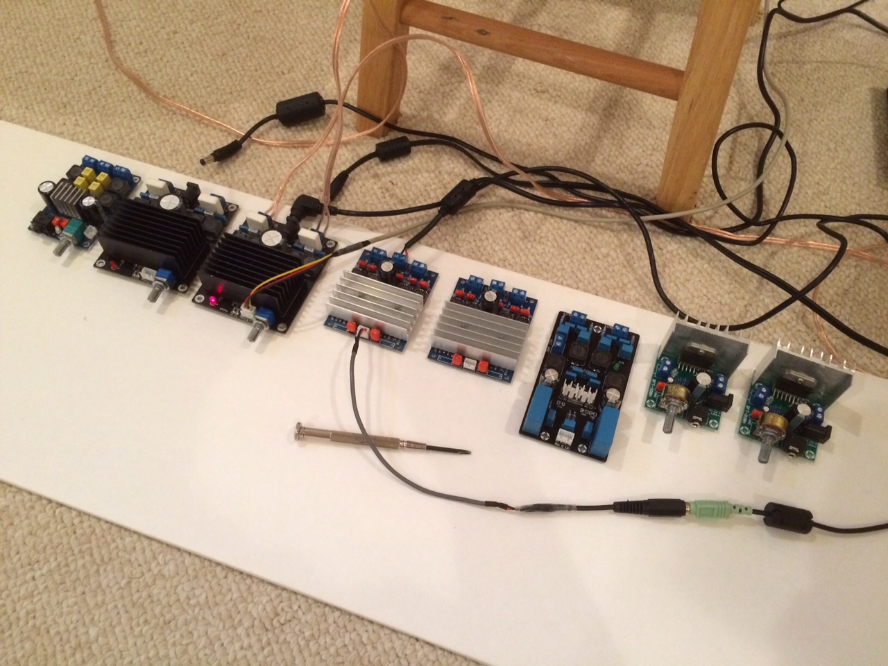

Fun with Cheap Amps
I finally had time to test all the recent cheap amps that have arrived from Aliexpress and Amazon. I set up my 0.53x Karlsonator speakers fitted with Dayton 5in PA120-8 pro audio full range drivers. I found several power supplies for all the different amps: 12v, 19v, 24v, and made a 3-pin header to 3.5mm stereo jack. Set them all up side by side and listened to them one after another.
Amps included:
qnty 2 x TDA7498 (black heatsinks)
qnty 1 x fake YJ blueblack (Danzz) TPA3116D2
qnty 1 x SMAKN TPA3116D2
qnty 2 x 'lunch money' TDA7297 class AB

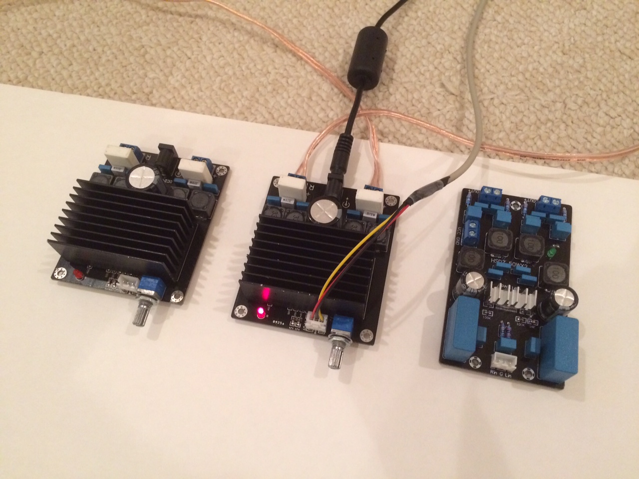

Here are TDA7498's and fake YJ blueblack:
Here is the whole lot with SMAKN currently under test (note assortment of power leads and audio input leads):
First thing I noticed was the amazing stereo phantom image I can get from full range drivers. No XO to muck with the phase so sound stage is very clearly defined.
Main purpose was to test overall sound and whether or not they are DOA.
They all sound very nice, with the cheap TDA7498's of course, being able to pack a real punch. The bad thing with the 7498's is that the speaker polarity is mis-labeled. If you connect as shown (R) -/+ and (L) -/+ you immediately hear that wierd phasiness. I swapped the (R) to +/- and immediately it improved and sounded normal. I also took a frequency spectrum to make sure bass wasn't cancelling and it's all good.
The SMAKN sounded really nice - musical and clear. The extra gain required turning the volume down.
The fake YJ blueblack was actually also decent sounding - did not detect any issues like Lo Tse had with his not sounding good.
The little $5 TDA7297's were surprisingly clear sounding, not as loud but for their range, quite formidable. I would almost want to try these to power the tweeters for my next project.
Good fun testing. The neat thing about using a full range speaker is that the step response and impulse response are magical. Drum solos have great realism due to timing accuracy.

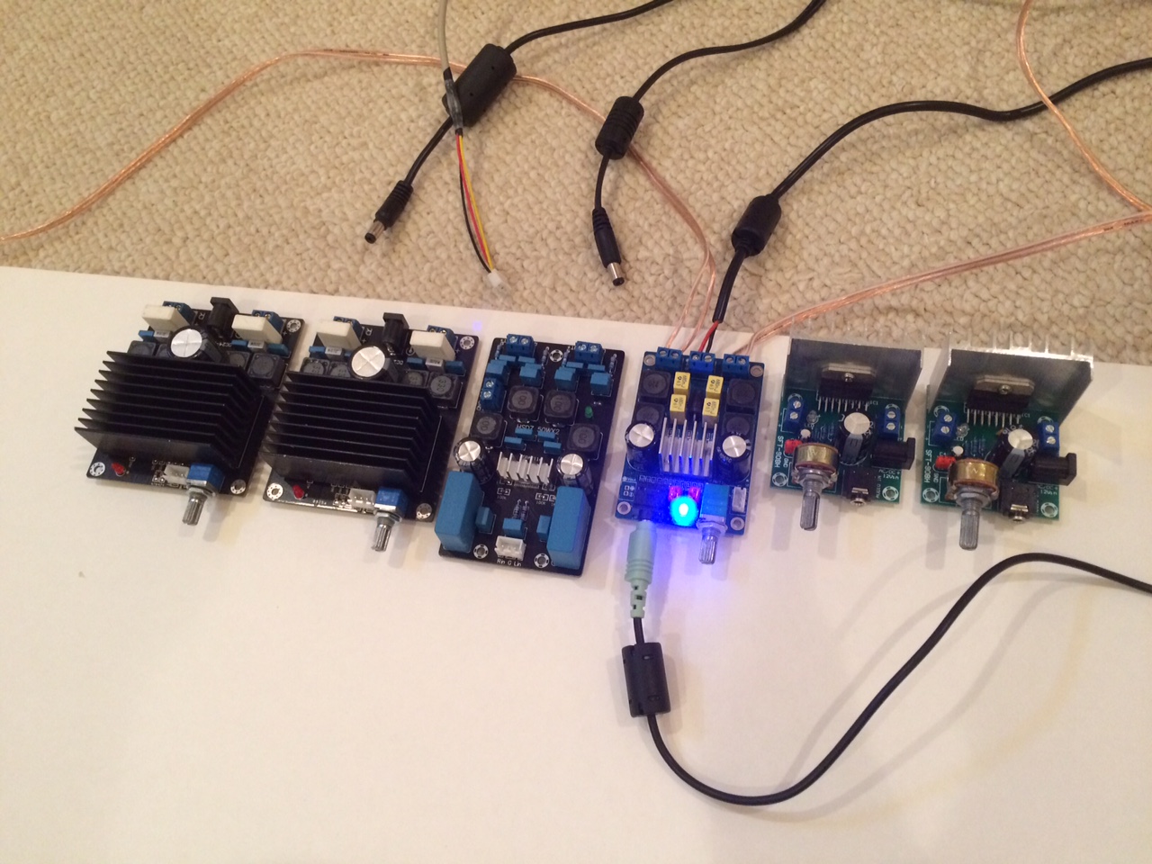

xrk, how do you like the black 7498 compared to the cheap blue 7492?
I am comparing the sound quality between the two as I type. Based on 4 sound tracks so far, both un-modified stock 7492 (second batch with orange drop caps) and 7498 (black heat sink with pot, LED, mislabeled Right speaker out), running 19v supply on both, I have to give it to the 7498. Quite a bit more ease of HF presentation and bass has more weight. It just seems easier sounding, and I think is quite a nice amp in SQ and build quality for $11ea. I was not happy with the bad packaging though - just plastic wrap on the amp and placed in plastic mail bag, two amps bumped and scratched each other in transport so heat sinks are all dinged up. Other amps came in foam and bubble wrap and some, like 7297, a box even. Packaging notwithstanding, they sound very nice.

I am comparing the sound quality between the two as I type......
that's my impression, too.
if somebody searches for a cheap amp to power 8ohm speakers, the black 7498 would be my advice atm.

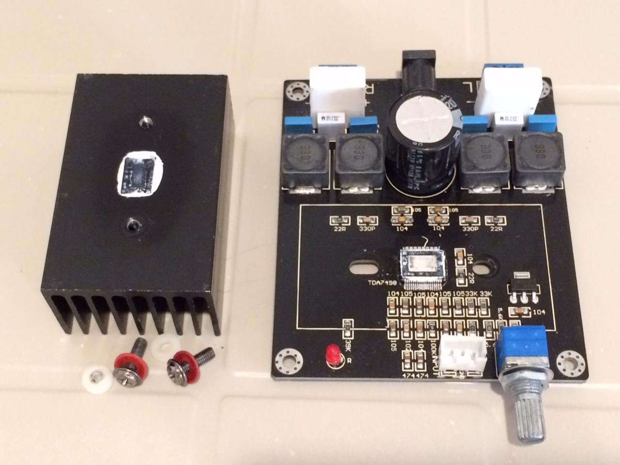

The heat sink comes off the TDA7498
I just got a good tip from Timpert on another thread to watch out for improperly used components on class D amps (especially the 7498 as an example) from Trevor Marshall - http://www.trevormarshall.com/class-d-tutorial/. In the article by Marshall, he showed how a single improperly used x7r resistor on the output snubber (post LC) of a Sure TDA7498 caused the HD to hit 2-34% since the caps are not designed to handle high currents. swapping that single part to an MKP drop HD by 10x! Anyhow, that got me curious so I popped the bonnet open on this engine to see what is under the hood.
What I see so far looks pretty good, and we can see that this board is anonymous (no Feixiang label) and uses metalized film caps for output filters. There is even a 5watt sand filled high power 2.2ohm resistor on the output snubber. The heatsink is mounted properly with isolation washers and grommets and uses real heatsink compound.
