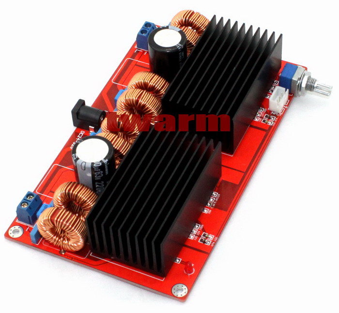

look at this.
a tda7498 mono board popped up.
i wonder if it is 7498E.
Versandkostenfrei tda7498 150w*1 class d verstrker brett mit hoher endstufe bord wollen gute Qualitt, bitte whlen Sie uns in Tda7498 150w*1 class d verstrker brett mit hoher endstufe bord wollen gute Qualitt, bitte whlen Sie uns aus Verstrk

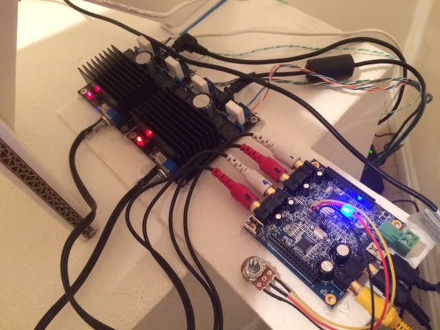

TDA7498 works well with miniDSP
This setup works really well with my 3-way synergy and bass horn reference speaker. The bass/sub is dual channel so I use all 4 amp channels.
$11 on Aliexpress:
http://www.aliexpress.com/item/TDA7...369235748.html?spm=2114.32010308.4.132.0172up
Just ordered 2 more...

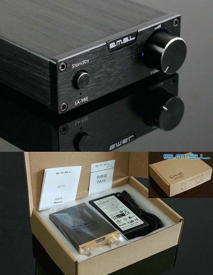

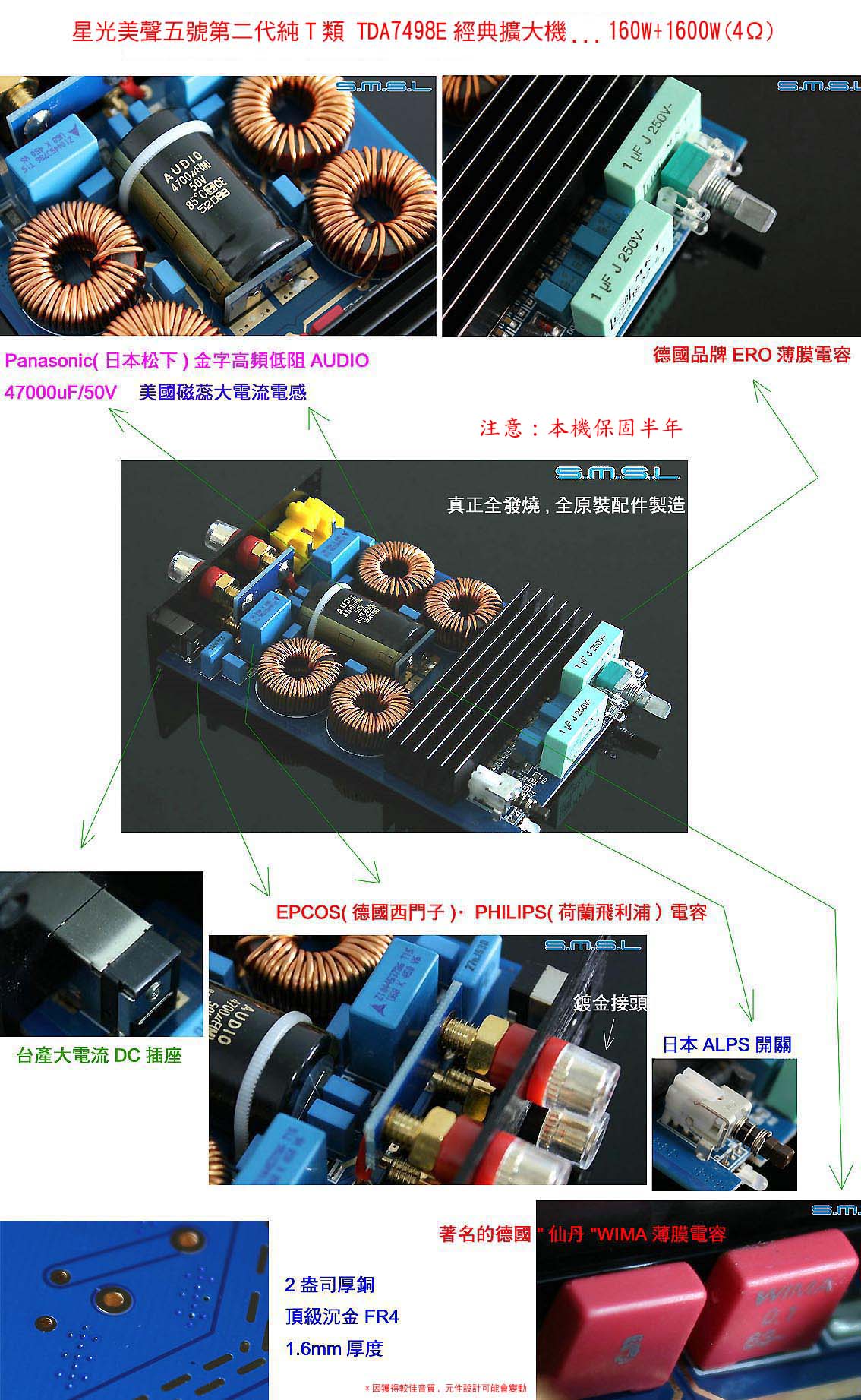

I found a TDA7492E amp, with enclosure, and 32V power for about $87.
It's rated at 160W + 160W.
Looks good!
Nice find! SMSL makes nice finished amps so I think this one is probably a winner. Looks like the 7292E is rated even higher power.
