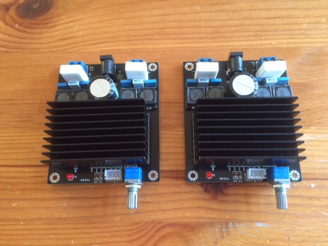

2nd set of 7498's
My second set of TDA7498's from Aliexpress arrived today. This time, they were impeccably packed in shrink plastic, then multiple layers of foam, then taped, then neatly fitted inside a cardboard box. All for $22/pair shipping included.
I realized that the goods are cheap and shipping is included, but how much more would it cost to wrap the items in bubble wrap individually before shipping? As a customer, I do not mind pay a bit more to ensure the package is properly packed. The customers will be a lot happier when the order arrived in good shape and likely would buy again. Really do not understand their mentality.

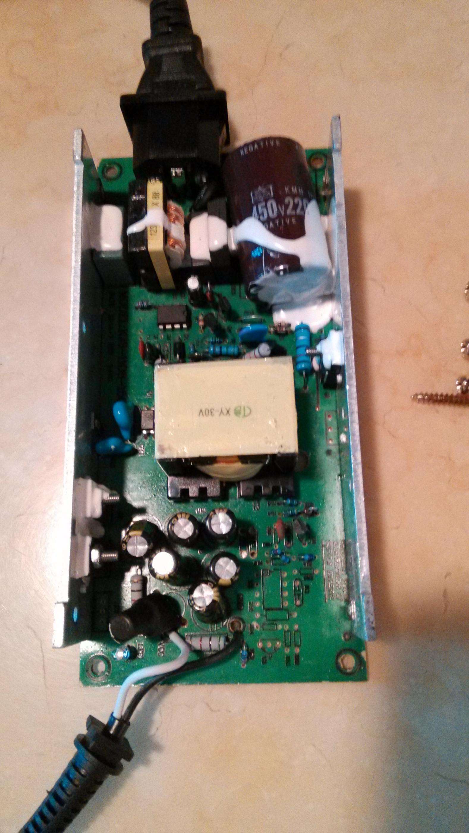

Good and not so good news ...
Still haven't received my new power brick, but since i am getting it replaced and didn't need to send it back, I opened it.

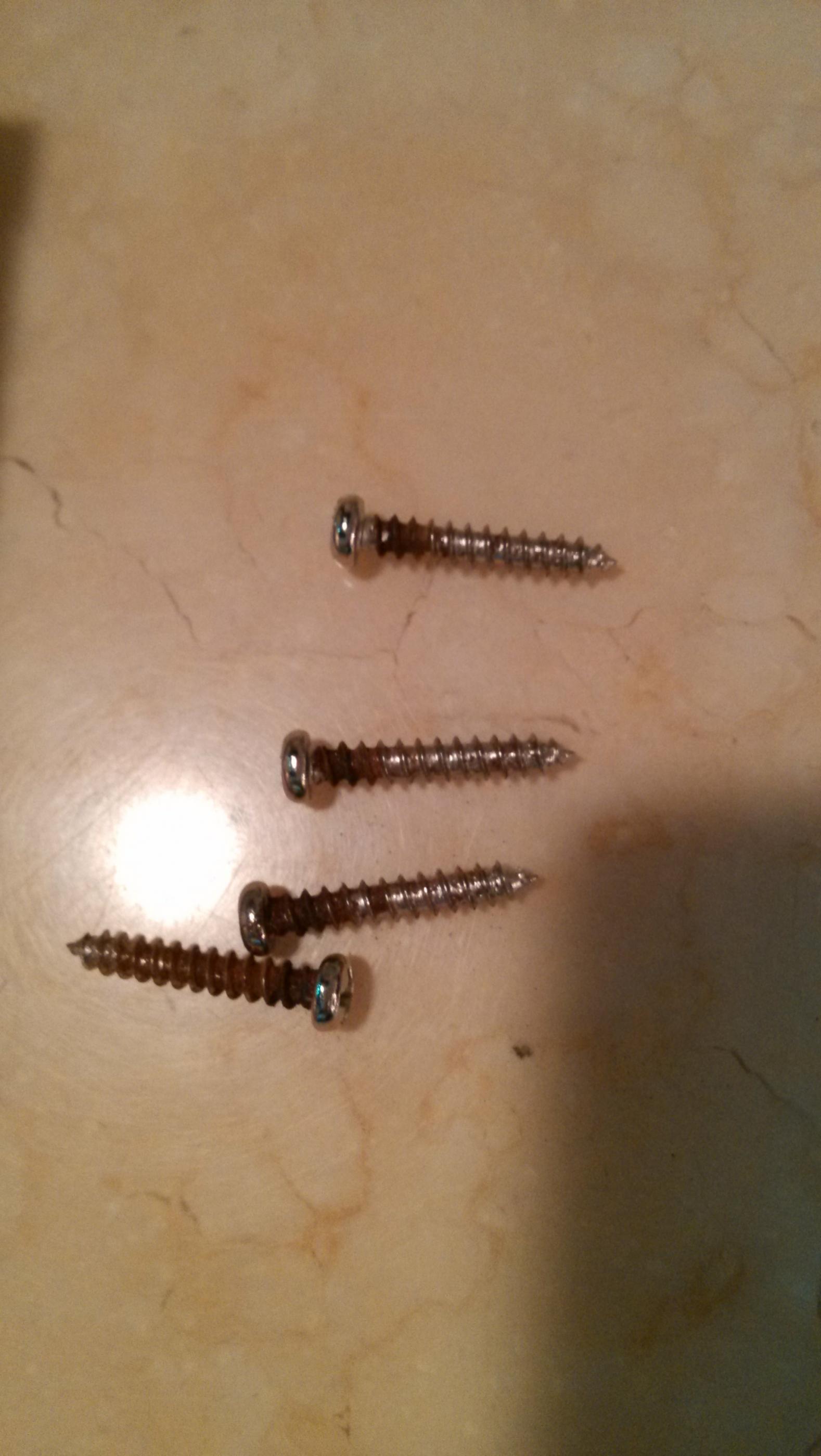

Bad: The screws holding the box together were all rusty. There is a pool of goo holding stuff together on the board.
Good: I placed the multimeter on the outputs directly on the board, and measured 36V. So the board seems to work fine, but there's a problem with the cable.

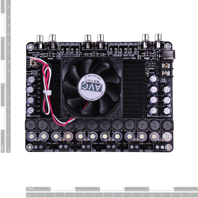

This thing might be interesting if I wanted a 5.1 surround system for computer games (but I don't play) or movie watching in a small room on computer screen.
A TDA7498, 6x100w.
Specs from the site...
