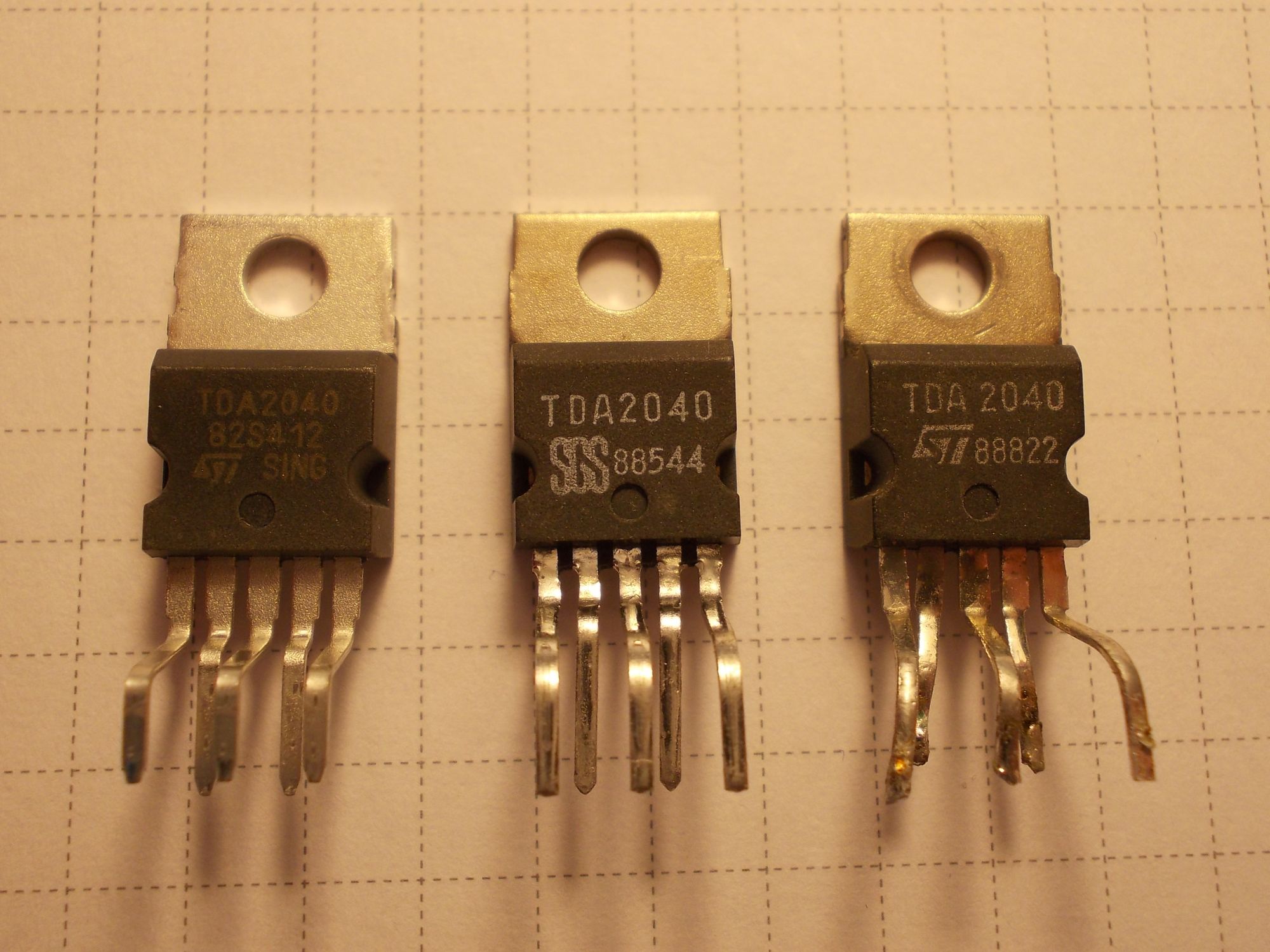

Why do you want to buy TDA 2030? In fact TDA 2040 is practically complete analog.

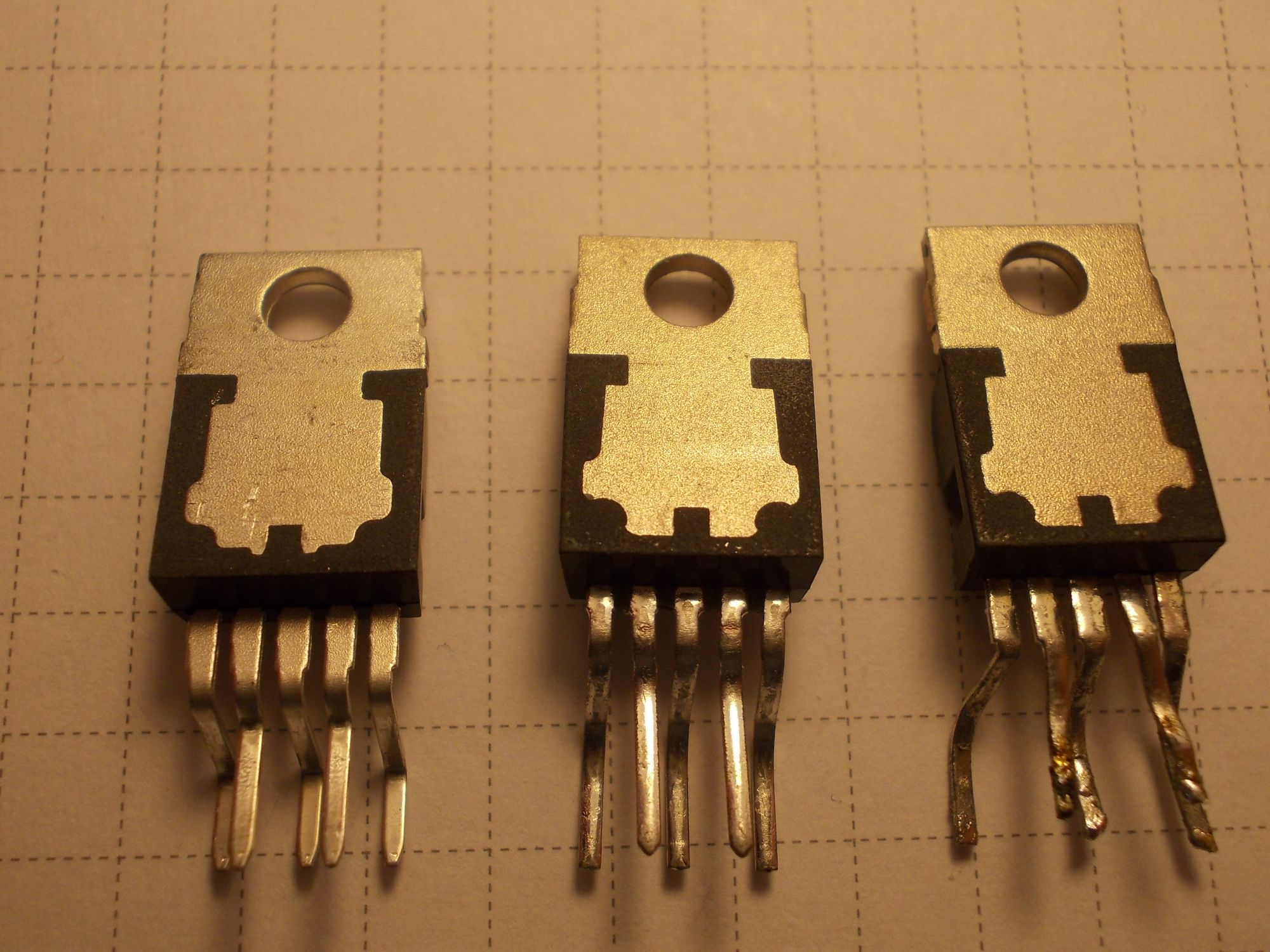

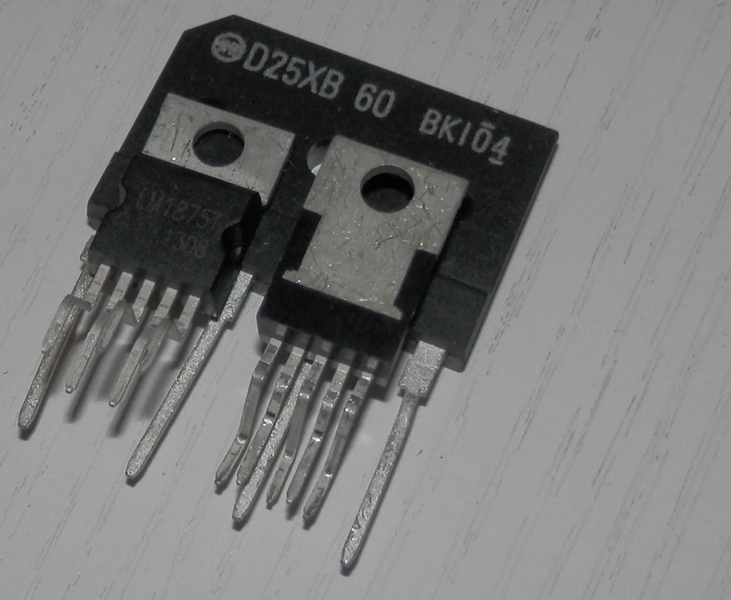

I have got only these fake chips. LM1875, TDA2030/50, all of them are are absolutely identical with the exeption of label. But even fake TDA2030 works quite well.

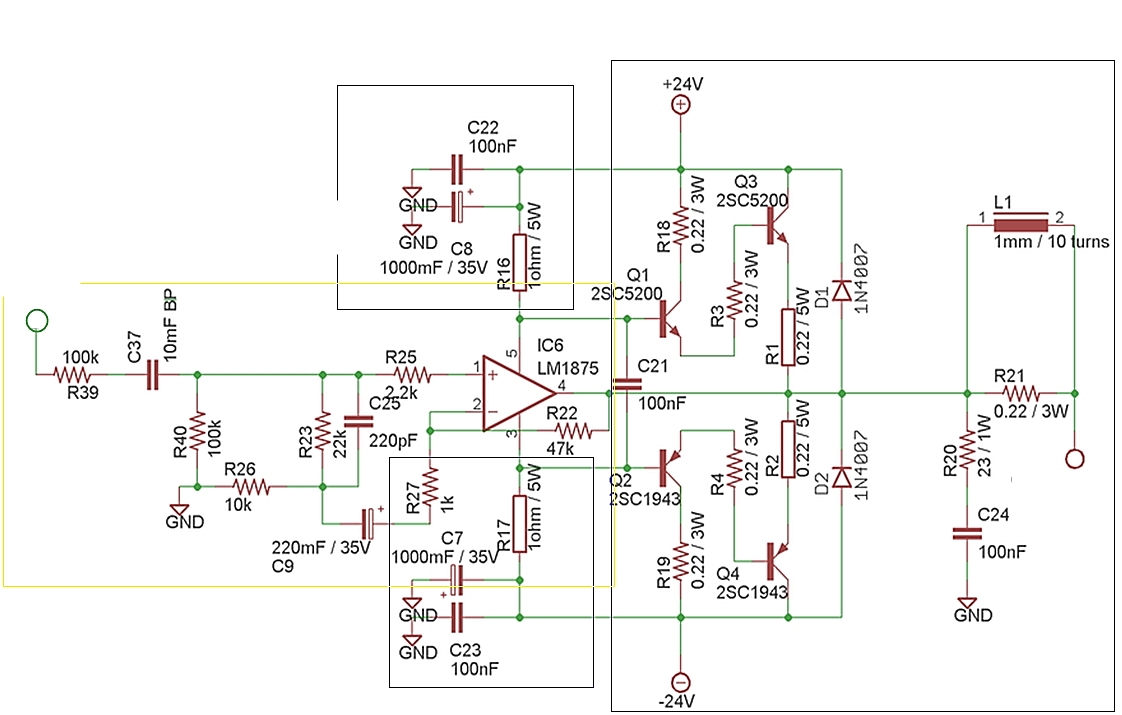

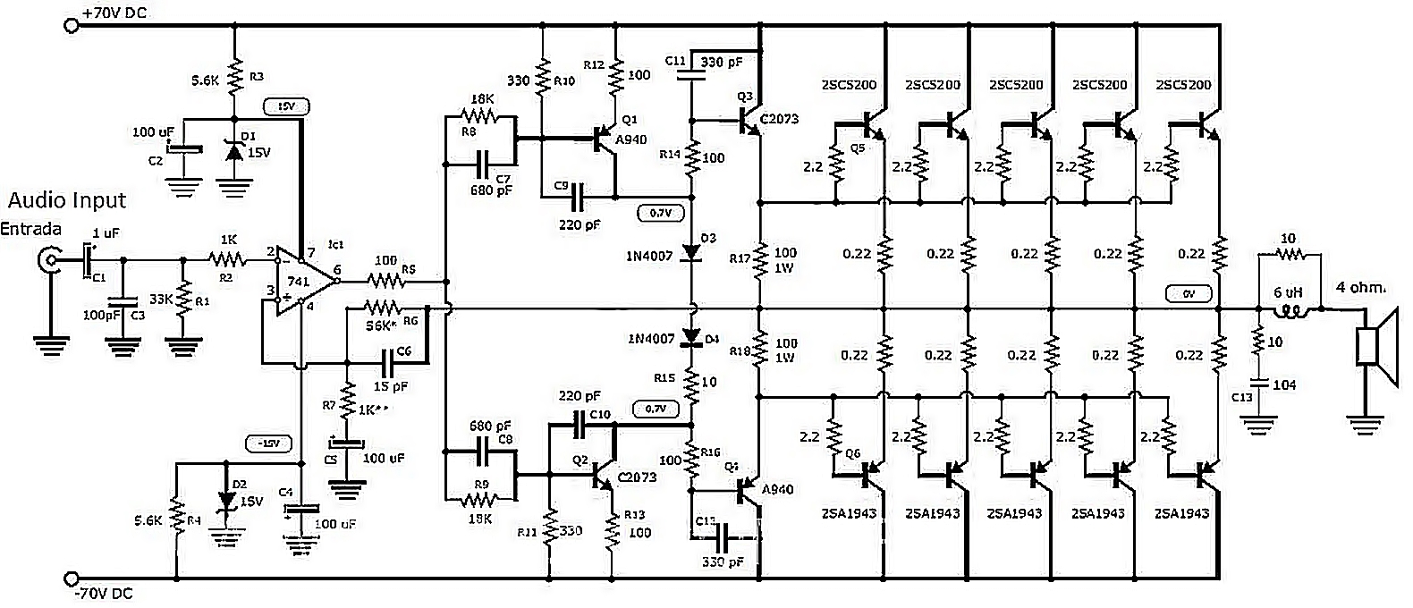

Hi people,
I'd like to try a chipamp with output transistors circuit, but I'm a total newbie and need help.
I've built several chipamps with the LM1875 and the TDA7293 until now, but I always just copied schematics from the net and made eventually some little variations where I knew it was safe.
I have surfed the net for examples and sure found some circuits which are pretty similar to the one I'd like to built.
At the moment I have got a Mivoc AW 3000 in a 45l sealed box, driven by two paralleld TDA7293 as subwoofer and I've got a kit for three TDA's lying around. I've done the optimizations for better bass reproduction which can be found here on the board and everywhere else in the net and I am totally satisfied with the result ... but, I would like to try a LM1875 with transistors anyway.
I've got a few LM1875 (which was my 1st love as a chipamp) to play around with, and I've got the complete output stage of a Rotel RA-06 + the original transformer. So I'd like to use these in combination with a LM1875 and I hope, I can use the original toroid with +/-48V DC for the transistors, which are four 2SB817, four 2SD1047 and a pair of 2SA1837/ 2SC4793 as drivers (don't know if they're needed).

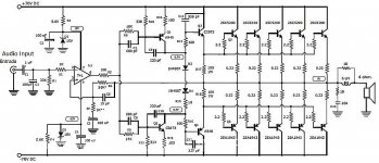

I found the attached circuits on the net, what must I change, to make, for example, the one with the LM1875 fitting with my parts?
best regards
Jochen
The first circuit doesnt need a power op amp on the front - it is quite happy with a regular 5532, LF353, or even 318 (as in the original that it was copied from). On 48 volt rails your transistor complement would be fine. The second circuit has the wrong polarity fitted - needs PNP's in the top, with collector to output. And it does not benefit from darlington connection. You would be better off paralleling, but that is at diminishing return on any voltage that an 1875 would survive.
Hey, thanks for your answers! But, don't think so much about the schematics on the pictures, they only should be examples for the direction I'd like to go. Could you give me some hints what I can do with the parts I've got. How can I use different voltages for the LM1875 and the transistors? I've got toroids for both (+/-28V and +/-48V). As transistors, I've got the four 2SB817/ 2SD1047 or if that would be a better option two pairs of 2SA1943 and 2SC5200. If drivers would be needed, I got 2SA1837/ 2SC4793 or TIP41C/ TIP42C.
I'm not in a hurry, because I'm also working on satellite speakers which will be a lot of work. But when evening comes and I must stop making so much noise, I'd like to solder and try things out a little. I'm thankful for every help.
best regards
Jochen[COLOR=inherit !important]

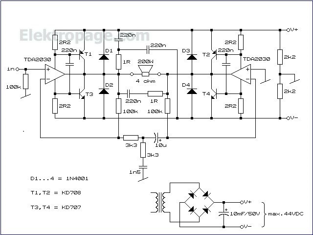

TDA2030 Audio Amplifier 1 x40W ~ AmplifierCircuits.com

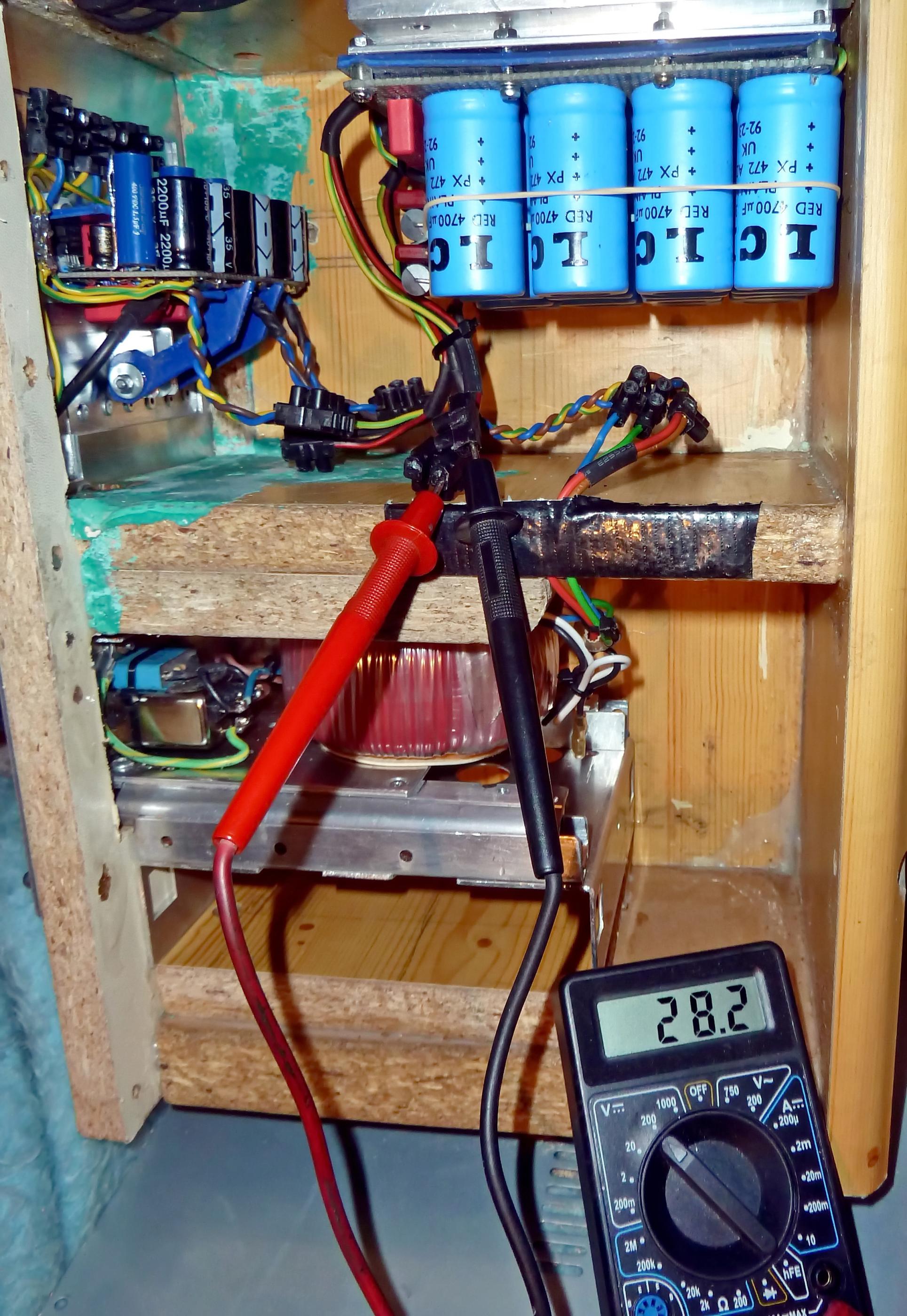

Measuring with a multimeter on the AC side of the bridge rectifier I am measuring 21.6Vac and on the 4700uf smoothing cap I am measuring 28.9Vdc.
Using the formula Vdc = Vac x 1.414 to calculate DC RMS voltage of the bridge rectifier you would expect 30.5Vdc but you also need to subtract the voltage drop of the bridge rectifier diodes 0.7v x 2 = 1.4V. You would then expect to get 29.1Vdc which is almost what I am measuring with the multimeter.
The absolute maximum for the TDA2030 is 36V and all the parameters on the datasheet are measured at +-14v or 28v so I think it is the safe operating margins for the chip.
As I mentioned my amps have been running for almost a year now without any problems with these PSU voltages.

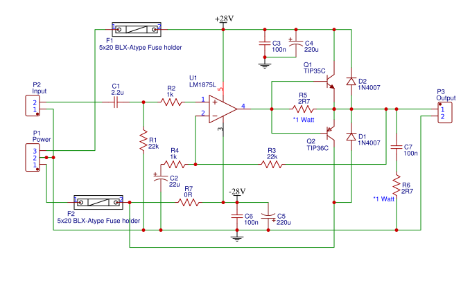

Yes Agreed, in fact, Rod Elliot at Elliott Sound Products has written a really nice technical article on designs using Power Op-Amps + Booster Transistors. He explains using the split rail power supply as you suggested. See link below.
IC Power Amps
He also mentions in the article that the amplifiers distortion increases but I have to admit that I do not hear or notice this. I also do not have any test gear so are unable to confirm.
I have already done a quick split rail design using the LM1875 chip that can use a higher supply voltage and has better distortion figures than the TDA2030. Calculations indicate it could drive up to 90W into 4ohms. Have not had any time to build and test it though.
