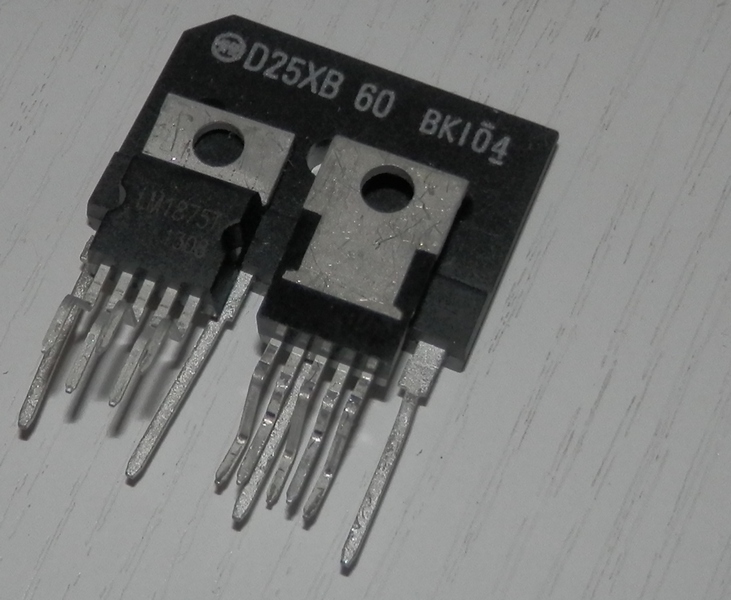

I thinkp robably nothing new can be invented with TDA2030. Everything has already invented. And it's easier to assemble a simple and reliable transistor amplifier instead of torture with fake chips.
For example, this is on sale under the guise of LM1875 where I live.

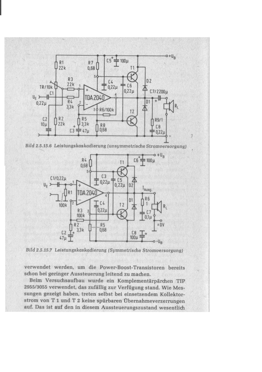

i was curious about that schematic (post1) and built a prototype with old spareparts .
15V single supply psu , tda2040, res 1ohm in the supply lines, bd243c/bd244c as booster transistors.........now it has worked for a week without problems.
......yes,only 15Vdc, because i used what i had on hand.
made a sim - at 4Vpp output with a 4ohm load(res) the transistors begin to conduct...
the sound quality was good, so i decided to go on......
now i have a psu with 28Vdc and listen to it.
if it works i will change resistors ( lower values) and booster transistors (switching types ,higher currents), because i saw a schematic in an old book for "electronic practice" where 0,68ohms and tip2955/tip3055 are used.
perhaps i will buy some bd9xx transistors.......
........so it worked with the 28Vdc supply (25VA transformer, 20Vac ; 8A bridge rectifier, 6800uF elcap) without problems.
with a 4 ohm load the psu volts go down to 24,5Vdc and the amp begins clipping (distorting) at 20Vpp output........
there are no crossover distortions on the o'scope or in the sim to see.........
i think the next step is to decrease the 1 ohm resistors to 0,47ohms (0,5ohm) -
this should give less losses and a better damping factor.

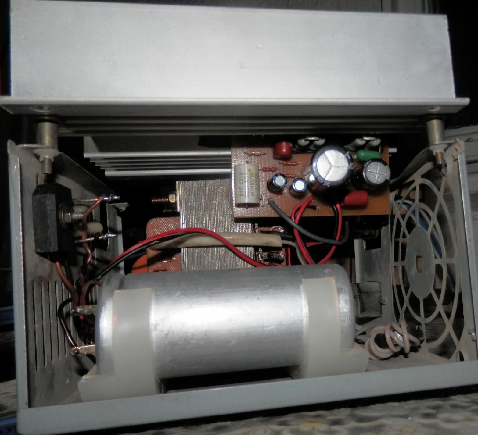

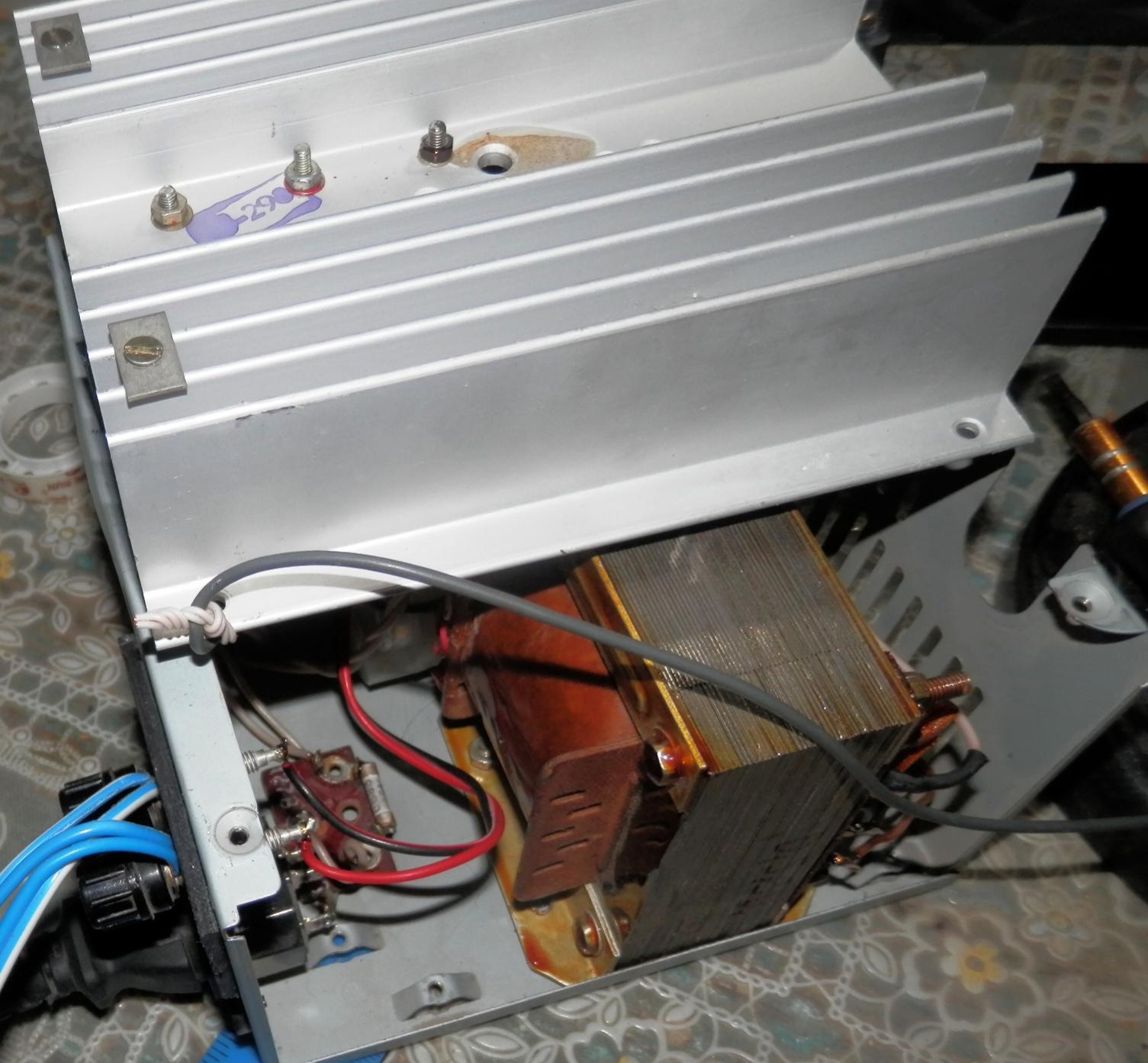

I've made this amplifier from the trash in order to hear whether this circuit sounds normal 🙂 It's temporary. Soon I'll solder the second channel and find a suitable case.
The sound surprisingly is pretty nice. I can hear all the intonations of the singer's voice. Electric guitars that I especially like sound great. No hum, noise etc. The sound power is quite enough for a small room.
I don't have any equipment to check those aluminium caps, but I think they are dead. Then I plug off the amp from the electric system the sound immediately disappears. They are very old and the worst caps in the world- legendary Soviet K50-6 series 😀 So huge and only 2200 uF, 50 V. I'll replace them then.
And I will also reduce the resistance of the resistors from 1.5 to 1.2-1.0. Let at low volume only TDA sounds.
Now my amp's Gv is 12. Should I increase it?

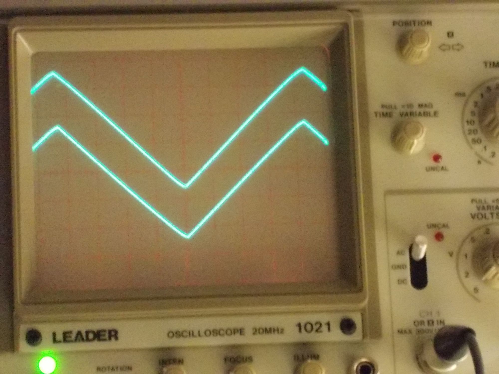

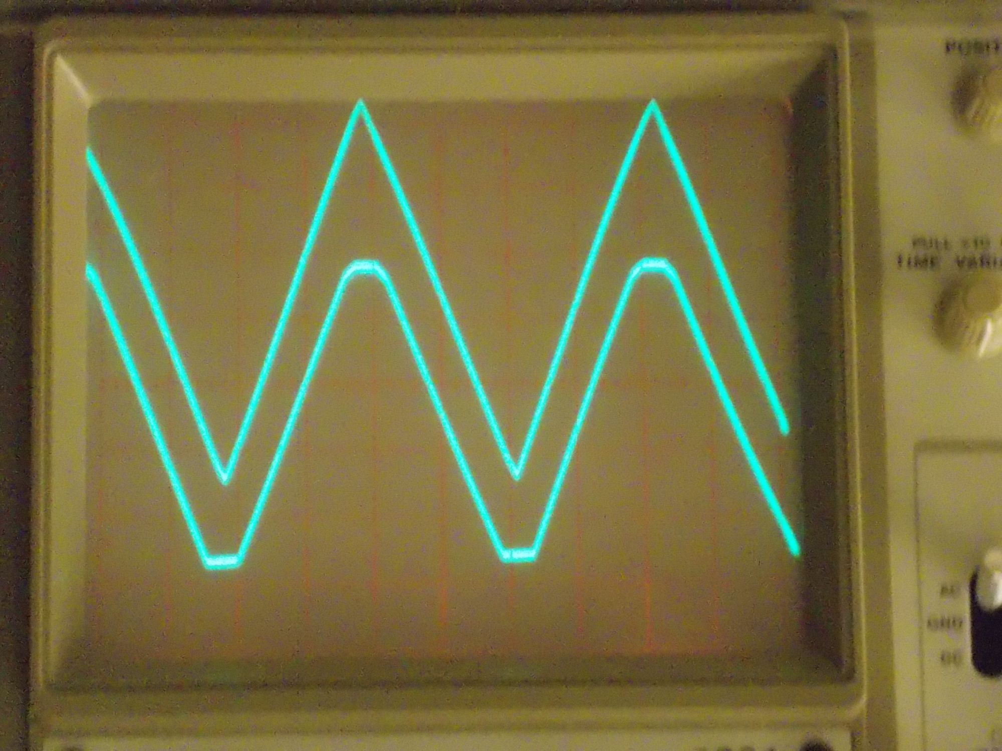

two blurry fotos with a triangle input signal (magnified ):
upper signal = input
lower curve = output (5V per div)
(the second foto shows the chipamp when driving into clipping)
