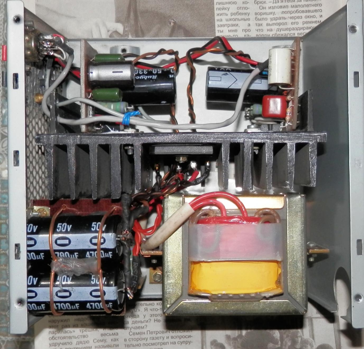

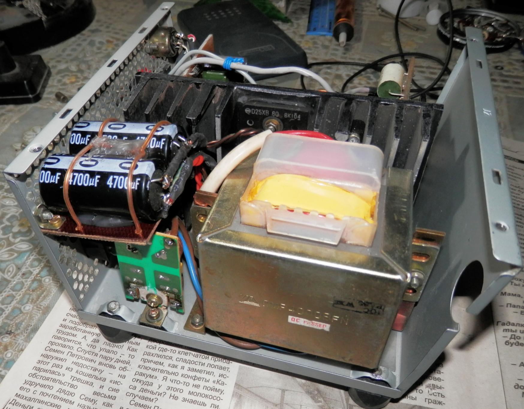

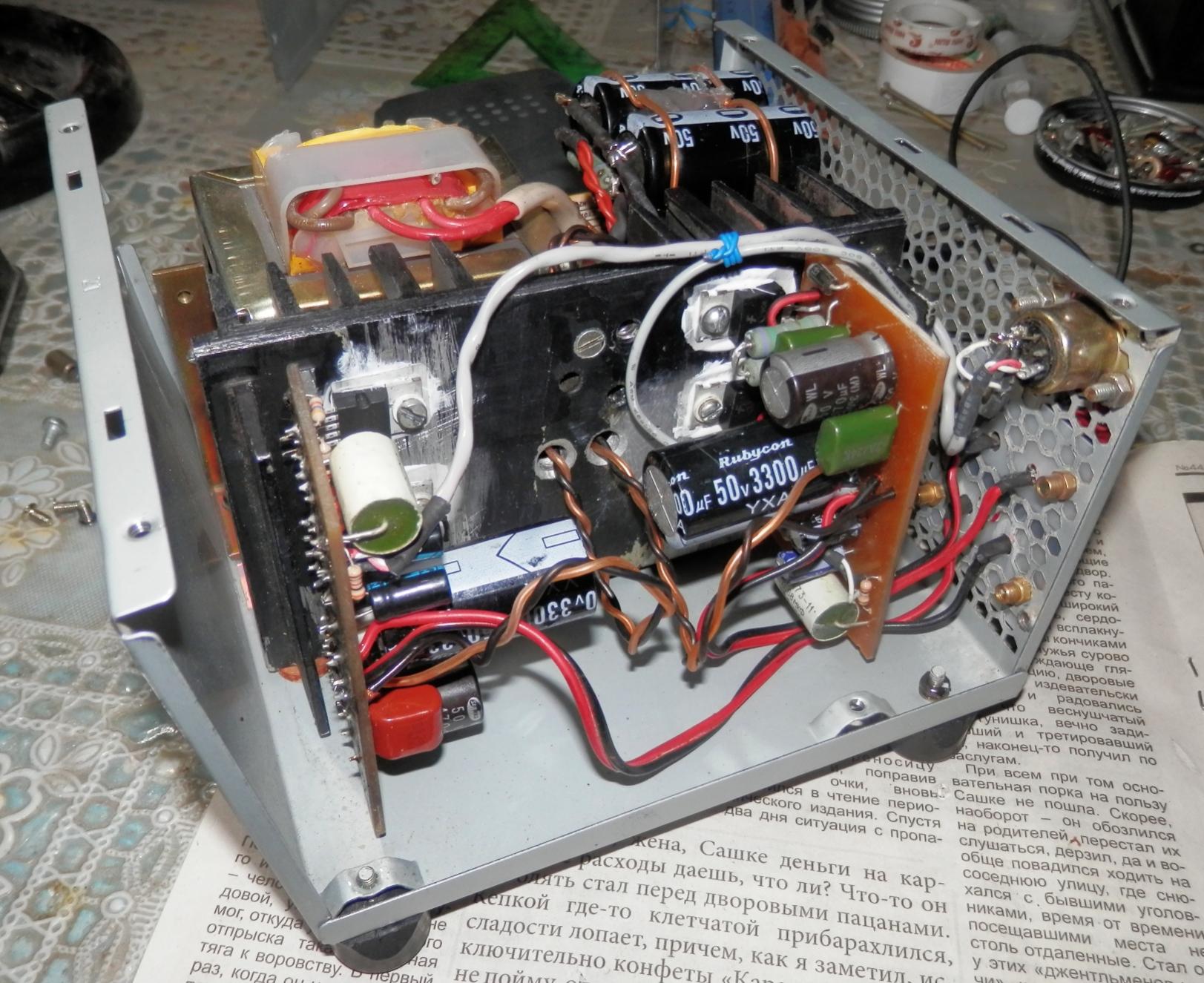

I've finaly made my amp. It happend I have different channels. There are KT 818/819 in one channel and TIP 41/42 in another one. But I hear no difference between them. And a heatsink is a little too small, although it is enough for home using.

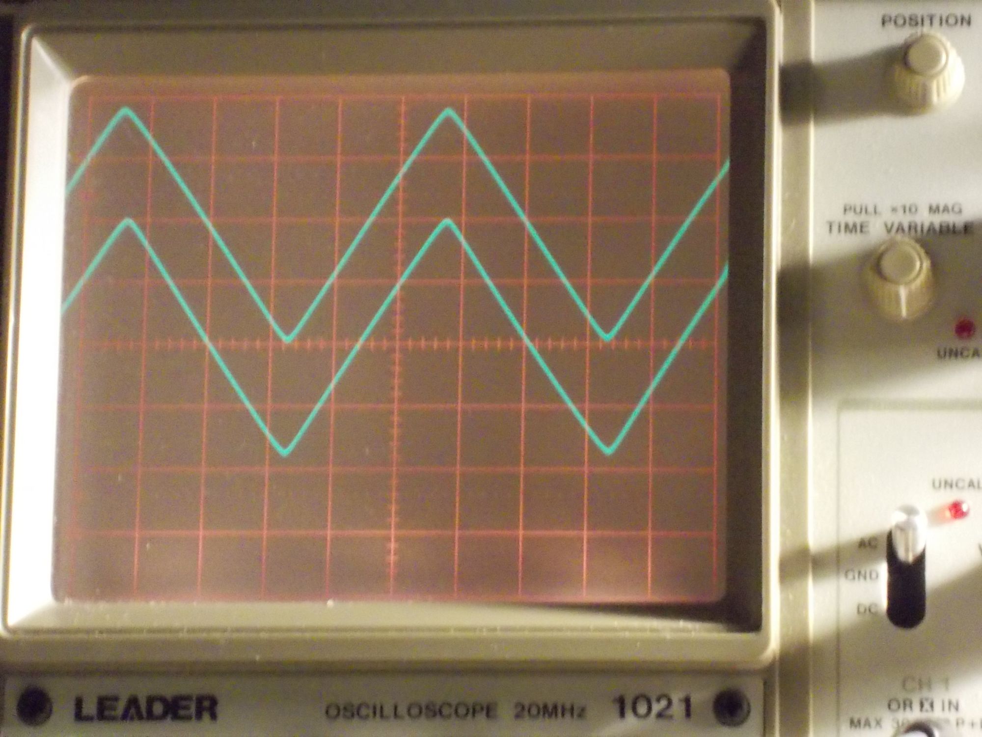

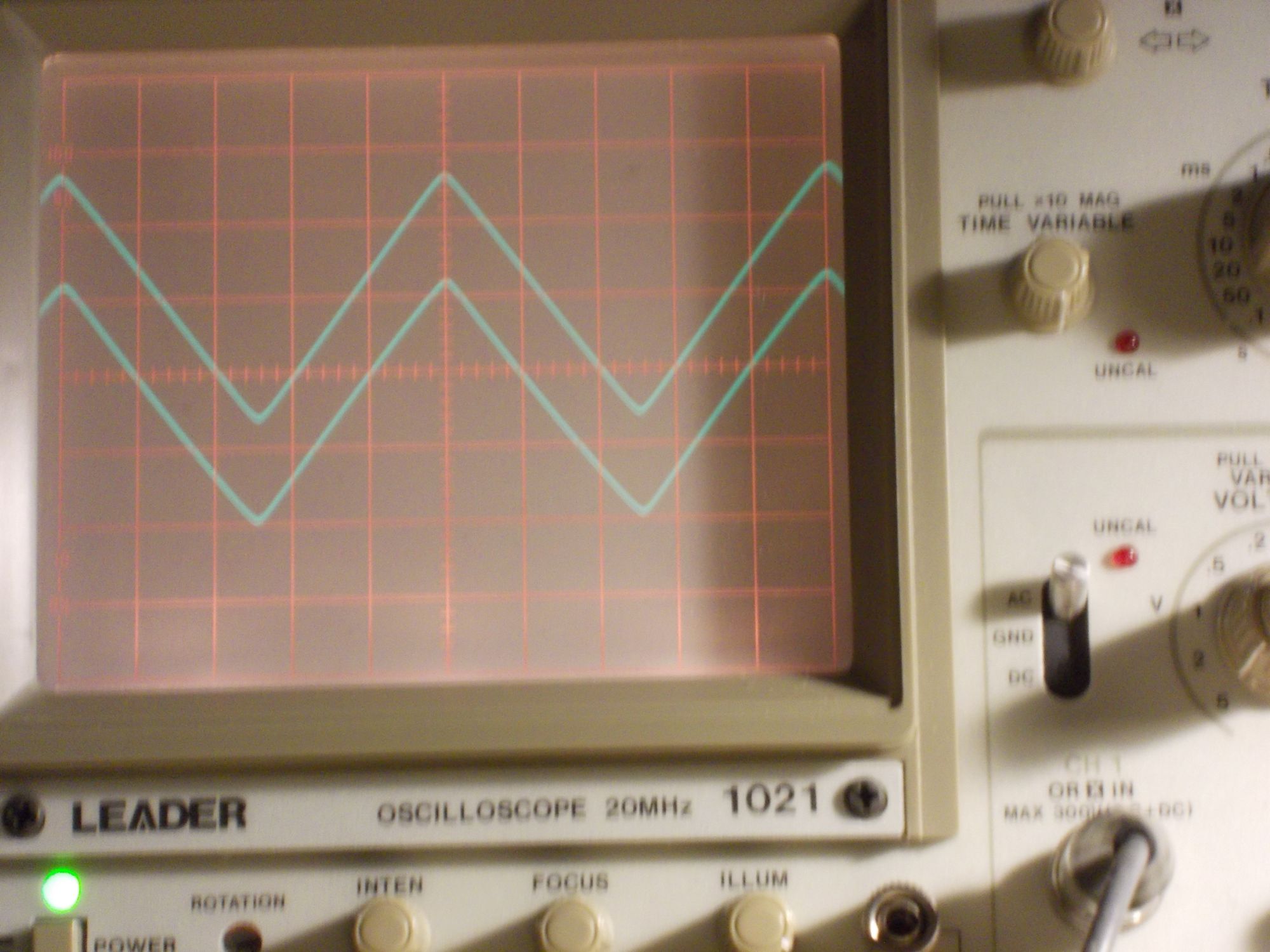

Very interesting. But saw form signal is not the most difficult signal for the amplifier. Try square signal.
mjf answer: a triangle is a "linear" signal, a straight line, so you can see deviations ("distortions") from it better on the screen ,e.g. a crossover distortion looks like a little shift in the mid of the signal.......

Saw (triangle actually) makes it very easy to spot nonlinearities....
Square makes it easy to spot "dirt" (oscillation) and transient behavior (slewing, rounding, spiking etc)

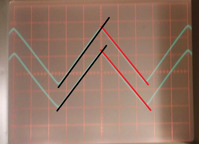

Am I imagining or is there a very slight kink in the curve where the boosters kick in (at 2.7R load) - which should be at around 3,5V. (IIRC you posted that you changed your sensing resistors to 0,5R and that would set the trigger current to somewhere at 1.2-1.4A, which would translate to cca. 3.5V into 2.7R).
That's kind of what I imagine I see tbh.
Try holding the edge of a piece of paper against each line. To me the lower trace has bowed edges. Very slight but visually detectable I think.
Could be CRT artefacts; but whatever it is it happens at around 3-something volts around the centerpoint, which would in turn suggest something happens at the booster-activation point.
I have seen worse.
I have seen worse.

mjf, can I see a photo of your PCB? I am interested to see how you made the GND track.

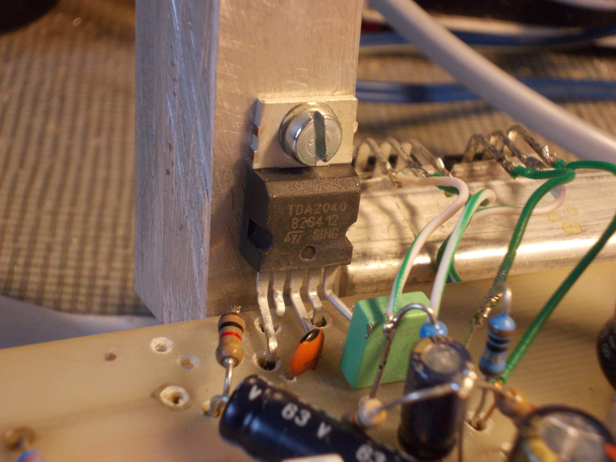

Do you use an genuine TDA2040? If I may, I would also like to see photos of its front and back.
it is only a prototype with an old pcb.........that means: a wire nest.
i will buy a tda2030a and other transistors soon.......
in short: the "- returns" are tied together in a single point.....and from this point a wire goes to the psu -
