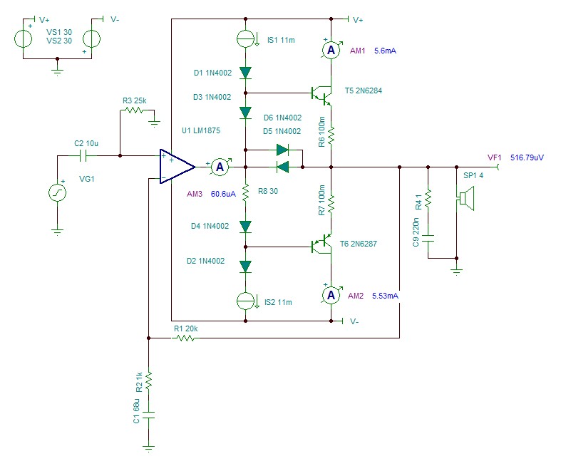

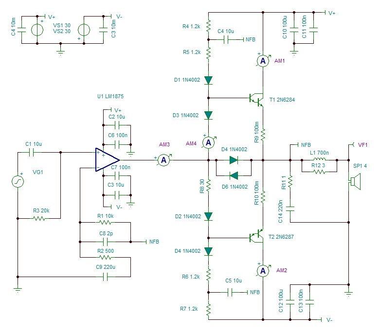

TDA2030 with transistors
Using simulation for proof of concept.
Lets build a circuit model that actually works.
Something that would actually drive 4 ohm loads
with 70 to 80 watts
Using a LM1875 that would never
dream of making so much power
Of course we can cheat a little with Ideal current sources.
But before you scream, its a simplified proof of concept.
With 11ma current sources, D1/D2 would make sure they behave
D3/D4 provide basic diode drops for bias.
D6/D5 for the first time actually
provide current limit/short circuit protection.
R8 is set here, but would be adjustable for bias current
The transistors are finally turned on with a rather wimpy 5.5 ma of current
Using Darlington Transistors
DC analysis Below

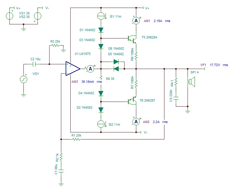

Looking at AC analysis
17.72 volts RMS into a 4 ohm load for 78.5 watts
The transistors now appear to be conducting current.
Around 2.2 amps of current.
Which is a significant improvement over the previous circuit
which was = 0
For a total of 4.4 amps AC
which makes sense since its 78 watts of power
attachment.php

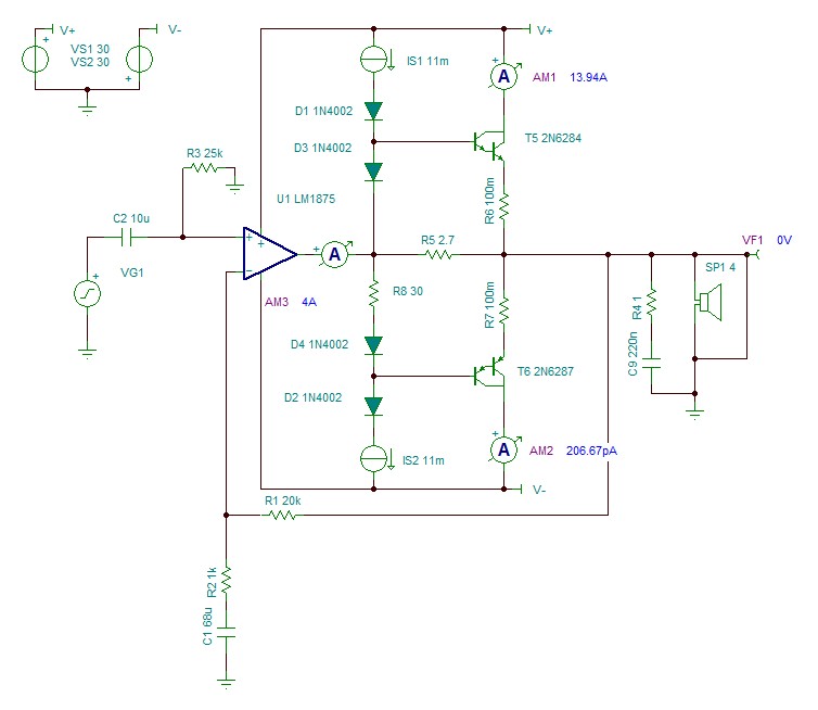

Lets remove diodes D5/D6 and add the 2.7 ohm resistor.
Then Short the amplifier.
As you can see the 1875 clamps to the usual 4 amps as designed
DC offset rises like any amplifier and the external transistor
Fully shorts to 14 amps.
Which would likely instantly destroy it...
attachment.php

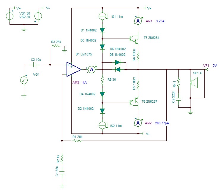

Now lets remove the pointless thing and replace them with
D5/D6 protection diodes
Now if you short the amp. LM1875 clamps to 4 amps as usual
and the external transistor also clamps to only 3 amps
attachment.php

R4 , R5 and C4 form basic bootstrap current source
in conjunction with R6, R7 and C5
obviously for clarity C4 and C5 connect to the amplifier output jumper
also marked as NFB for Negative FeedBack for the LM1875

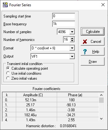

With 60 volt Rails, Driving into clipping
54 volts into 8 ohms
52 volts into 4 ohms
78 watts 4ohm clean power around 92 watts 3% distortion
17.7 volts RMS 8 ohms shows same distortion rating as the chip itself
.01 % distortion
attachment.php
attachment.php

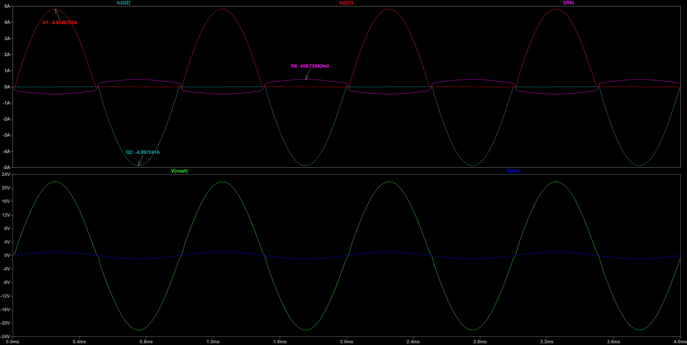

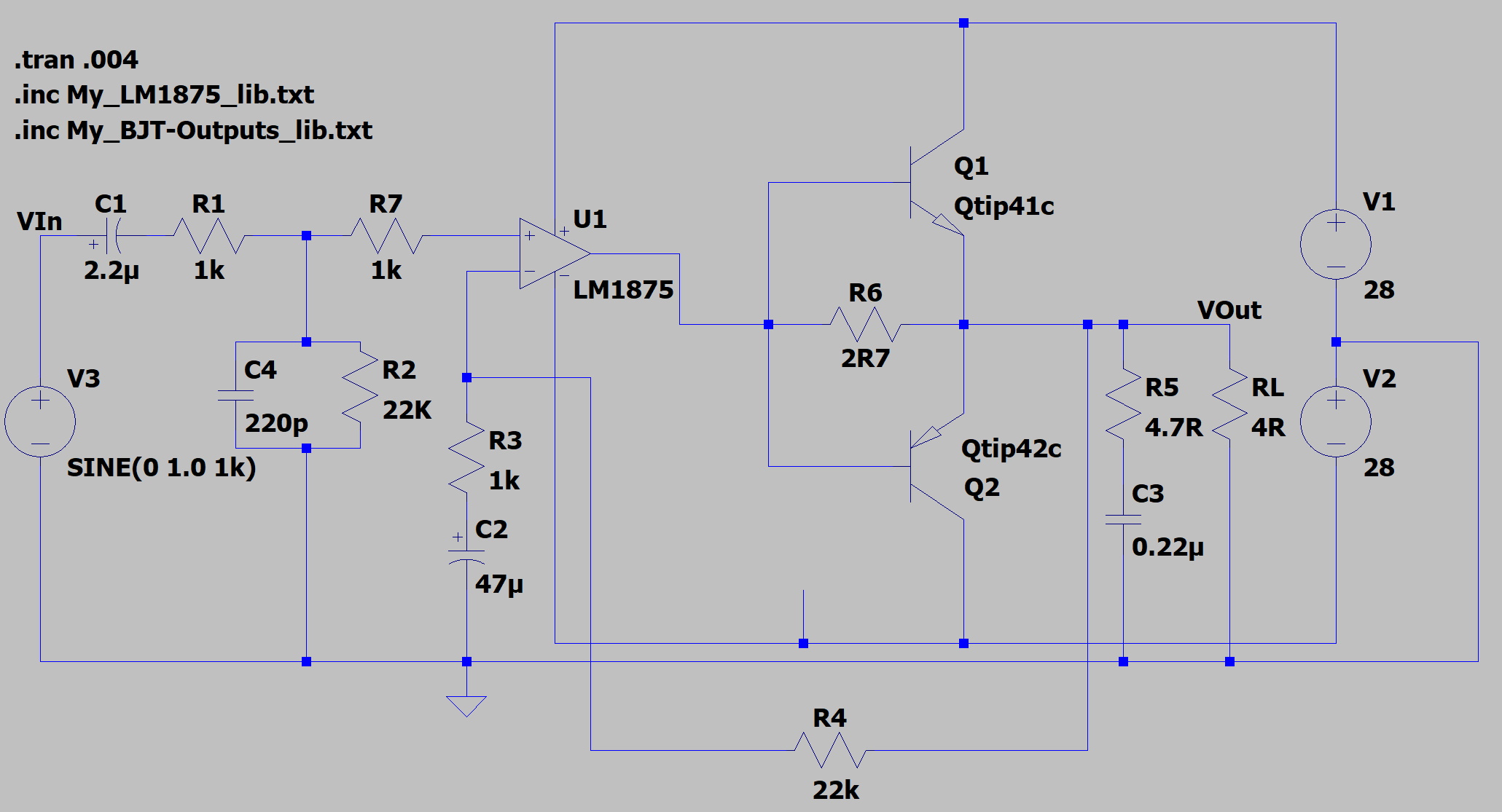

@WhiteDragon. That is very strange because the simulation I did in LTspice seems to be simulating the transistors turning on. You will notice in the Sim Traces image, that the transistors Q1 & Q2 collector current is measured at ±4.8A. The current measured through R6 is almost 459mA which is expected.
The simulation circuit used with the 2.7ohm resistor is shown in the schematic image. The transistors also seem to be heating up which indicates they are turning on.
As an addition to the above, in the LTspice simulations changing the value of R6 resulted in the below.
  1. Decreasing the R6 value to 1.5R increased the current flow through R6 to 798mA.
  2. Original R6 value of 2.7R resulted in a current flow through R6 of 459mA.
  3. Increasing the R6 value to 3.3R decreased the current flow through R6 to 378mA.
  4. Increasing the R6 value to 4.7R decreased the current flow through R6 to 268.7mA.
It tended to use 4R to reduce current of the opamp and resistor.
Anything higher than 4R can keep the chipamp protection from clamping
But due to anomaly of the circuit observed.
The topology frustrated me when it should be simple as expected.

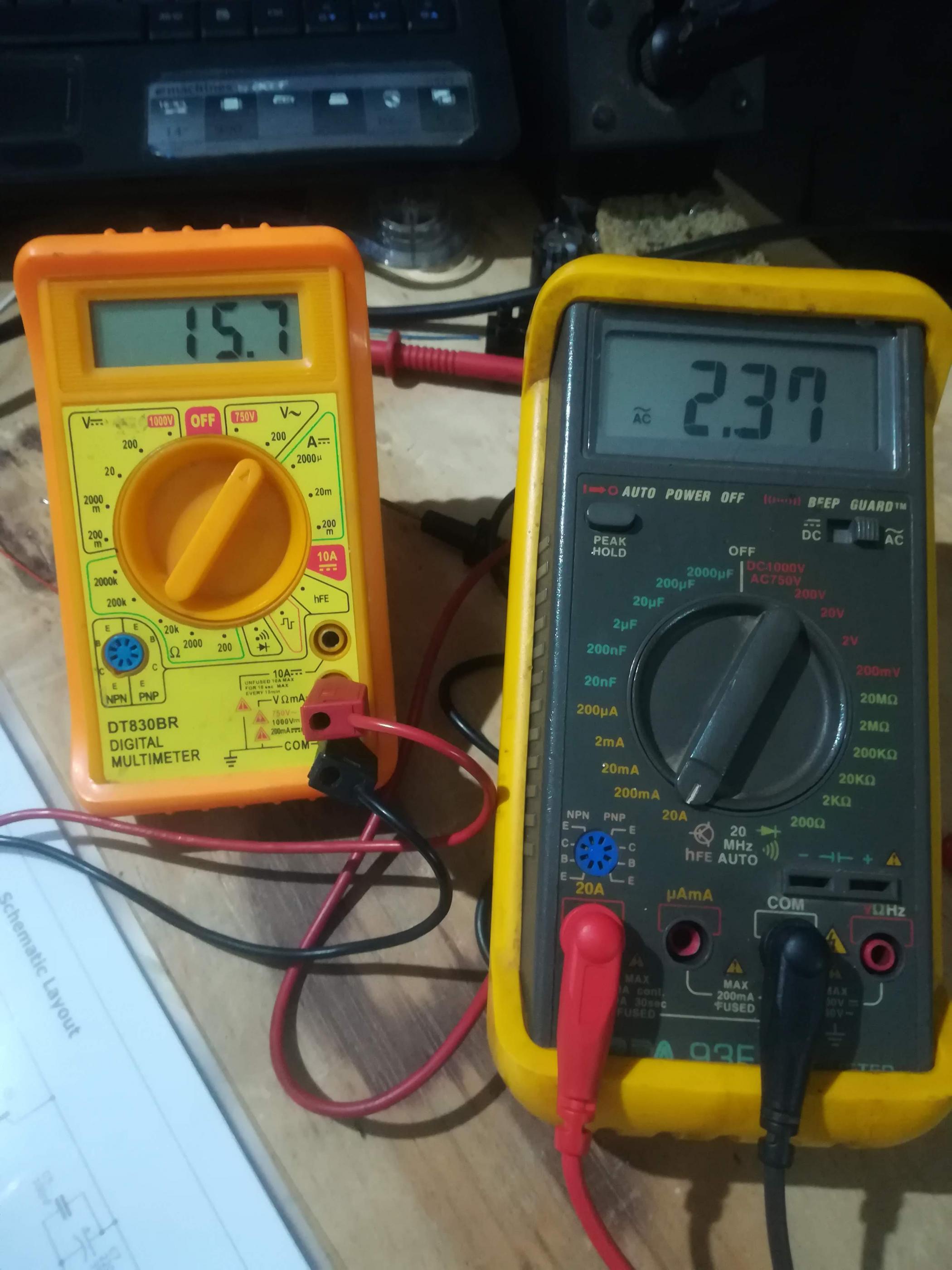

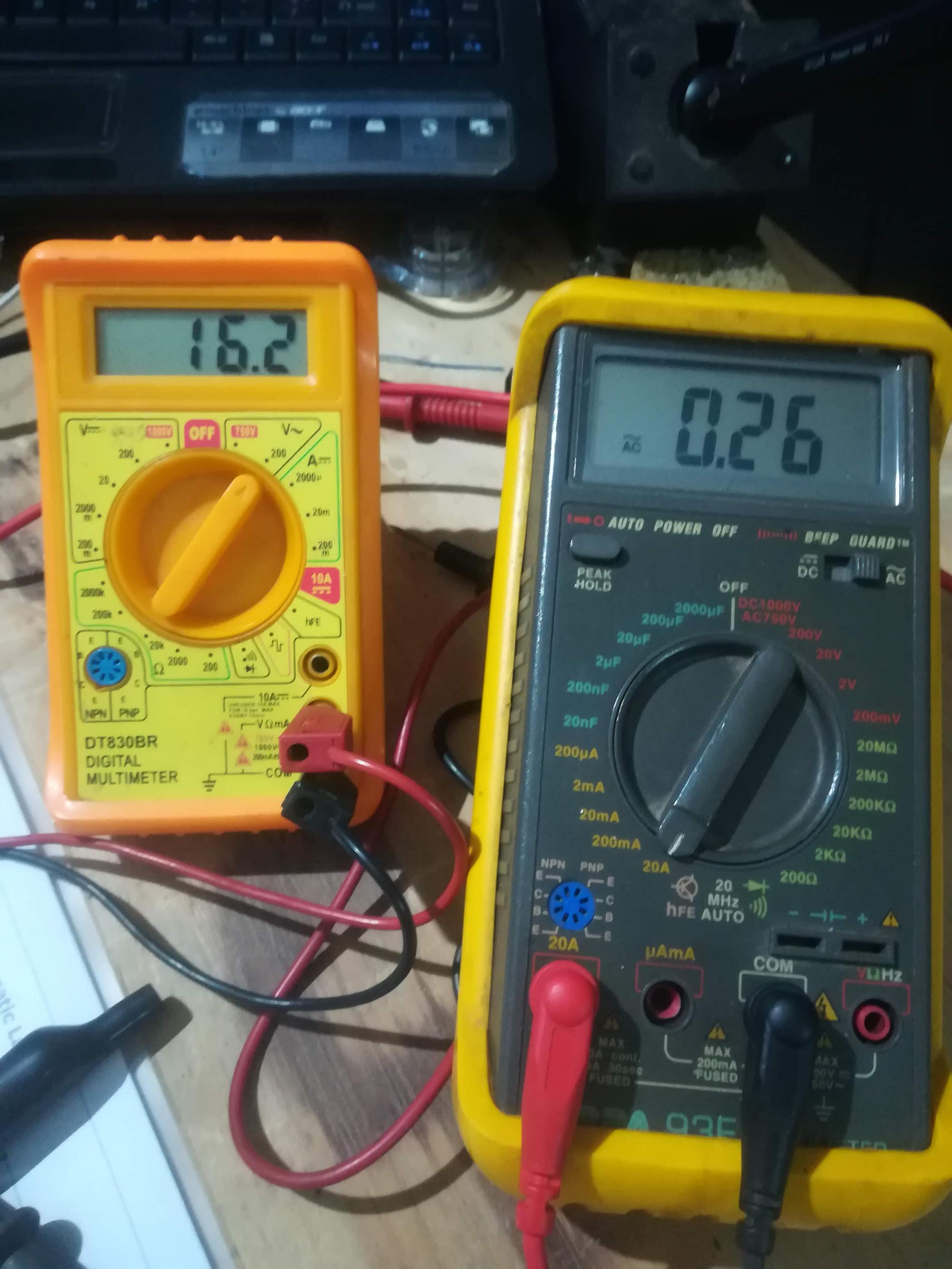

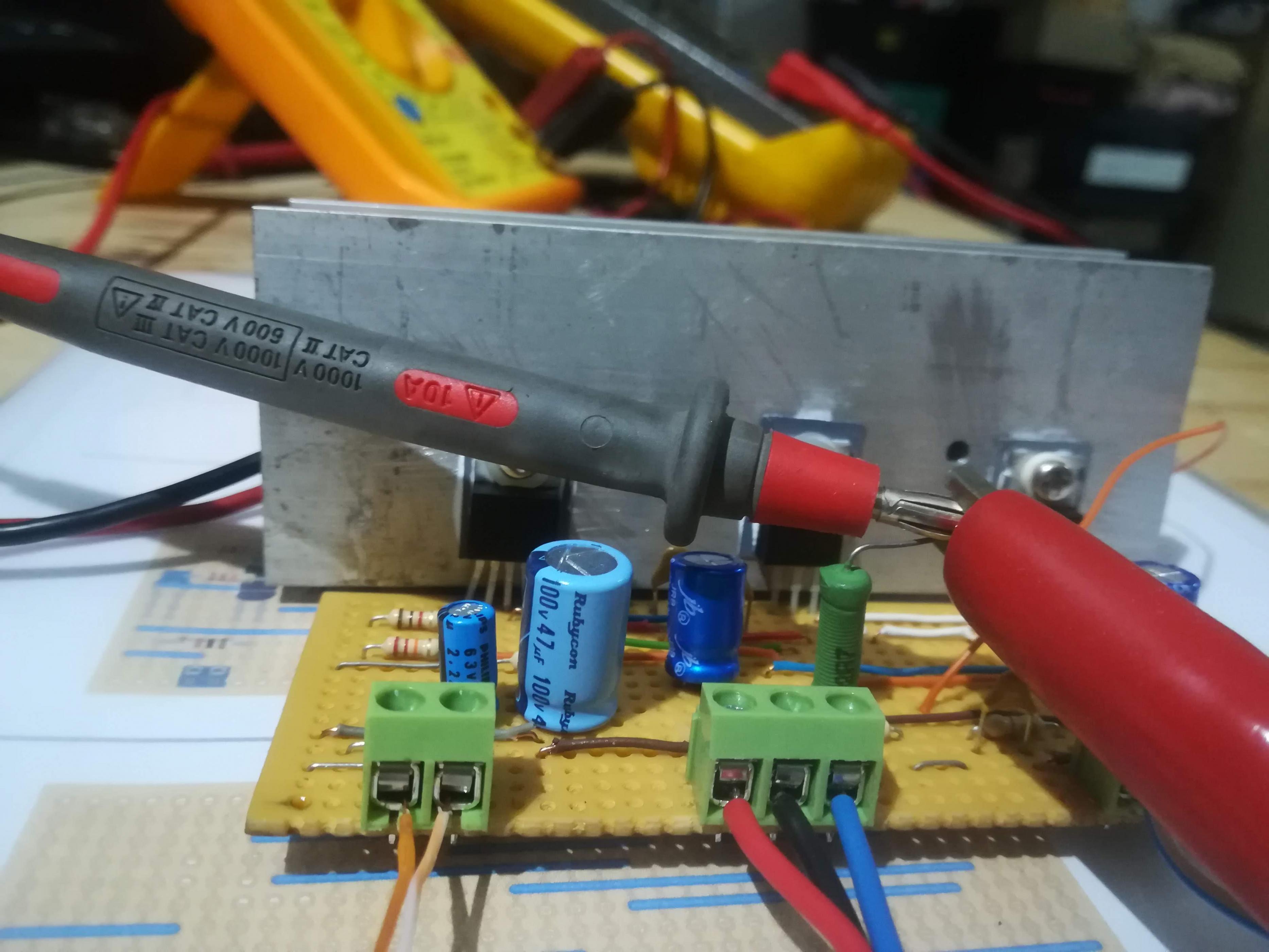

Not sure which spice sim your using but as per my latest post using LT Spice for my simulation the transistors do turn on and supply ±4.8A of current while a maximum of ±450mA peak. I have also attached the original Spice simulation plots.
I have now run a real-world test on my prototype board as well. As you can see by the attached photos the amp is driving 16.2Vrms into a 7ohm load resistor while a measured maximum 260mA RMS is flowing through the R6 2.7ohm resistor. All other current is being supplied by the transistors so they are definitely turning on and supply the current.
Images for above tests in post #128
These are the real-world test images for above post. You will see that the load of 7ohms is running at 15.7V at 2.37A and the current across R6 is 260mA. This test was done with a 23-0-23Vdc power supply.
Sorry for the two posts but I couldn't finish testing and uploading the images in the 30minutes given to edit the original post by the Admins.

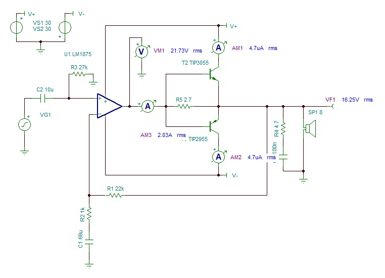

Doing basic DC analysis while bringing the amp up to 16.25 volts RMS
for 33 watts in 8R load
978010d1629963728-tda2030-transistors-ac1875ex-jpg
If you do AC Analysis
You will see what the 2.7 ohm resistor does.
True if the external transistors were actually on <--- THEY ARE
the opamp signal would reduce crossover distortion. <--WHICH crossover distortion??, the first 240mA come straight from TDA2030 with NO crossover distortion
Opamp output is 21.73 volts
but since there is a 2.7 ohm resistor in the way
Only 16.25 volts actually reaches the 8 ohm load.
<-- there will never ever be 5.48V difference between Chipamp output and speaker voltage because you can NOT drop that much voltage across a BE junction. You even got the wrong units, for better analysis we use Peak Volts, not RMS. So your 5.48V RMS becomes actual 7.75V peak. STILL impossible Vbe drop.
Basically 2 amps of current from the opamp. <-- never ever. Chipamp will supply initial 240mA plus current needed to drive booster transistor bases. 21.73V RMS is actually 30V peak into the load (discounting drop across Vbe) so 3.75A peak, so Base current is 187mA so peak chipamp current is 428mA.
Note: I am Calculating, not Simulating, so my design is interactive.
I adjust Vbe drop to 1.8V peak so we have 29V peak available at speaker out, so 20.5V RMS, NOT 16.25 V RMS
Actually if the 2.7 ohm resistor was too high.
If you shorted the output of the amp. The opamp would not
go into protection.
<-- gibberish
But since its shorted DC offset shoots way up to 9 volts <-- never ever ; 1.8V peak by datasheet
So then the external output transistors would finally turn on. <-- nonsense. They will turn ON as soon as R5 drops 650mV or so.
Well the NPN would turn on. <-- it was ON **way** before that.
And then blow up since the amp is shorted.
External transistor seem to be performing better than I expected.
Which is = Nothing
WTF?
NPN 4.7uA AC current
PNP 4.7 uA AC current
<-- nonsense. Under full drive as shown peak current acrossn each transistor is 3.5 AMPERES peak
as mentioned previously in the thread.
its better to use Darlington Output transistors
since it requires less current to turn them on. And also provide a bias network...so they actually turn on
They turn ON as soon as 650mVbe is reached
Are you trolling us?
No simulator can give the nonsense values you post, which was already detected by Charlbur and B Force.
I can't help but wondering if it makes any sense.
EDIT:thanks Charlbur for taking the time and effort to verify and disprove this nonsense post, both in simulation and ACTUAL BUILD, which seems to be a rare gem these days 🙂
