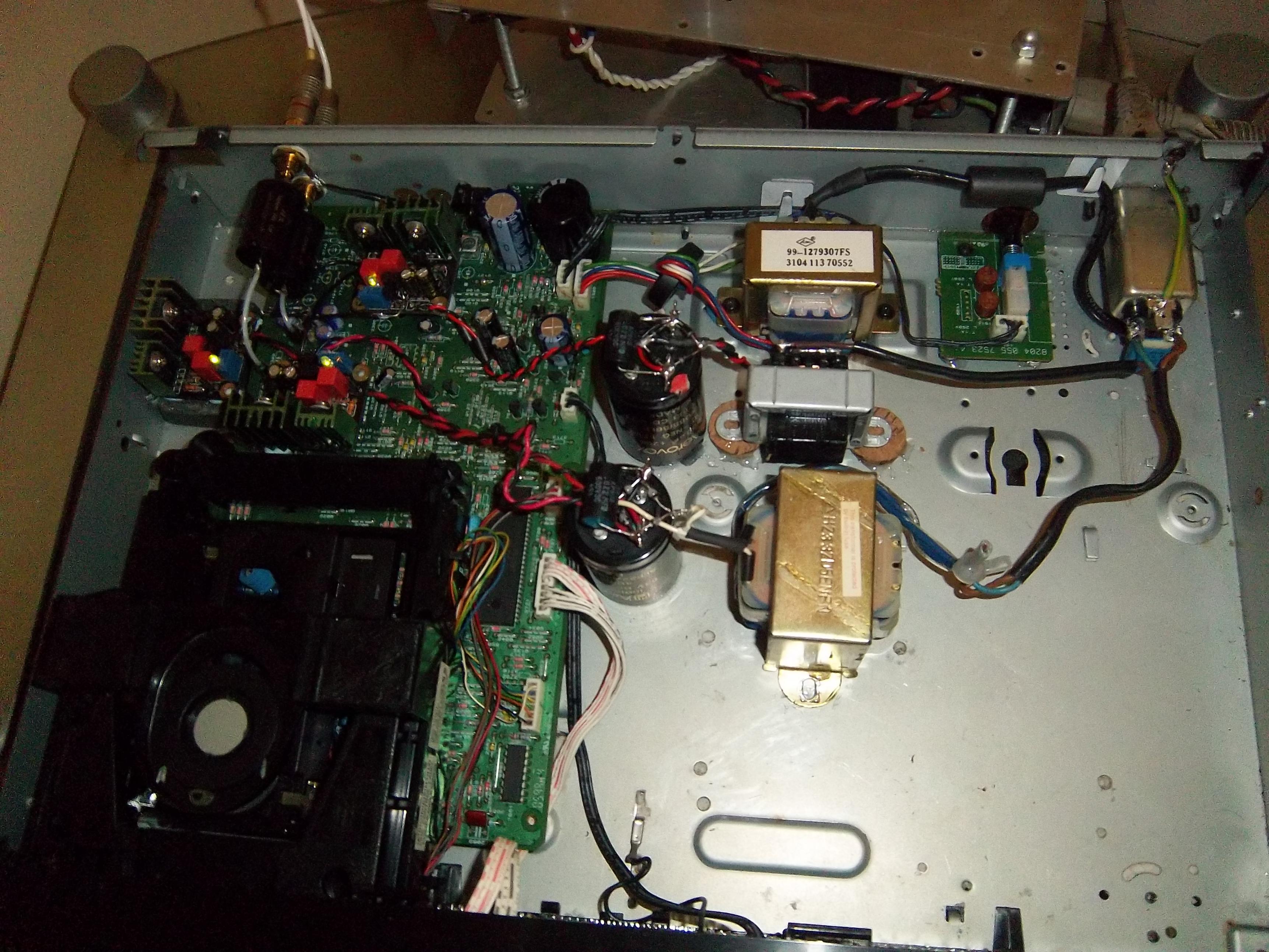

The thing lives !
All three regulators are powering the on chip i'v op amps, the analogue stage and the digital stages separately.
I don't know how to describe the sound apart from fatter, wider and faster.
Bass resolution is fabulous, drums are stonkingly real and lifesize.
My favourite instrument, the Piano, has real texture and I can hear pedals being pressed and released with ease.
Loving it - a very worthwhile increase in my blood pressure for an hour.
This is board no 3 remember....so no pressure 😀
My toroid hasn't arrived yet so I've shoved in another from something else. It's an easy swap.
Modded Arcam Alpha trounced and relegated finally.
Just the clock now....dilemma - where the hell will I put it...will it be worth it or will I wreck the whole thing again ?🙄

It does look a bit rough doesn't it but hey, it worked first time.
I can sort the wiring when the traff arrives...

Thank you very much - really pleased that I've inspired someone to have a go.
The valve buffer in the pic is based on 6N6P's and was built merely to balance the impedance between my CD, passive volume control and the rest of the system - at least that's my understanding of it.
The most scary thing I made so far and you do not need one tbh.
I would NOT make another - you may be an Engineer however but I just play the Piano and solder things.. hahaha
It also depends what you are using downline of your CD player too I suppose.
I have a passive volume control so the buffer helps out there.
The voltage straight off the dac chip is such that volume settings were the same even after I removed the awful dual op amp and the output stage components.
It is a nice player in stock form and does exactly what Mr Fikus of the Lampizator site says....mid range and hf are very good and bass is borderline acceptable.
The biggest surprise of all was taking the signal off the dac chip to the coupling caps and then to the rca sockets.
It was a ' bloody hell 😱 ' moment which ended up with a big grin and me playing disc after disc for confirmation.
The next jump was the Oscons around the dac and changing the main ps caps at the back near the 5v regulator - the bass improves markedly at this point.
As always though the power supply is key and the tiny tx that powers the whole thing falls way short.
Since I've added additional power and regulators I've gained in every conceivable area and it now sounds lush, rich, detailed and powerful - like a much more expensive machine.

3 for the dac chip might be overkill, try it with one feeding the 3 inputs as well and see if you notice any difference, you're probably getting into micro improvements at this stage. If you don't hear any difference you've saved some money.
One for the audio - you mean the opamp? That needs +/- 12v.
3 toroids will add some physical weight to the player if nothing else. I kept the original tx for the display ac, added 1 small one (7va) for the dac and a bigger one for everything else. If you do that remember you need at least +/- 12v available for the opamp (and possibly the mech).
Regards
Pete
Thnking about it, if I'm taking the output straight from the DAC, I'll be bypassing the op amp and thus won't need a 12v supply for that. I'm fairly sure the transport will need 12v though.I have a few 6+6v toroids tucked away. I'll wait and see what else needs what when the player actually arrives.
I did what Pete suggested - one tx and regulator for the three elements of the dac chip - there was a difference....hahaha.
Now with albeit 2 poor traffs and 3 regulators there's a massive difference. I'm going for 3 too once the clock is in - can't have too much VA from past experience imho.
I'm now fairly confident which bits to remove to add a clock too and when that arrives and goes in I'll post some details of ' how to '
I'd like to power the display too but am unsure of how to implement it. Need to read the service manual again and read Pete's post and pics
Do you have the service manual - I can send it if needed ?
Parcel in the post tomorrow morning btw ! e
