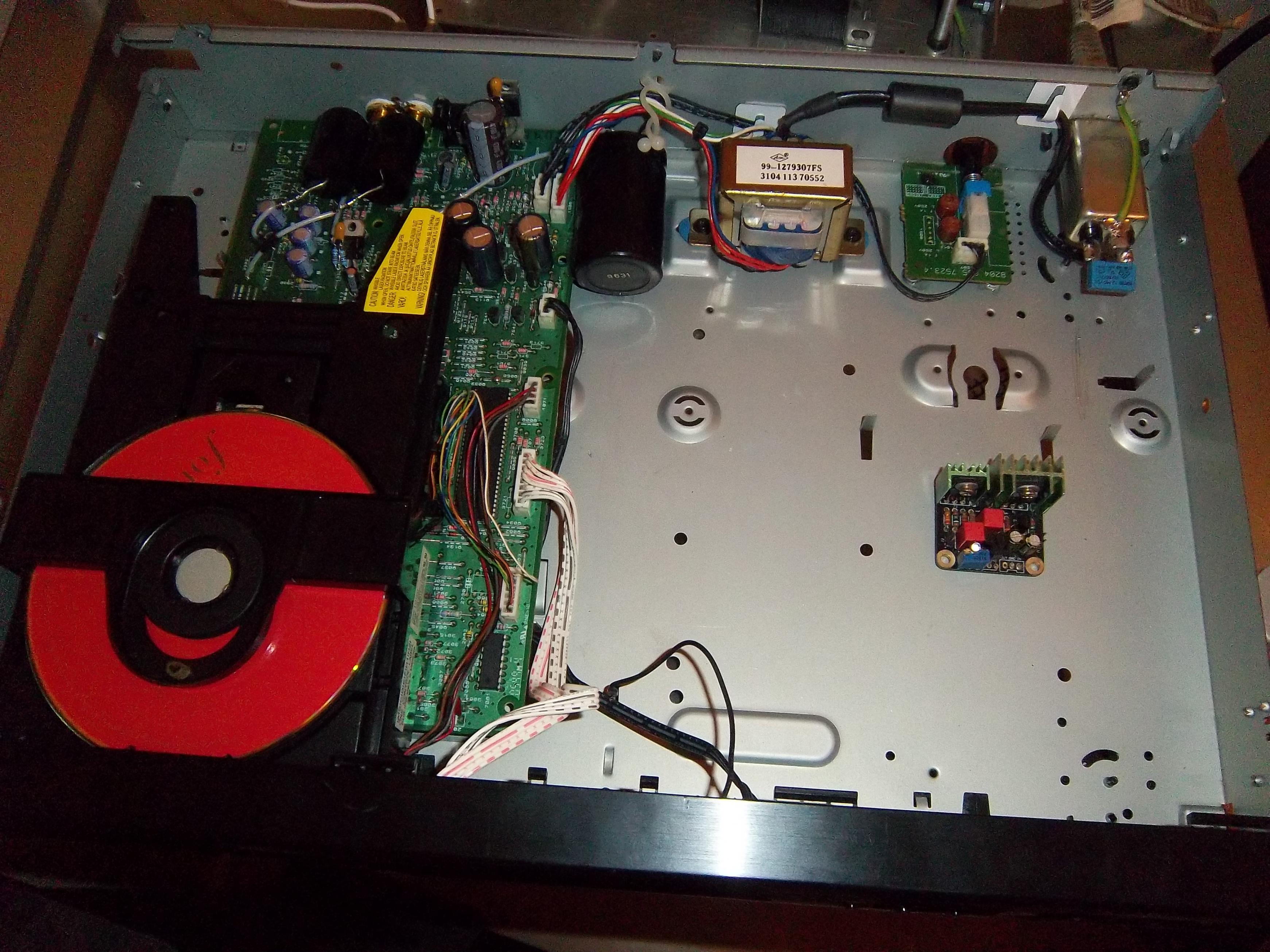

I'll get a photo up of the 317.
Did as we discussed - main cap for it's power and a wire to gnd on the board.
10 minutes ish ?
What a result 😀
You can just see the regulator and the tant in the middle of the board.
It works extremely well and has really changed the sound for the better by a fair margin.
I'm now itching to feed the regulator with it's own ps.
I've found a small traf that'll give me about 18v once rectified so that's going in.. as soon as I've got the IEC socket sorted.

Glad you liked the change.
Improving the regulator will bring some extra benefits but always difficult to predict how much, always depends on other factors.
A better reg will clean up the incoming supply a lot but if you're adding a seperate tx anyway I would expect the supply to be fairly clean anyway.
Using leds to set the voltage on the 317 (instead of a resistor) will improve things as will adding a vbe on the input, both relatively easy and cheap to do. After that you're taking about something like a flea which starts to get expensive. I only added a flea with it's own tx so I can't rally comment on how much better it is that just a separate basic supply I'm afraid.
One thing though, 18v into the 317 is going to give a big voltage drop and may require a heatsink on the 317. If you're not going for something like a flea then a 9v tx should be more than enough. Even a 7v tx with schottky diodes will give around 10v.

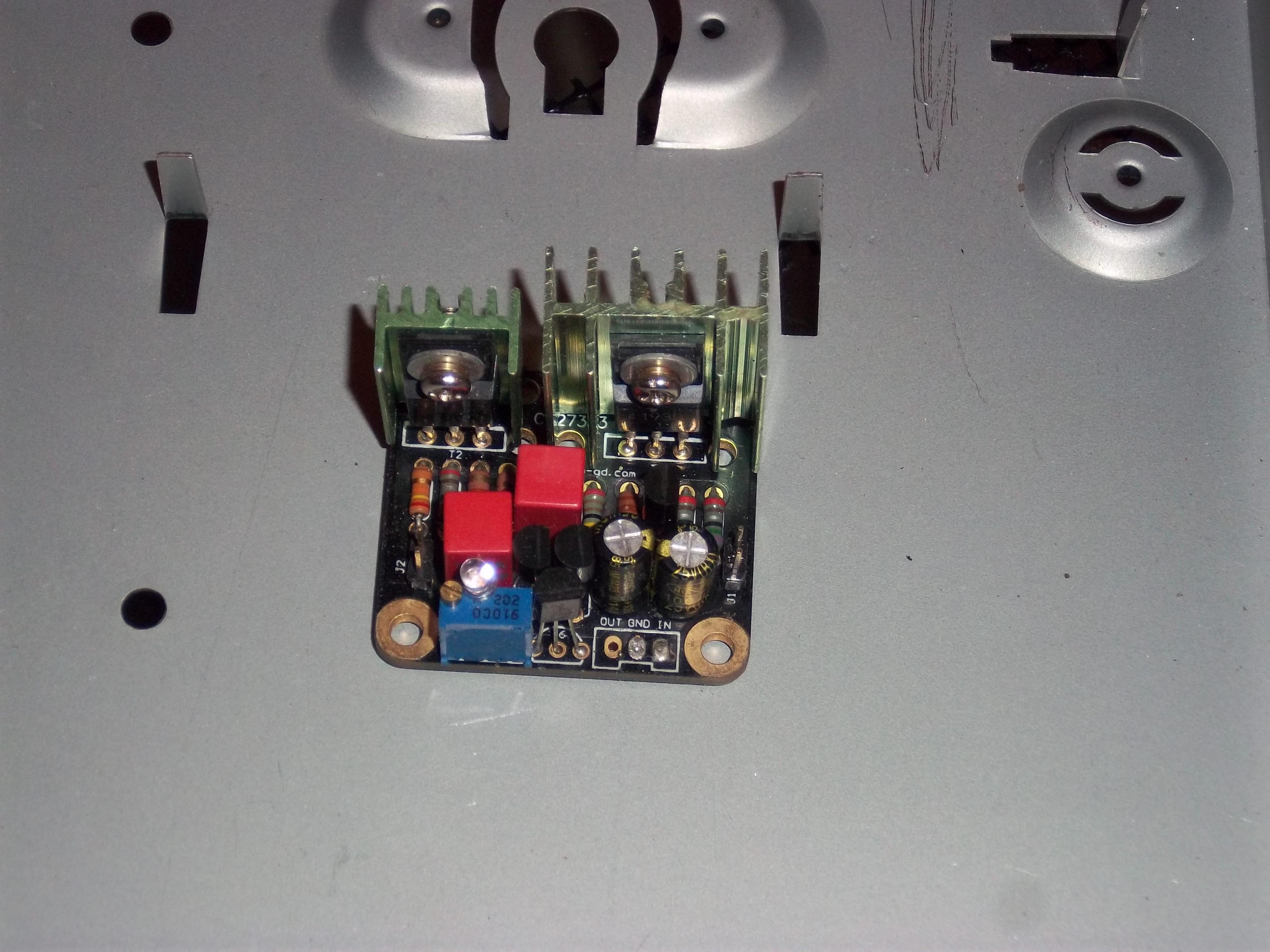

Found 3 excellent 5v super regs made by audio gd which I bought to put in an arcam alpha 5 a few years back.
Never got round to it and forgot I had them.
Maximum input voltage +15v so it's a good job I listened to you Pete and ordered a 9v traf instead of using the ones I had already ....haha
Nirvana awaits
Oh sure... that old chestnut again 🙄
IEC now in plus a ferrite on the inbound and last pic is the little 5v regulator
going in to power the dac once the traff arrives.
I've got three of these regs and it's possible I can use all of them in here.

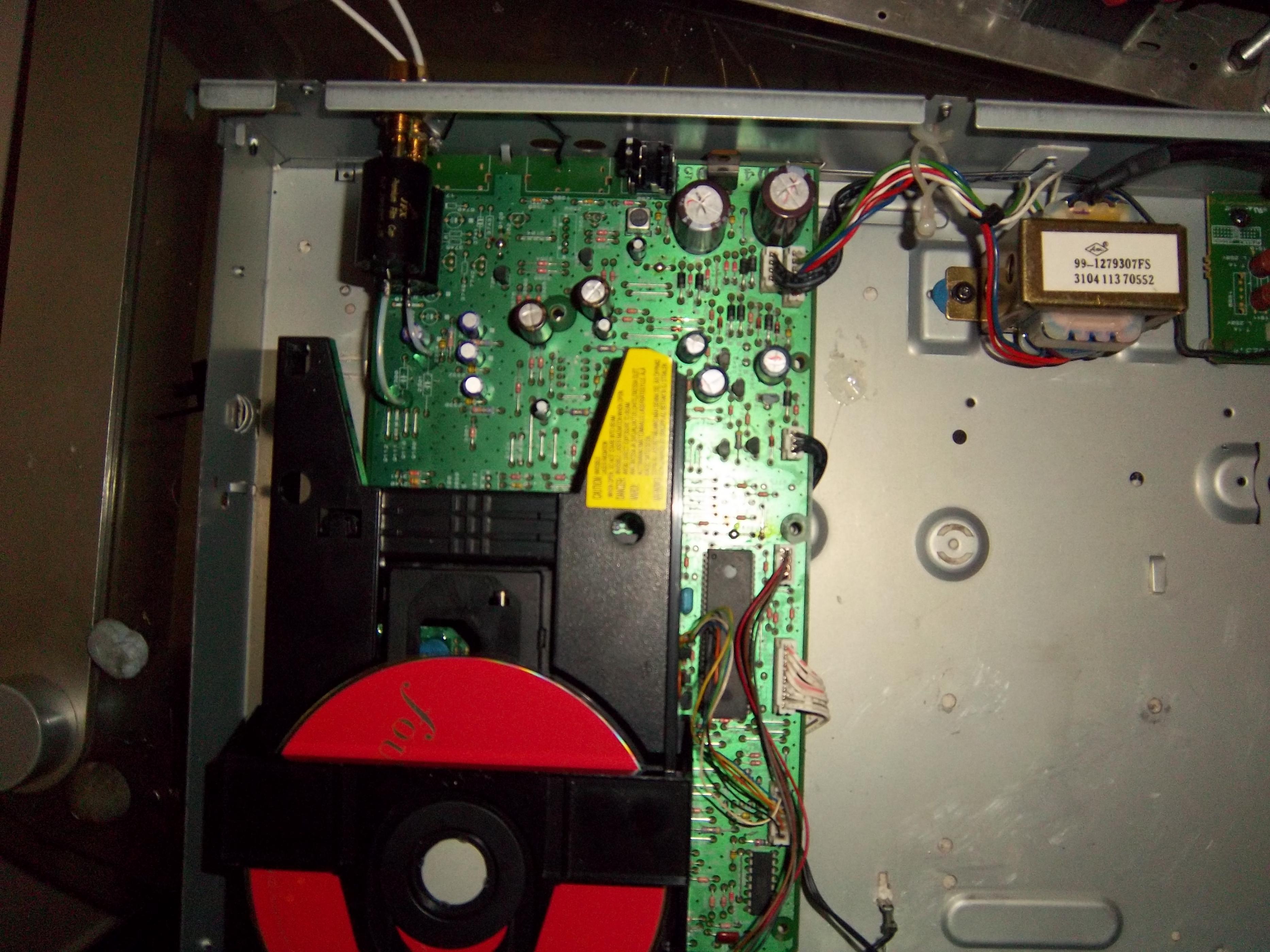

pete......I have a mayday
I've done something to it and it's odd
I changed the last original power supply lytic to bigger re dressed the coupling caps and moved the rca sockets to the left of the board ( to make room for a regulator ) snipped a couple of old unused small lytics on the original output stage off and finally changed 3 x 220 ohm carbon resistors that take bclk, sclk and data to the dac chip. The 3 resistors are side by side. I've checked my joints and anything else I could have disturbed and I can't find anything.
So, when I switch on the display is doing what it does correctly but is flashing every second and the sound is a kind of white noise with a bit of music in the distant background. It reads discs, changes tracks and there is 2.4 volts at the dac pins. Technically it's working in every way but is unhappy about something......any ideas ?
Bugger😕
Not good 🙁
Did you replace the 3 resistors like for like (ohms), have you measured them after you put them in?
Only other thing I can suggest is maybe one of the bits that you removed wasn't related to the output stage?
The display flashing would maybe indicate that the problem is power related (possibly a short somewhere) but I've not come across these symptoms before.
No sure what else I can suggest apart from trying to put everything back as it was before the most recent changes.

I've reversed the main power supply cap job and put a few small lytics back in ( 2 to go ) but I've been having a poke around with my meter too.
Believe it or not the voltage in to my regs is lower than the output of them and the voltage across ' the ' main large BHC capacitor is less than 4 volts...
That's not right😕
I'm going out for a new battery for the meter....it's getting silly now😡
The machine is functioning exactly as it should and in every way - display still blinking .
It's going to be something simple - I've looked for solder blobs or shorts made in error, polarity of caps checked, track damage, lifted pads etc....
None !
Hmmm you should be getting 10+ volts to the main cap (2536) if you're only getting 4 then either something else is drawing all the voltage or there is an issue in the circuit before that cap. In that case it can only be a faulty tx or an issue with the fuses or diodes. Maybe one of the fuses has blown, that would cut the voltage by half. I'd check the ac voltages where the tx plugs into the boards, at the fuses and at the diodes.

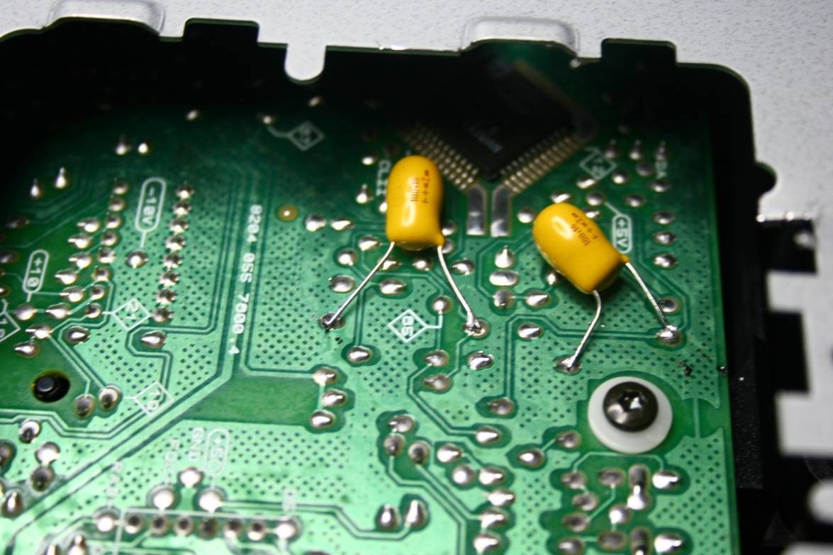

Sounds good, what's the tant bypass?
One suggestion, if you're not sure about the clock try it on your old machine first. Even with the problems that you have with that you should be able to see if the new clock signal is being picked up ok.

The pics say it all really.
I pinched the pic off the Lampizator site but it's much the same as mine.
Truth is I've no idea what benefit there is but hey, every one I've seen has this trick done.
It's below the SAA - you must have this chip too ?
There's blue Philips axials of 47uf on the other side of the board that the the tants are connected to.

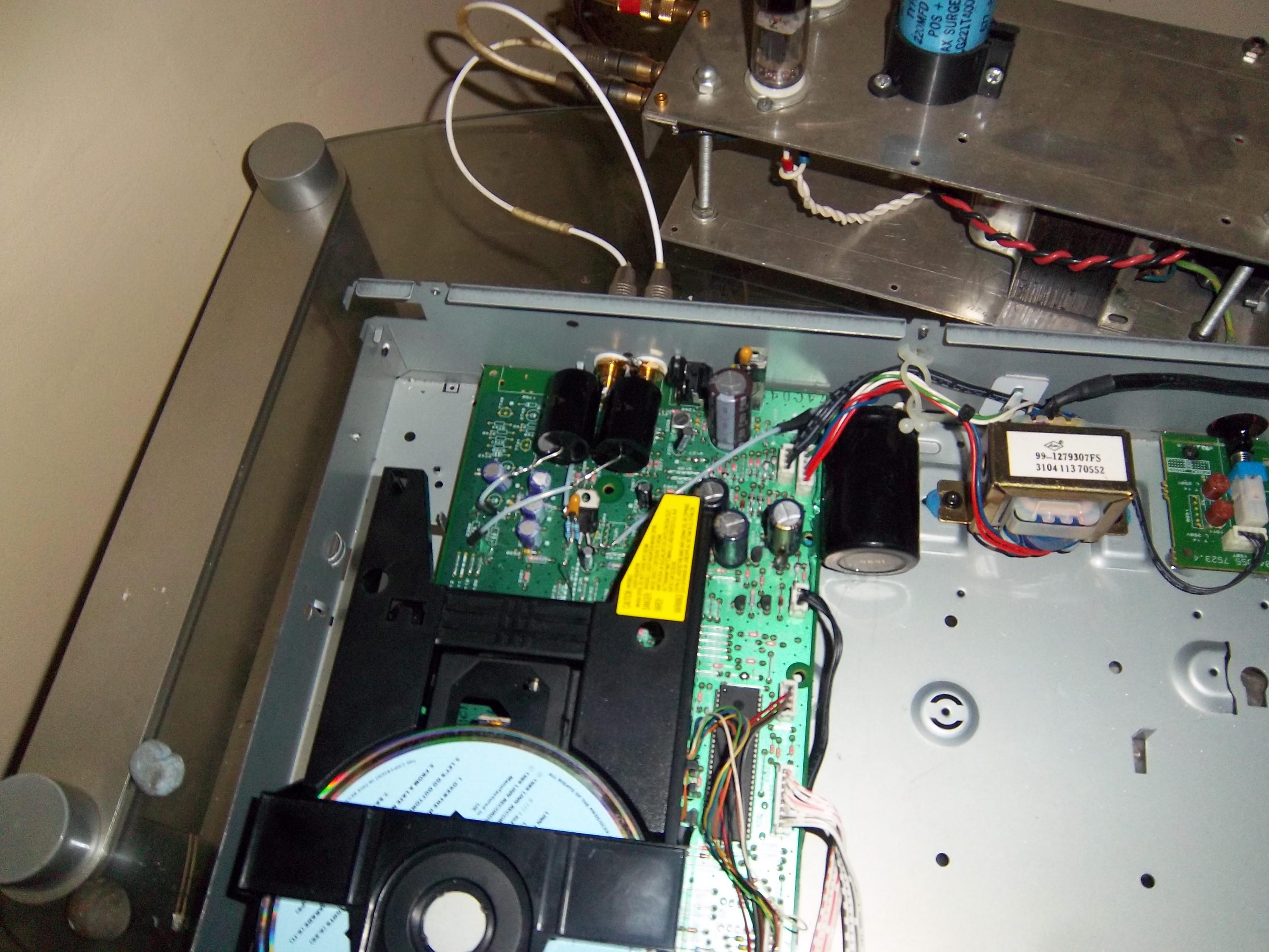

Bit of a development...
I just did the main ps smoothing caps but this time instead of the stupid ( idea 😱 ) large BHC cap laid down at the side connected to the board by wires ( as per the older pics ) I put newly purchased larger caps on the board where they should be - where the old ones were ( ashamed )
Well, the bass has taken on a life of it's own and reaches much further down and slams it home ( when applicable anyway )
It's a hugely satisfying gain and anyone who says these players don't do
' bass ' needs a rethink.
I've no bypass caps in yet and there's still plenty to do but if I can get this kind of ' order of magnitude ' again from what's left it's going to be stonking !

I didn't do the tant bypass. I removed the original axial ecaps and put some bigger radial ones in instead (on the underside of the board, no room on top).
I've not got any posh output yet, but I did find some Wima MKP4s which I'm trying. Only put them in yesterday so still running in. Promising though. I'm not sure there's a lot of point going any better at the moment given that the signal will run through some worse caps on the input in my amp.
