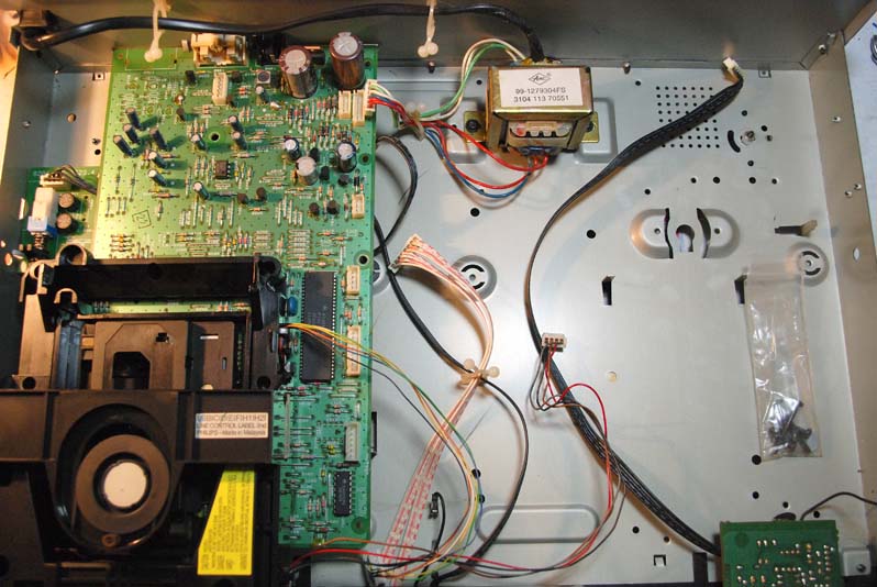

Well Pete, I've loaded one of these into my player as the main regulator and it has no right to be this good for £15.00 delivered.
Specs below :
# Input Voltage Range: +3 V to +36 V, suggested input voltage 6V - 9V
# Output Voltage Noise: 4.17 μVRMS (10 Hz, 100 kHz)
# Power-Supply Ripple Rejection: 82 dB (100 Hz) ≥ 55 dB (10 Hz, 10 MHz)
# Output Current: 1 A : Heat Sink required for high current operations
# Dropout Voltage: 307 mV at 1 A
# Pin Out same as 7805 TO-220
# Small Footprint 2.5 x 1.6 cm
It's been talked about before on the other Marantz thread.
It got a bit of a pasting by some of the clever ones just reading the specs ( of course ) but a member who actually bought and used it said it was very good too.
I can tell you it's dropped and solidifed the bass another step, is revealing stuff that was kind of in the background before ( much clearer ) and vocals have taken on a better realism.
Leading edges of instruments and textures have jumped to another level.
Absolutely stuff's the 7805 and my 317 attempts too.
Best £15 I've spent.
Just ordered 2 more.
The 48 is in my main system now and has my Arcam Alpha's pants down - and I mean that.
Still to power the dac chip independently....4 fast/soft diodes, 3 caps and 3 resistors to do yet !!
All done by Saturday and then the lid goes on before I wreck it.
I'll let it bed in a while, then split the rails to the dac and practice fitting a cheap clock to the other one while all that is going on - that was a good idea P
Think the Flea and Tent XO is the best way to go ?
Did yours improve things - like an immediately noticeable gain ?

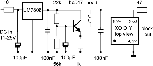

Hi
Do you mean the attached circuit Pete ?
Have you looked at the Tekdevice site ?
Buying one ?

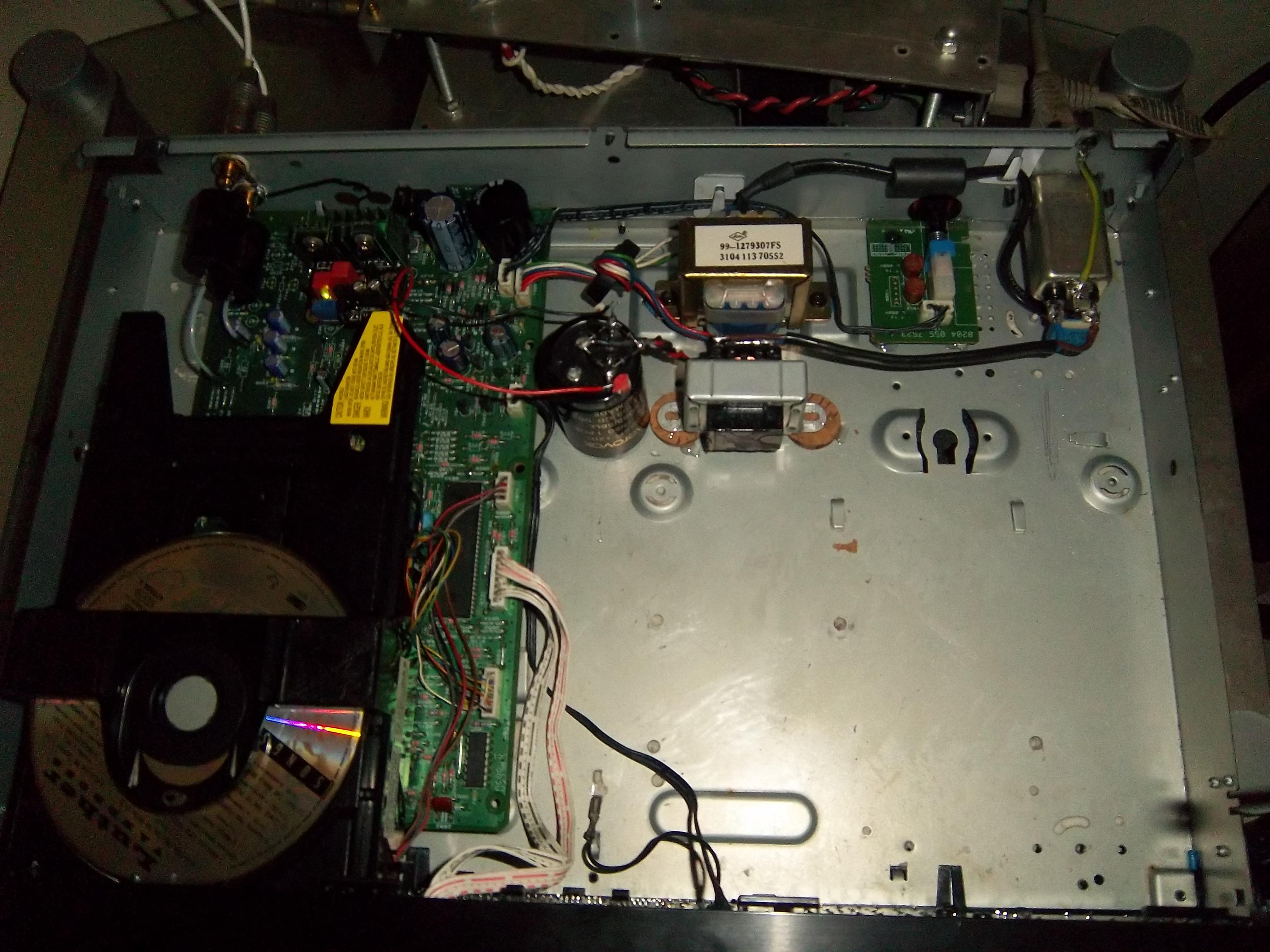

The dac power supply is ready in a crude kind of way - but ready it is.
It's at 5.05v all night so it's going in tomorrow.
If it works and improves things ( and there's no reason why it won't ) I'll polish it up wiring wise and make it permanent.
I'll post pics of the ' lash up ' too if all is well.

No, I meant just use the tek reg to connect directly to the +5v of the xo and connect the clock out via the small cap.
I had a look at the tek, wasn't sure what the chip it used was though.
Doubt I'll buy one though, I enjoy matching leds too much

Fantastic - like better than the op amp ?
I didn't listen much with the cheap op amp in or the rest of the bits tbh.
I've done the ps to the dac and the word is scale, drive and grunt.
It's all a bit of a mess because I couldn't wait so there's trimming and twisting of wire, some bypass caps, ferrite beads to attach, better fixings and stuff but as a ' lash up ' it sounds astonishing.
I wonder now if splitting the dac rails will bring worthwhile and noticeable gains...I don't mind having a go if it'll be a big jump.
Loads of little things to do but it's certainly time to leave it and enjoy for a while - plus I've the clock experiments to do that you suggested
I can only imagine what that'll be like if it works....if it works

This seems perfect Pete but can you expand on this so I can get a picture in my head....or draw a rough picture maybe ?
Sorry
The xo is just a canned clock that needs a supply voltage to work. In the schematic you posted above everything to the left of the XO is just a cleanish voltage regulator. So you can replace it all with just your tek regulator (or whatever you have to hand) feeding the V+ pin of the xo. You will still need an earth connection for the XO and the 47u cap on the clock out.
Regards
Pete
Pete, are you saying I only need a good 5v supply, an earth connection and an xo plus a coupling cap to the xo ' in ' on the board ?
Can it really be so simple to make ready ?
I'm almost ready with the additional bits to power the dac chip with 3 x 5v feeds.
The single independent power supply that's running the whole dac chip currently is sounding fantastic so I'm really looking forward to hearing what happens to the sound with 2 more shoe - horned in.
Once that's done it's the clock to do - the one thing that makes me nervous.
Not because it's hard to mechanically fit and wire it - I just don't understand which bits to lift or remove.
This is where real knowledge counts and I'm a bit limited in that department.
I've looked at the service manual over and over again and I'm still not happy so naturally it's been left to almost last.
It's quite astonishing there's no pics and reports on the internet of successfully clocked 48's or Philips players.
Wonder why that is ?
In a week the full triple ps will be done and I'll post pics of the spaghetti job.....mess or not
