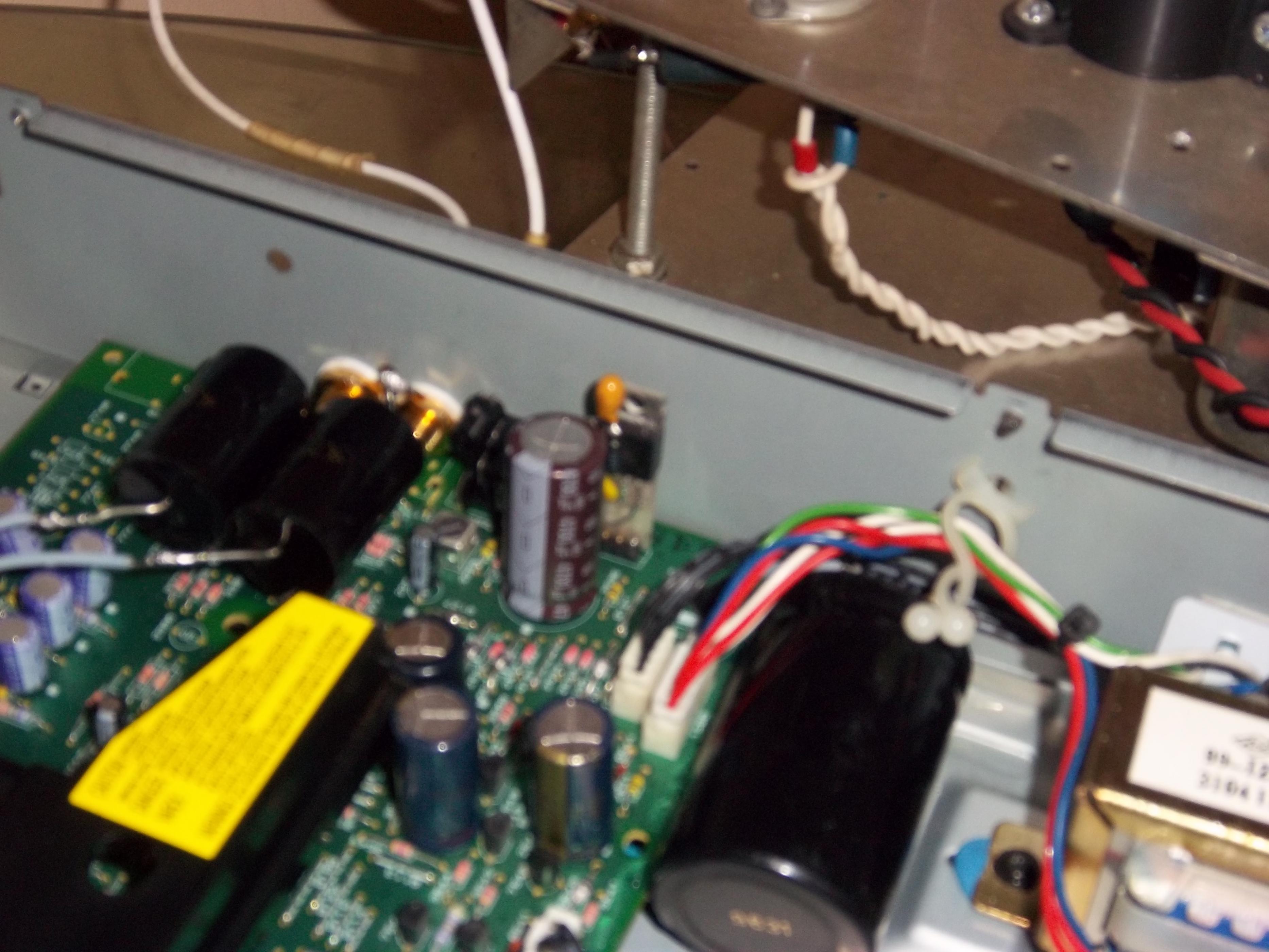

Took the opportunity to fix some flying leads to the 1549 outputs direct, albeit with just some wima mks2 as blocking caps. Switching between the 2 at the moment and it's sounding at least as good as through the opamps.
Might have to get some better caps 🙂
Tempted to leave it as is though, it's a very fragile board 🙁

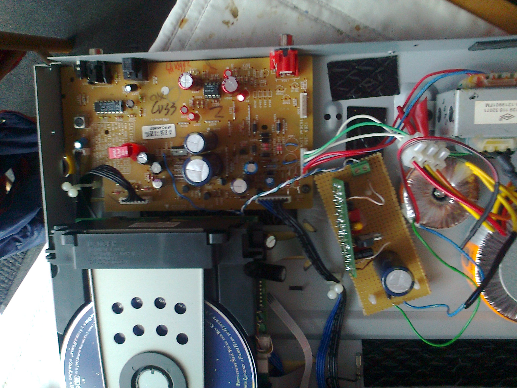

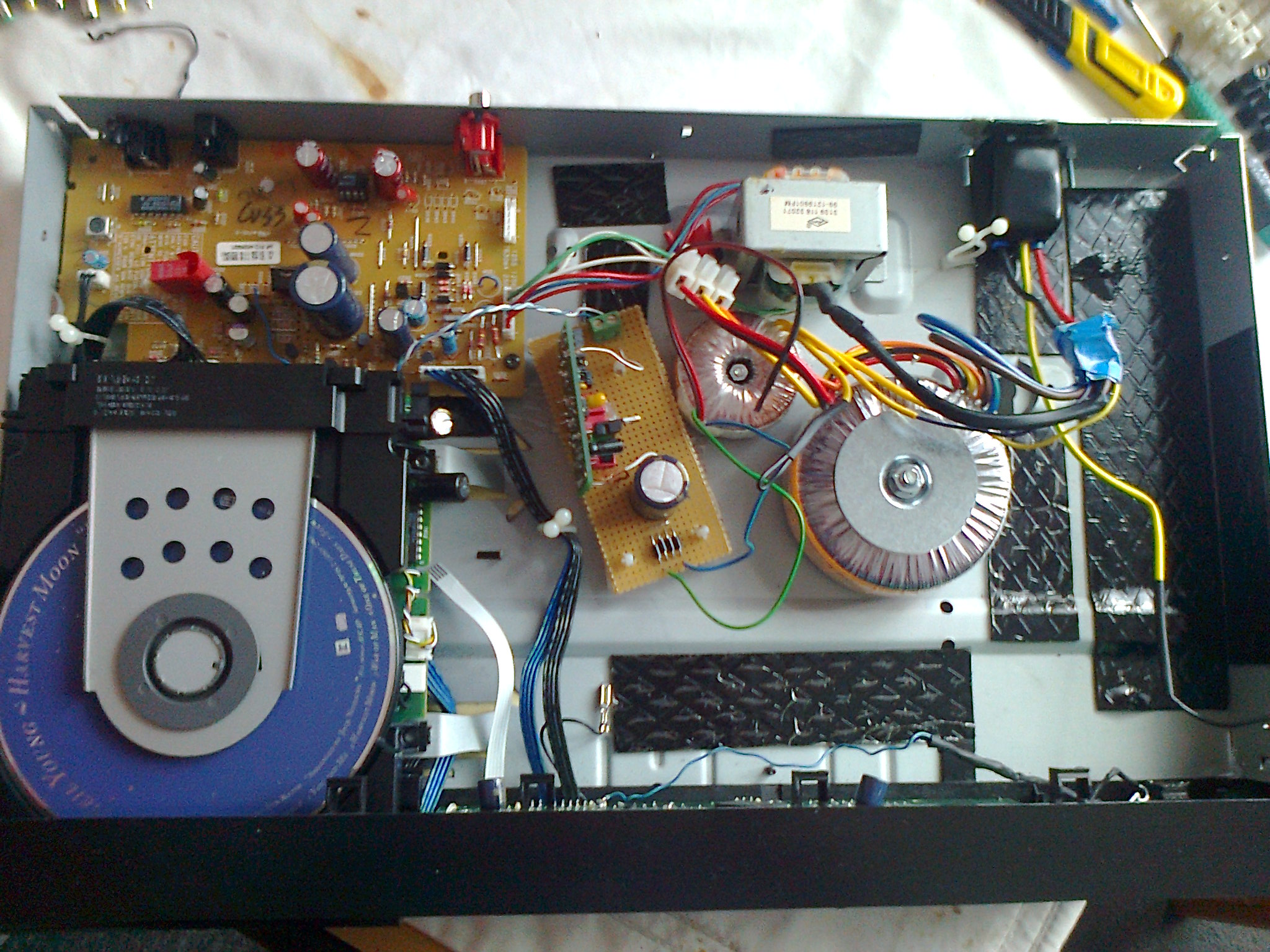

Here's a few pics then...

Here's my interpretation of the Ray reg - albeit minus the caps on input and output pins.
I can add them later and I already have another idea on the bench which is similar.
It worked a treat and provided a noticeable gain too.

To complete then :
Filtered IEC socket ( ordered ) screened mains cable, ferrites on inbound primary and outbound secondry ac wires, posh resistors, tin foil caps, casework damping ( now ready to apply ) proper independent ps for dac chip

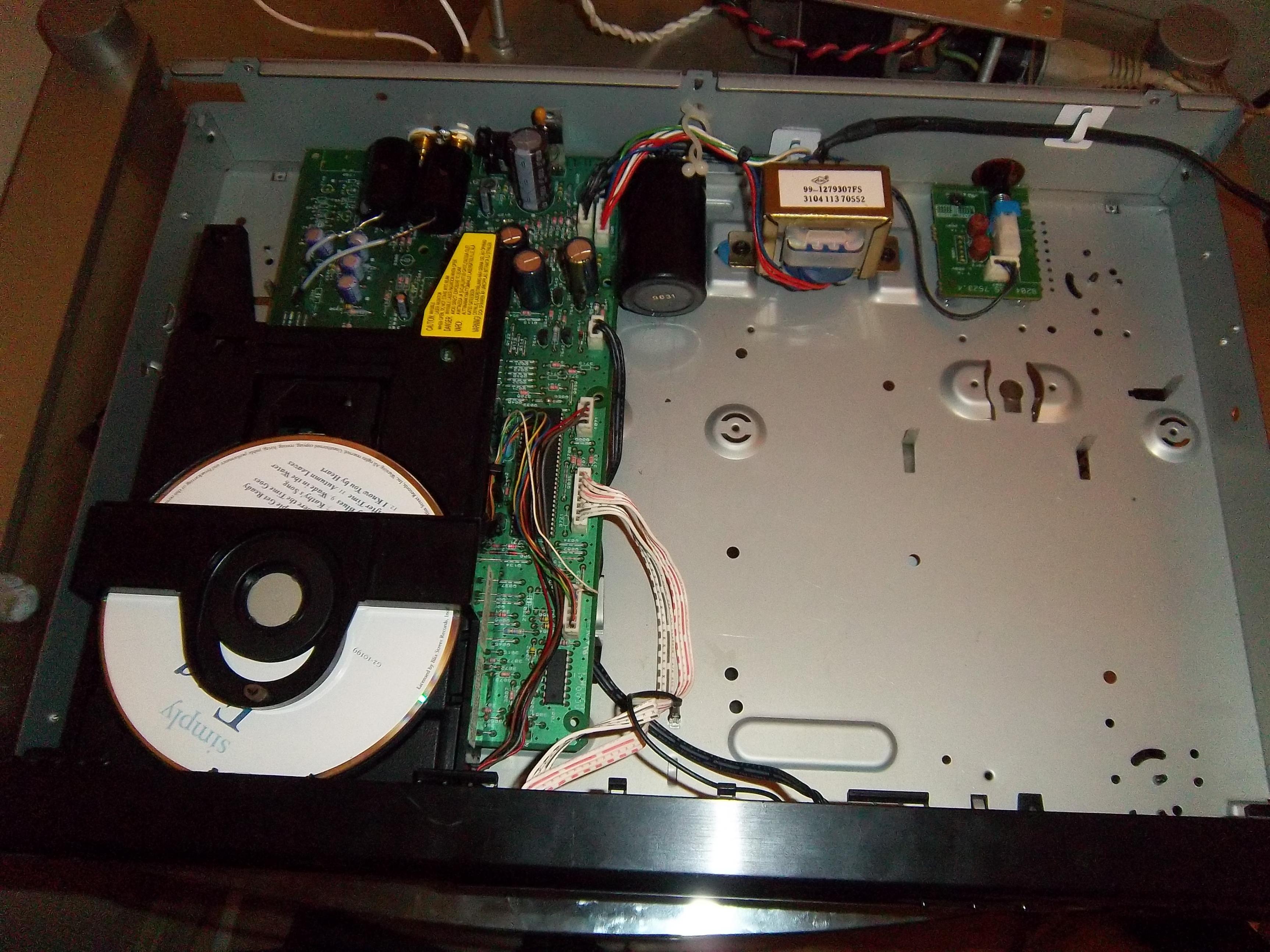

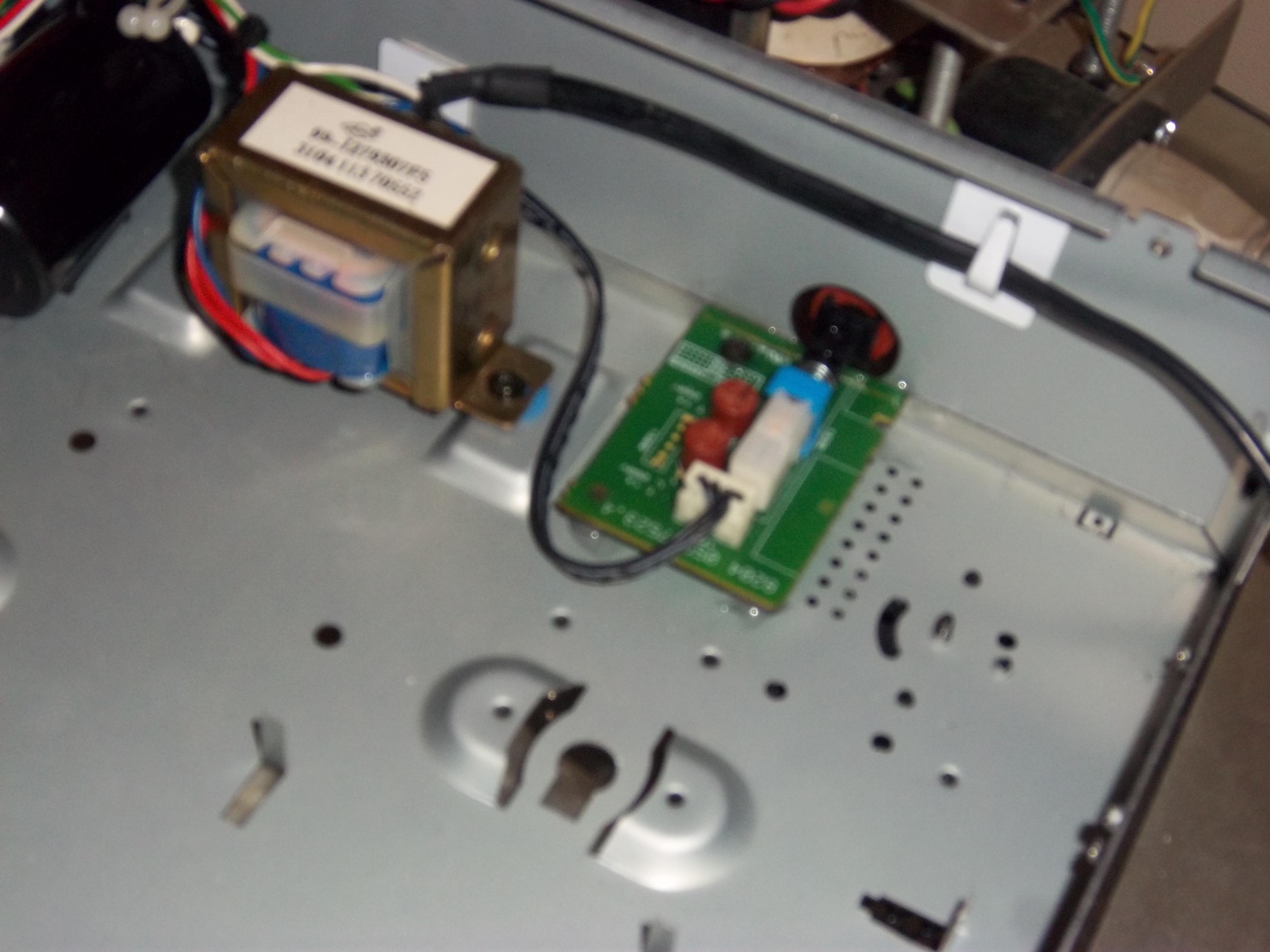

Look at post 12 to see where the ' little green board ' was originally.
It's actually the ' on / off ' switch and now has a push button on the back panel of the player - it's really easy to access.
Of course I've now a gaping oblong hole on the left of the front panel which I'll tastefully disguise.
You'll never know that hole was there when it's all finished - I have a plan already

I found some no-name polyprops that I scavenged from some old mission speakers so I've replaced the wimas with those for the time being while I decide how much I'm willing to spend on new caps (and how big they can be to still fit in somewhere). Big improvement.
I also lifted out the opamp so it's not drawing any current (although I don't think that's much of an issue with the tx I have) but I've left the rest of the associated components for the time being.
Going to listen to it like this for a while.
