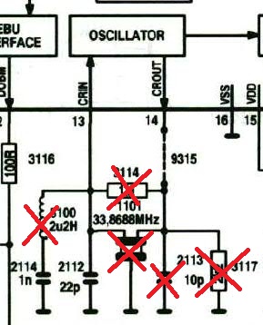

Oh...and have a look at the clock wiring - let me know what you think ?
Cheers
When I tried to do the clock I also removed 2112 and 2114 and just connected the clock to CRIN, any reason why you've left them in?
The way that you're doing it 2114 will be disconnected anyway when you remove the inductor but 2112 looks like it will still be in circuit. No idea if that will cause any issues or not though.
Remember I never got it to work so I can't really give much useful advice🙁
Pete

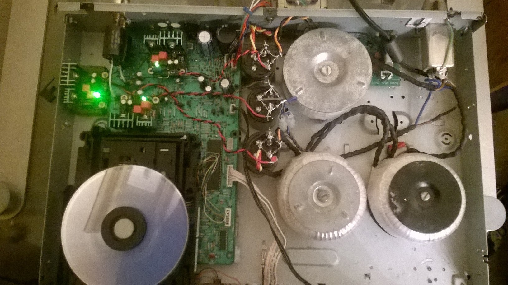

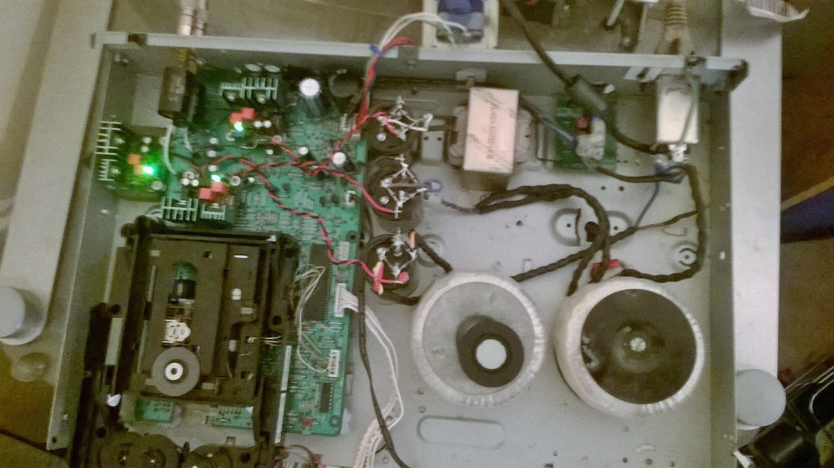

Another step closer to achieving total madness....
3 x 100va ( plus the original transformer ) now in and running - still one more to hand off the back temporarily for the main board supply.
The clock is definitely getting the same once all this lot is in the new box.
....and the result is - it sounds HUGE - everything sounds massive, bass is feeling like it's hitting me too.
I like it and when I listened tonight I was aware of a stupid grin on my face....
Pete...can you describe what happened when you put your new traff in for the main board ?
Was is a noticeable gain ?
Even if it wasn't great can you just lie to me instead please....hahahaha😀
I'm itching to get it wired in but I've got to move the original tx along the back panel some more....I'm kind of putting it off because it's a bit of a pain in the a... job
