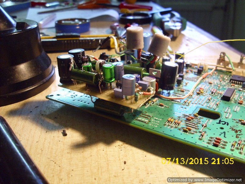

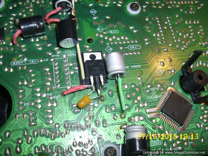

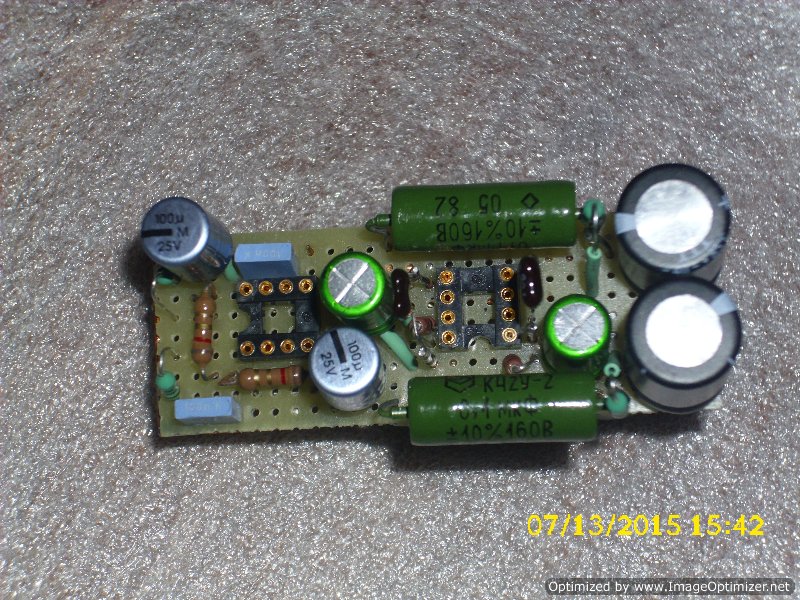

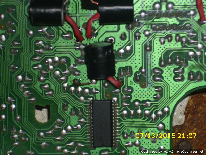

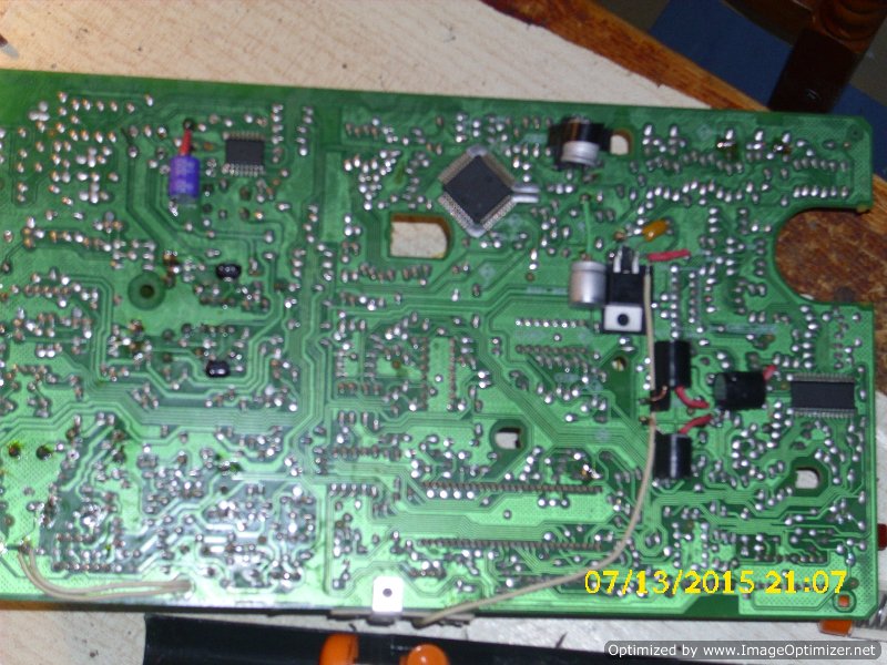

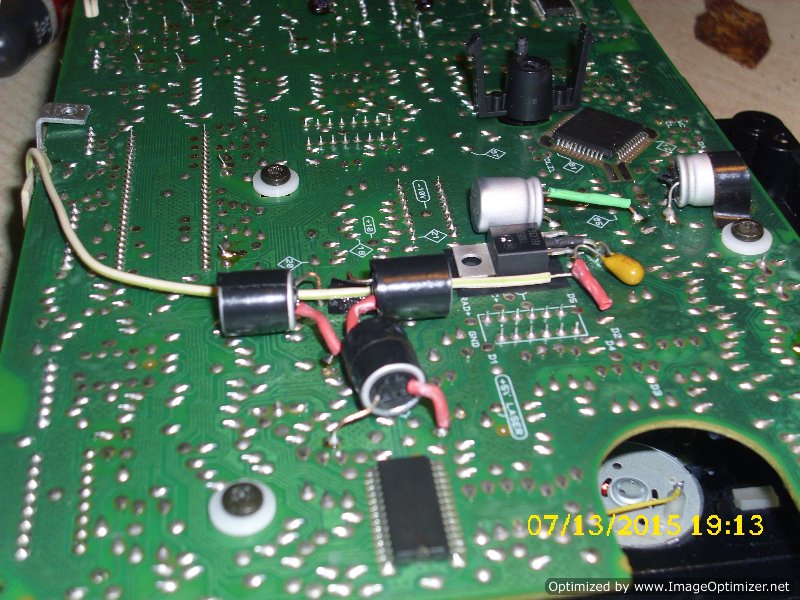

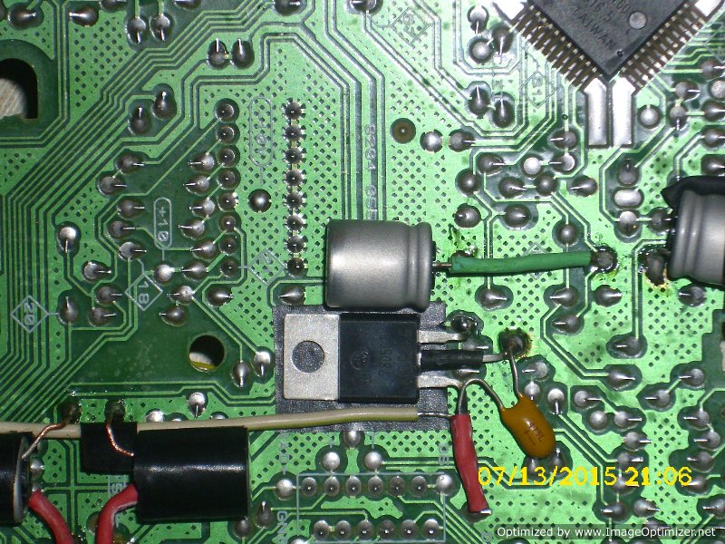

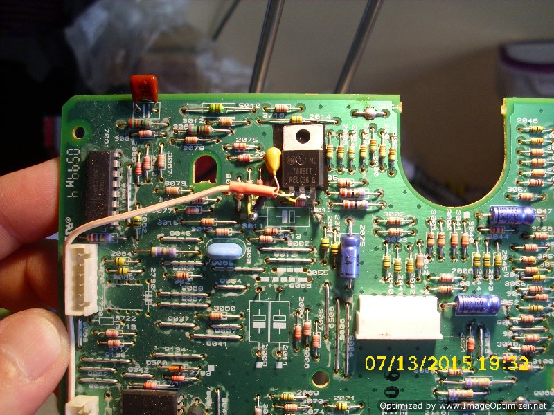

Hi Andrew, here you are 🙂
Attach some pictures from the TDA1301 and decoder regulators.
Here below is the technique I followed.
For the TDA 1301 things are simple. I removed the bypass wire 9066. It can be traced in picture 627. Then I removed the bypass capacitor 2013 and fit one Sanyo SEPC 470uF on the solder side (pic 625, 637). Then installed the regulator on the PCB components side (applying an isolation tape just in case) and using the extending legs of the new 2013 capacitor as posts to wire it up. A straight line cable from the PS capacitor + is providing the unregulated voltage.
For the decoder chip I've chosen a flat surface on the solder side of the PCB to apply the other reg (pics 625, 626) Hopefully the two power supply lines of the chip are placed very closed, at the common junction where the 2 resistors 3113 and 3115 are connected . I made a small cut to the thin trace carrying the 5V from the PS to above junction, then put on a small piece of isolation tape and install the regulator on it. The regulated out leg is directly soldered on the junction (3113+3115) , the ground leg to the closer plane and supply via cable, as usual... (pics 626, 635, 638) .
Feel free for any questions
chears, Andreas

Andreas thank you😀 - this is excellent and I'm already preparing to do the 1301.
I notice you also have the 9055 wire removed too - is that for something else ?
On the decoder chip I can't see or work out where you have cut the trace. Is it underneath the tape?
Can you explain where it is please ?
I have a spare board which I've been studying along with the service manual so I think I can do it once I know where to cut.
Looking forward to doing this !
Not yet tested...The smaller the size, the bigger the trouble ...![]()
Did you try this already ?
Looks like the work of a genius to me - you clearly know exactly what you are doing.🙂

Andrew, 9055 is a question mark to me also..It's not so long time that completed this mod and nothing reminds me that I removed 2 jumpers at that point. Studying again the Philips CD751 service manual, I concluded that 9055 should have been in place due to powering other TD 1301 gates and also peripheral circuits... I thing I'm getting old 🙁 Can you check if this jumper exists into your PCB and also to your CD48 SM? BTW the player reads and plays any disc, at the condition you saw it in pictures ..
Yes the trace cut for the decoder is underneath the tape. There's one only thin trace that carries the 5V voltage to the junction of 3113/3115. I cut it at the corner where is turning to get the direction to the power supply

In the attached pic Andreas it looks like you've created your own ground pad to connect the ground of the regulator.
I'm hoping that's correct because I don't have that pad on my board.
Did you scrape away the green insulation coating on the board to solder the regulator ground leg to ?
This is the only question now before I go back in and do this.
The powering of the TDA1301 looks simple enough and...wire link 9055 was already missing - you didn't remove it or have a bad memory 😀
That's the good news anyway !
I'm expecting BIG gains from this....this weekend then😱

Yes Andrew, that's correct! I created the pad by scratching the green coat.
I guess you have already found the thin 5V trace to cut, in order to supply independently the decoder chip. Big thanks also for the good news regarding that scary 9055 jumper
A small decoupling capacitor soldered to the input of each one regulator will guaranty the filtering of any noise would picked by the bypass cables and also helps the regulator to work more linear. Values from 1-5 uF tantalum or 10 uF electrolytic are more than enough . For the ideal setup you can add in parallel to above a bi polar 100-220nf polyester, Wima or MKP.. But I guess you already familiar with such setups.
Good luck with your new project!! I trust you will not regret it!!

Andreas - where you've changed the cap to SEPC on the tda1301 I can actually leave the original blue Philips axial cap in it's place and just connect the positive of the regulator to that can't I ?
I don't have any low esr specials left - which is a pity
Apart form that I'm ready to go and looking forward to it.
The problem is the more you've already done to a player the more you must remove to access the damn board - and remember how you did it in the first place !
It used to take only minutes to strip now it's probably 20 - slight exaggeration maybe but you know what I mean.
Tomorrow is also a good time to fit the 3 half watt 3R3 Shinkohs around the dac chip too - they may run cooler I suppose if the now available extra current bothered the smaller original resistors.
This is probably completely wrong too ( before someone tells me ) as I know there's no more current being drawn by the dac chip irrespective of the current available - but I'm thinking maybe extra headroom ?
Anyway they're just better resistors - and they're going in.
