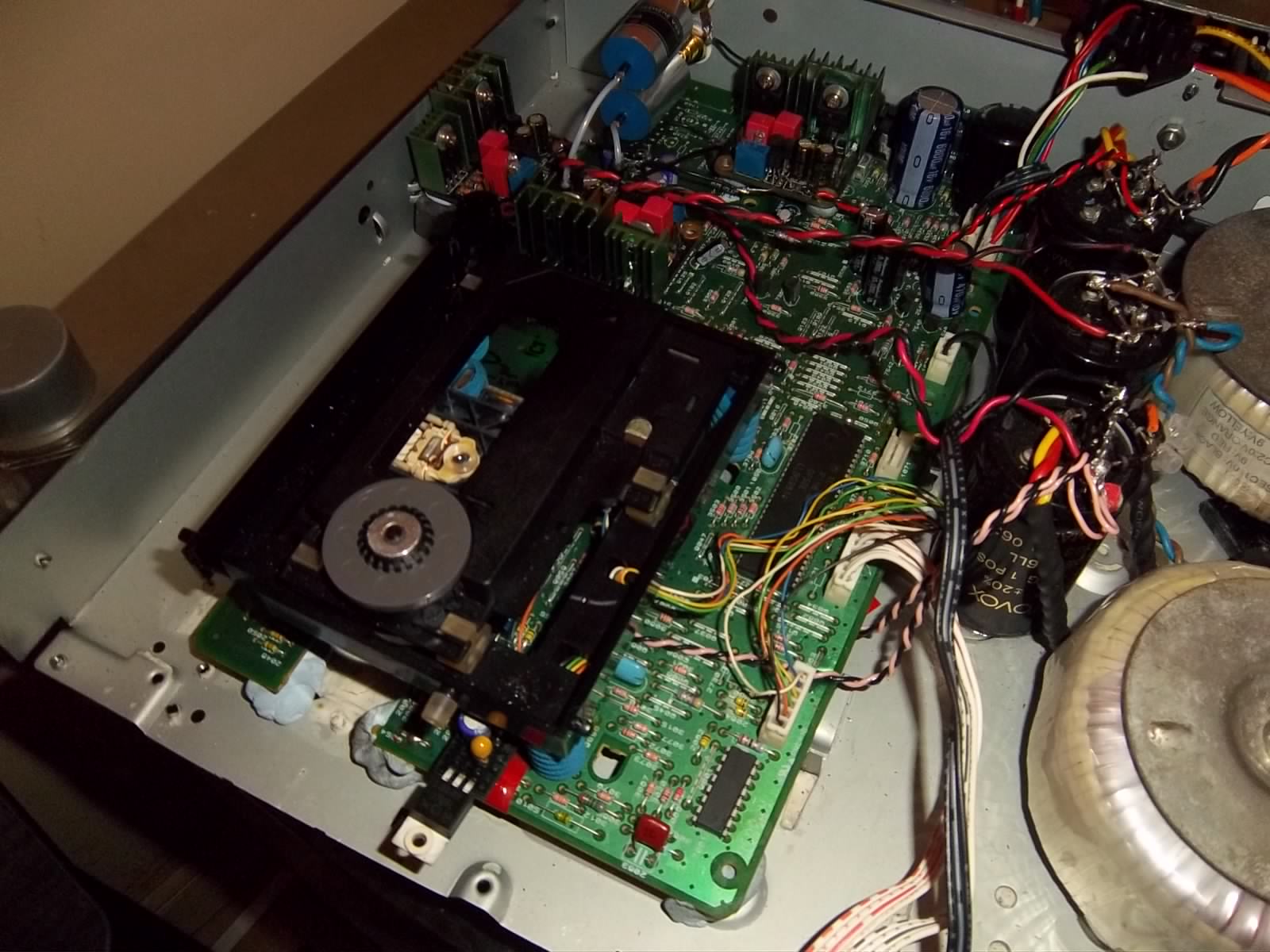

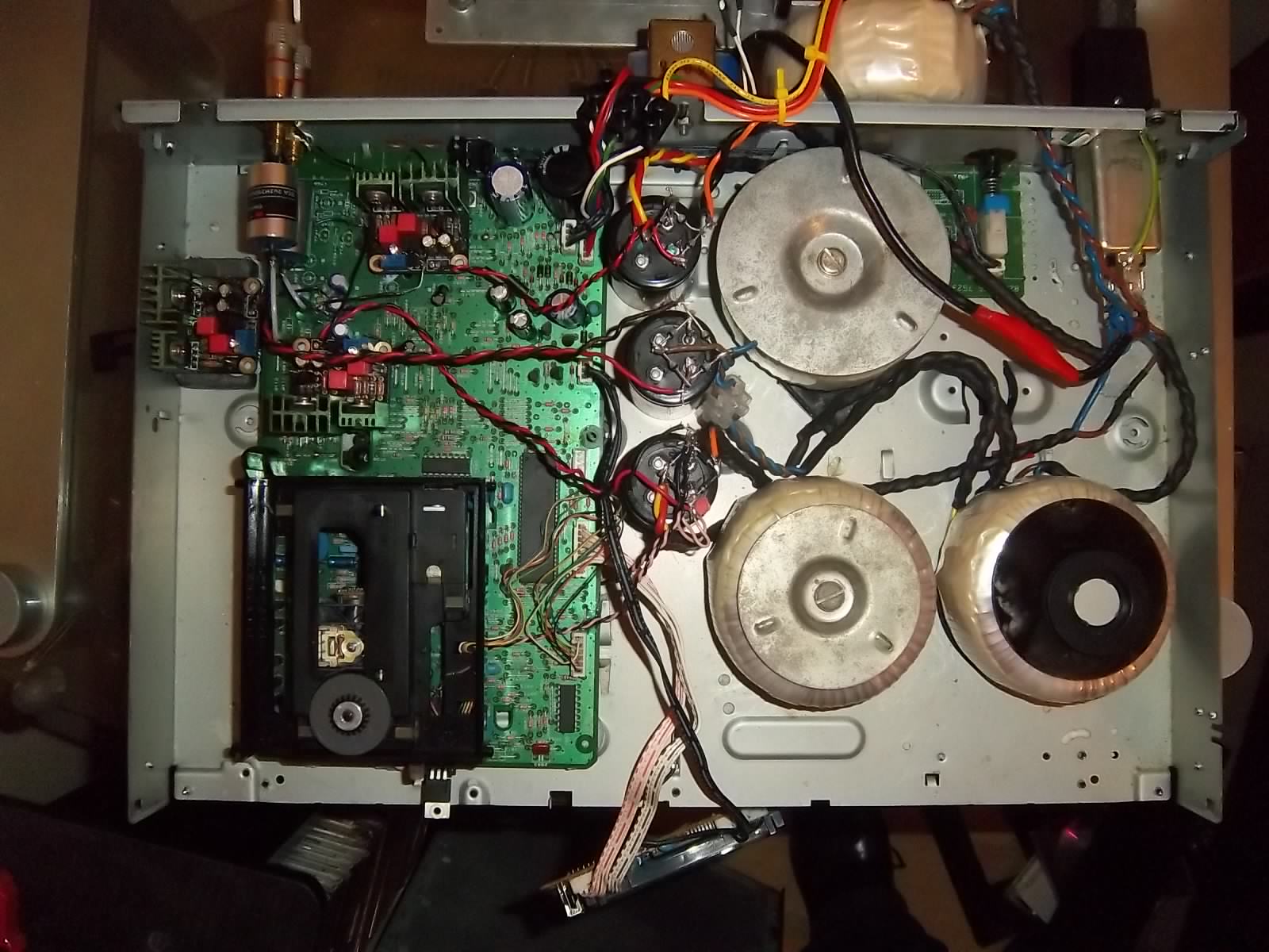

I already have smoothed and regulated 5v supply to the analogue, digital and i/v op amps and they even have their own transformer ( see my pics ) so power to the dac chip is very strong. I feed the new 5v x 3 straight to the 3R3 x 3 resistors which then carry it to the dac chip.

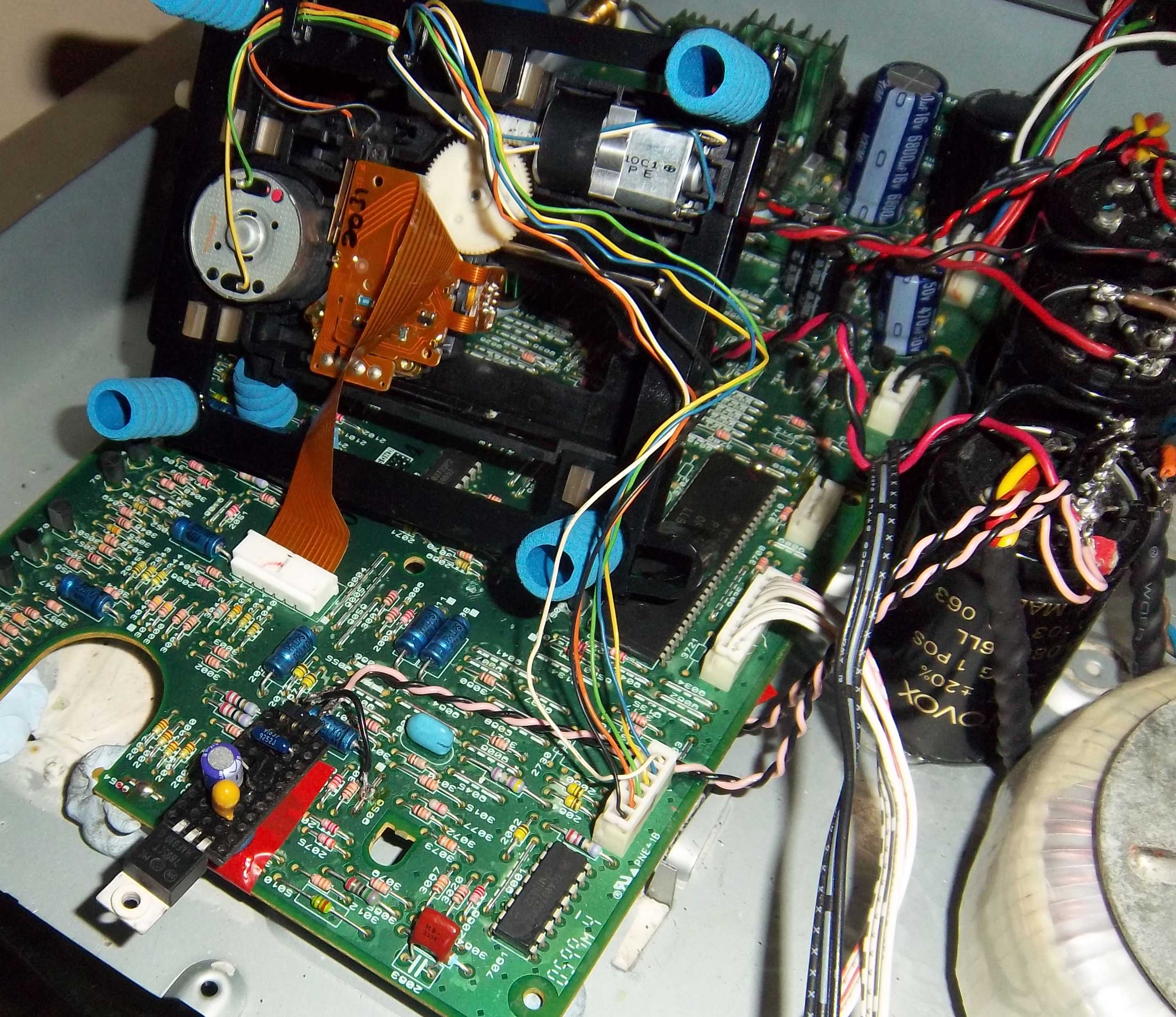

I've got a proper bc547 based teddy reg for the tda 1301 and a 7805ct reg for the saa7345 + tant and bypass cap.
Wires are twisted ( + ve and gnd ) and I'm almost there.
Wire to snip, trace to cut and then put it all back together again.

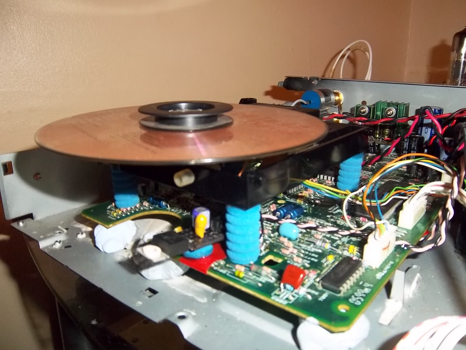

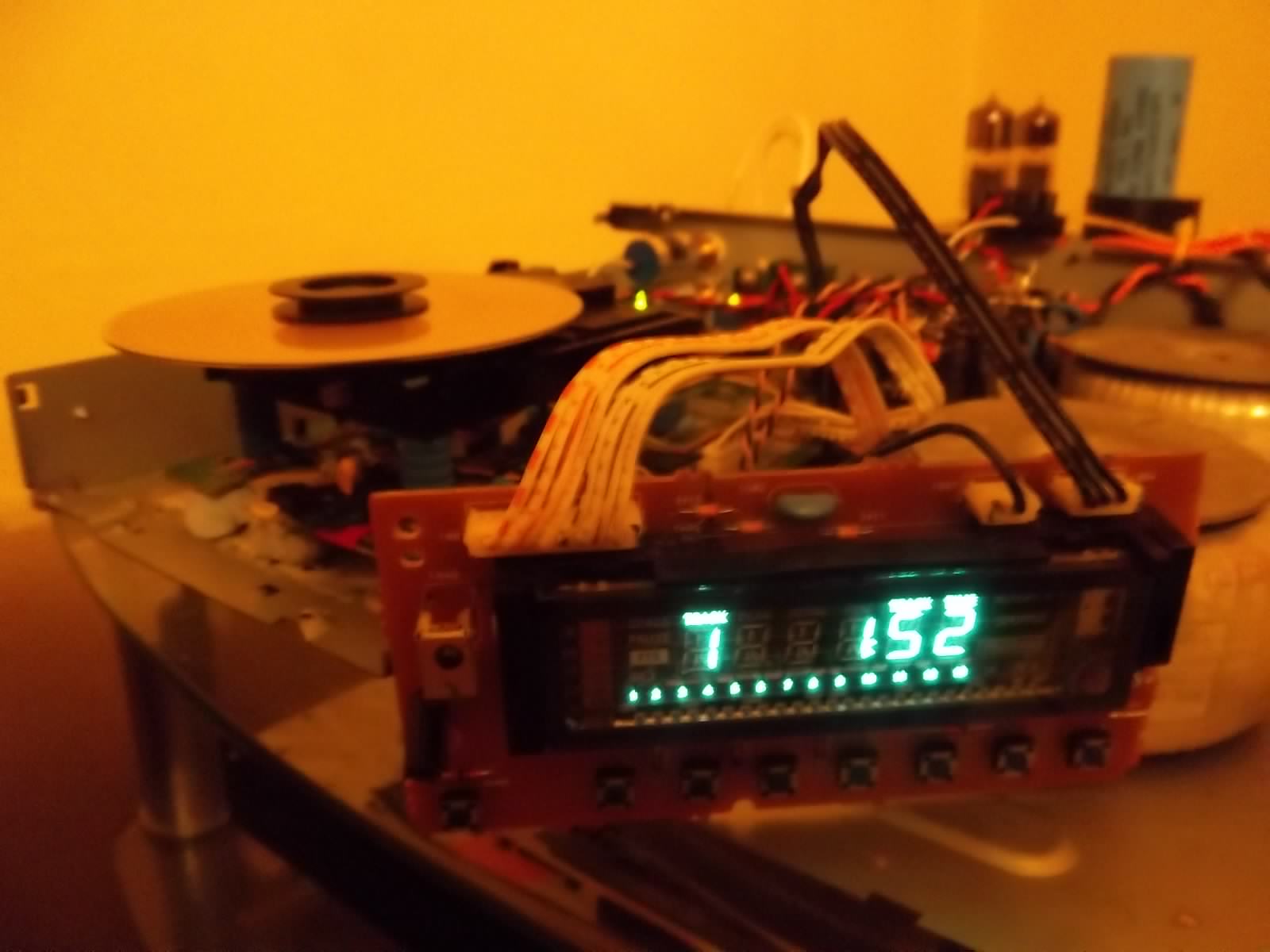

Another go - half the size this time

Nice job Andrew!! I like you got it further by mounting special regulators !!
It is a real upgrade for all players where I tried something like that.
I'm wondering what are those blue tubes at your laser mechanism assie? Are they something like suspension pods or..?

I guess suspension pods is a great name for them - yes that's what they are doing but it's a temporary measure while I build my new case.
The player sounds so much nicer now - smoother and full of body.
I can't thank you enough Andreas.

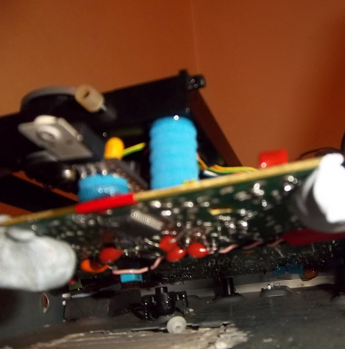

One from the underside....you can see the twisted pair going to the regulator, the orange tant and blue bypass cap.
The red tants are across the original philips axials only.
I did not take out the fusible 3R3 resistors this time - but I will eventually.
I was too keen to do the regs today.
