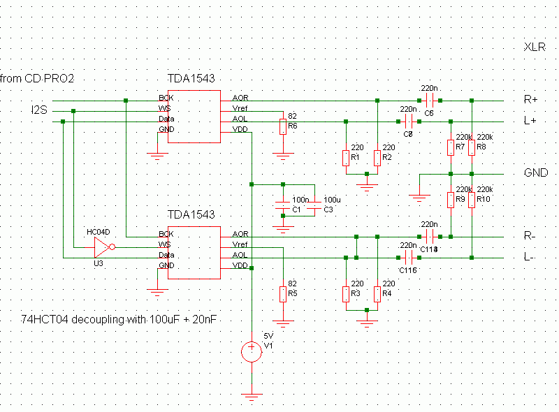

at the moment i run tests, with 2*TDA1543, stacked, data for one inverted with 74HCT04, no regs, only original germanium bench power supply. I/V with Rs, Rref 82R, Rv 220R. Need to look if it really inverts.

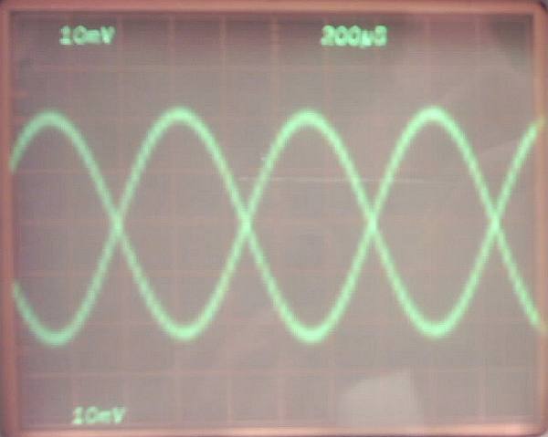

At the moment i play sinewaves and listen them throug a TEK7904....

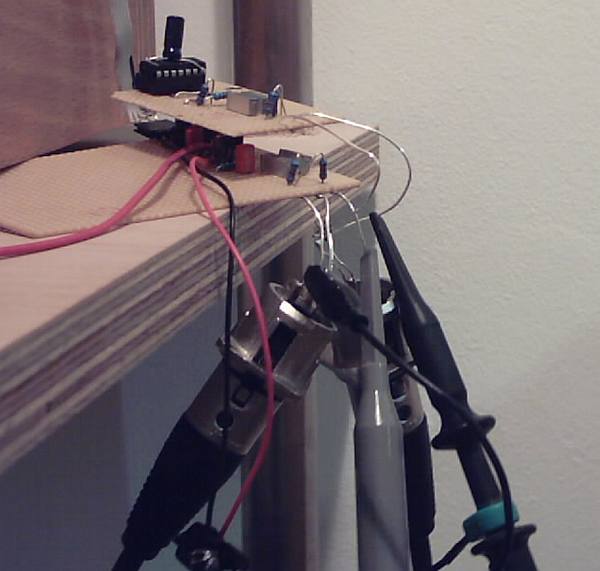

Hey, its a ugly piece of veroboard prototype.
signal 2 channels 1:10probe:
lower verobard (holes and stripes) connector for I2S, socket for DAC, decoupling, one Rref, passive I/V for + DAC, Dacs soldered together under upper verobrad, upper veroboard with 74HCT04, inverters decoupling, Rref, passive IV for - DAC
400mV swing is not much, 3 or 4 times this would be better

till said:some critics on the resistor values?

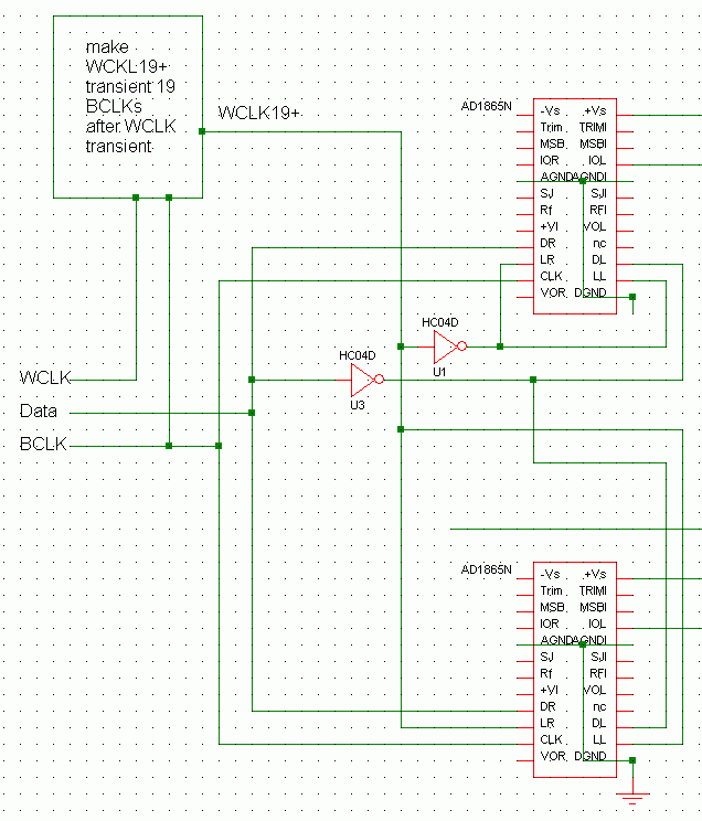

What is the point of inverting WS ?
wrong cut & paste, of corse data is inverted. I did cut the DAC from circuit in #19 and did not correct it before. Stupid mistake.
What i don´t understand is my resistor values i found by trial and error / listening.
Much lower than in all the circuits around with TDA1543. But it did not play with the high values, only very silent and lots of noise with higher values.

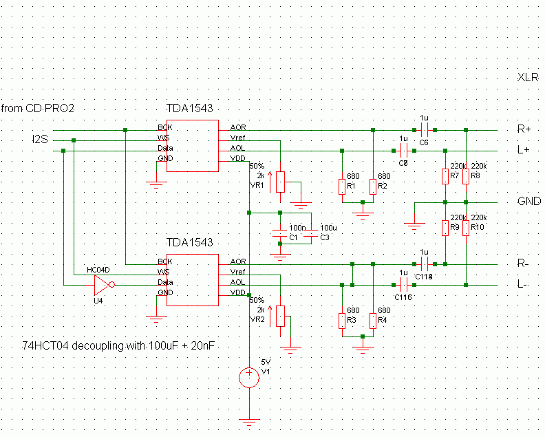

AOR and AOL are connected on the second DAC, I hope it's mistake on the schematic. If not, I think I know where your problem comes from 😉
of corse its a mistake, you know the summ of all mistakes is constant - at least if you post circuit diagrams in the middle of the night.
to keep all of you awake (joke) i make at least one mistake in each circuit posted - in #154 the connection of R- and L-, in #146 additional inverter in wrong line.
What is a big ??? are those resistor values. With those resistor values commonly seen around for passive I/V i have no good result. Very silent and noise. At 5V i have good results with 82R / 220R at 7,5V 1k / 680R.
I´m not really happy with passive I/V as i have not much voltage gain in my system (BZLS and ZEN 4) and voltage output of the passive I/V stage is not much. With higher resistors Voltage does not get more but less and noise. I have to look at D1 stage and order parts.

For the AD1865: what about making left justified from right justified by making a new Wordclock. A counter startet with transint of normal Wordclock, and counting 19Bitclcoks now, than making a transient for new Wordclock.
My impression is with the AD left right splitting will be easyer, i have more of them on hand than 1541, and i hope it will be better.
