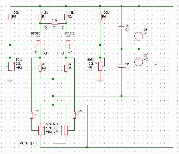

I build the following "D1 stage / 2 " and did tests.
Points marked "a" (sources) are trimmed with VR1 and VR2 to 0V.
With that stereopot i feed some current into the source, and measure voltage at points marke "b" and "c" (drains)
I get: With stereopot tuned for ca. 0mA :
b=13.5V c=13,6V
stereopot left: (+-3,25mA)
b=16,48V c=9,65V
stereopot right (-+3,25mA)
b=9,58V c=16,51V
given FETs are not matched and the stereopot may be far from beeing a precision device, i don´t see why this should work only with 0 to some mA. Why not also +- some mA?

Feeding this stage does not wotk by simply connecting the TDA1543. I cut the Ri/v resistors, but i think the DAC wants to drice a higher resitance than it sees with this stage?

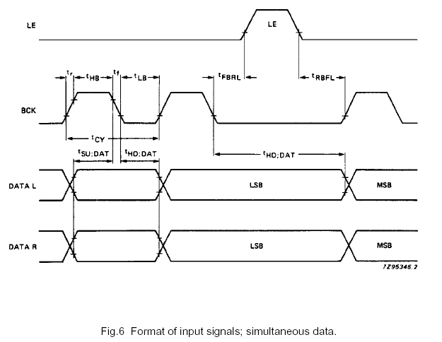

In the timing diagram the clock is interupted while the latch enable is high.
Is this a must ? Or did they draw it like this because at this moment the clock state is of no importance ?
Anyway, I guess I got it, will post in the morning, left channel with simple data line inversion for L-, mostly the same for right channel.

LLE should be used for both channels and looking closely at the timing diagram FRAME16,both LE signals and both SCK signals start one SCK cycle too late.
ray.

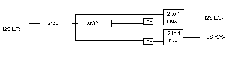

It certainly seems that way. So below is the outline of something a bit simpler.
The CD Pro2 outputs a serial clock of 48Fs.
But the 2*32sr would cut a 48FS signal into fragments ?
Is ensured the right and left samples belonging to each other by the LE managment not shown in your outline? or does it produce an offset between samples.

You could have taps at 24th flip-flop or use three 8bit shift registers instead of four... The input-select part of the mux is not shown and there is no offset between samples.
ray.

Ok, now I see what you meant before. The state of the LE signal doesn't matter because the clock will only clock in the correct data...
All those sigals (FRAME16, both LE signals, and both SCK) are
delayed by one SCK, and so is the DATA. All outputs get delayed
by one SCK...

Just had a look at the image you posted in Post #211.
I had thought about doing the same before, and with
48Fs data I was going to use 3 x 8bit registers, but I
counted up the number of ICs, and it was no less 🙁
Of course it is much more simpler...
