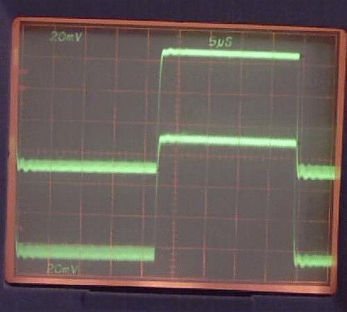

Since there are not that many people happy with GAL's i tried to
do without. So i took some stuff out of the GAL design (mute, choice of differential) and put all in normal logic.
This is just a quick drawing, could be with mistakes (check the clock)
In: I2S, out I2S +R/-R and I2S +L/-L
With:
1 HEF4517 philips
2 74F64
1 '175 FF
1 '74 FF
1 '04 INV
Dont look at the logic types, just used what i found first in the library. And i did not cleanup at all.
This thing should work, but if you are really going ahead here compare the (working) GAL based design with this to make shure.
AND CHECK FIRST IF YOU CAN GET THE 74x64
It a Four-Two-Three-Two-Input AND.OR.Invert gate
A GAL would replace those '64s and the INV. Chipcount: 4 😀
Just to give you some idea's 😀 😀 😀

Re inverting the LSB.
It is indeed correct that simply inverting the LSB is a bit of a hit-and-miss affair and as such my description of the added logic and what it does was incorrect. The circuitry in question is actually a bit-serial adder.
Err,Guido, it does not work. For a start the 4-input and-gate is clocked with WS and WS inverted which in practice means its output is always low. There is also WS delayed by a flip-flop clocked with inverted serial clock which causes a runt pulse in the data. But that can all be remedied.
What cannot be so easily dealt with from the CDPro2 point of view is that the circuit assumes serial clock is 64Fs. The CD Pro2 outputs a serial clock of 48Fs.
ray.
ray.

Some more reactions:
Till: the GAL could actually replace '64, '04 and the '175. 3 Chips remaining... I did nothing with the LSB 'issue' here.
WS is delayed with 1 BCK. To delay it more you could: use 4517 to delay it with 16 and two more '74 to delay it 1+16+2=19 BCK. But probably some form of counter on BCK is better.
btw, GAL's are small, they can be delivered by post...
I2S connector: no.
74F64 will be a problem. 4517 must be able to handle the clockspeed. Check the datasheet. Philips is 5MHz typical, so ok.
Bernhard, this is for I2S, so time multiplexed. So it should also work for TDA1543 etc.
Ray, 4-AND should be C,D,E,F which is /WS,data32,WSdelay,vcc.
This should be done with the 74F64's, the use of the second half of the 4517, the inverters and the '175 (a copy from the GAL content):
DATAR :=
WS * DATA +
/WS * SHIFT32 * WSDELAY +
/WS * /SHIFT32 * /WSDELAY
DATAL :=
WS * SHIFT32 +
/WS * SHIFT64 * WSDELAY +
/WS * /SHIFT64 * /WSDELAY
:= in GAL terms is registered output, clock low to high.
should be:
A * B +
C * D * E +
G * H * I
F = High, unsed and J,K = low, unused. But it was a rush job, so there could be mistakes in there.
Since the output is a NOR, i used the inverted outputs of the '175.
Remember, i just took the GAL content and put it into logic. The GAL version works, so this should work too....
The WS delayed is created by the two ff's both delaying ws by half a BCK.
One other thing is timing, i did not check if the '175 ff does the job as the GAL:
Quote from 2 TDA1541 post: "The clock from pin 21 is also used to latch the registered outputs of the GAL via pin1.... Registered outputs can be made registered by using ":=" in the declaration. This is used for data and ws (later). So the shift register and the GAL are both clocking on low to high. Strange? Well suppose the MSB just came out of the fifo, therefore it is available at pin6 of the GAL. It is also available at pin 9 of U6, the shift register.
Before clocking, the previous MSB will be in cell 32 of the register and available at pin10 of U6 and the MSB before at pin11. When clock goes low to high the GAL will therefore clock the MSB's: all is in sync. The logic clocks on the same clock, but some (in case of the 4517, many) nanoseconds later the data will be at the output pins. But then the correct bit is already clocked by the GAL.. Hihi. According to the databook, the holdtime after clock goes low to high is 0 nanosec minimum for the GAL. That's why this is possible."
This was just to show that it is possible to build a I2S splitter with logic.

The advantage of time multiplexed mode with 1541 i see is the SCK line for a precision clock for the DAC. This is lost with in the other mode.
But does the DAC output the sample for left and right channel at the same moment in time multiplexed mode? and if feed in simultaneously mode, but first one channel, than the other, (what i interpret rahs diagramms) , will the samples of left and right channel appear at the same moment at the output?
edit:
i measured time multiplexed mode with TDA1543 20kHz from test CD the samples left/right are absolutely in phase. (i wish i had a few really good scope probes)
with those I2S connector i will have a real problem. Maybe i need to buy a second CD PRO and tell Nico to send it with 10+ of those connectors.
edit:
till said:guido, so it looks like i have to build a GAL programmer
Do R+/L+ R-/L- or build a GAL programmer or use one of the schematics without a GAL or ask somebody who has a programmer to sent you a programmed GAL..
Plenty of options.
i think the DAC outputs left and right at the same moment for all modes. That will be in the datasheet. For I2S it should do this based on WS and for the parallel mode on LE (not shure, check the datasheet) 😱
Greetings,
First i will work on the I/V stage (D1 like) and start with simpel inverter. Time offset of 6ns is not much. Later i will ask you for a GAL. And i hope we find a solution for AD chips also. I hace 1865 and 1861 and i want to test them.
till said:The advantage of time multiplexed mode with 1541 i see is the SCK line for a precision clock for the DAC. This is lost with in the other mode.
Who says that it is lost ? It is still there.
I would be happy if the schematic posted by Rahul works.
I have made progress with my own also.
Will post it soon, is maybe more simple.
