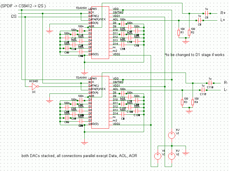

Nope,
I AM STUPID.
Just found the BB application note (have a hardcopy) again...
And i found this, after i could not understand myself anymore.. Wrote this (i'm R2D2 there) long time ago on AA (elso's link posted here):
Still the inverse of a two's complement number is "all bits inverted (done with the '04) + 1. Your LSB is NOT correct anymore.
Example with 4 bits: 5 = 0101, -5 is then 1010 (your inverter) + 1 = 1011 !
So you and Bernard were right about incrementing. My bad.
So my plan to 'find the lsb in the frame' is useless, since incrementing means other bits change too. So a small DSP is required, i guess.
Should have gone to bed long time ago...
Another thing to correct: I2S is specified as two's complement.

There is another problem IMHO
Again for simplicity a four bit word.
15 = 1111
-15 = 10001
We cut the first 1 and get 0001 which is 1 for the TDA.
That would not be good if 0 = 0mA and 15 = -4mA.

Bernhard, as the words are twos complement and the range of Iout is 0 to -4mA it must be like
1000000000000001 = 0mA = min (~ -32767)
and
0111111111111111 = -4ma = max (~ +32767)
0000000000000000 = -2mA = 0
The TDA doe not need to know that it is negativ, he only needs to be feed with symmetrical words. Onwe channel with the sample and the other with the inverse. The original sample may be positive or negative by itself depending if it is from the + or - halfwave of waveform.
guido, i´m glad this is sorted out. So we need a descision in the next days if we find a simple and new solution or have to look for some Processor.

From the appl note.
For bit exaples with Vout. BTC coding scheme:
-full scale coded 1000 V=-5.000
-full scale + 1 lsb coded 1001 V=-4.375
-0.5 fs coded 1100 V=-2.500
-1LSB coded 1111 V=-0.625
0 coded 0000 V=0.000
+1LSB coded 0001 V=0.625
+0.5 fs coded 0100 V=2.5
full scale coded 0111 V=4.375
So inverting full scale brings 1000+1=1001.
That is one lsb next to -full scale, V=-4.375
Inverting -full scale (1000) brings 0111+1=1000
So the rule invert and increment +1 is fine, except if the
data going in is -full scale. Guess that happens not so often😉

Had some thoughts after last nights "session". So how bad is it? We are one lsb off all the way:
-8 1000 -> 0111 = +7
-7 1001 -> 0110 = +6
-6 1010 -> 0101 = +5
-5 1011 -> 0100 = +4
-4 1100 -> 0011 = +3
-3 1101 -> 0010 = +2
-2 1110 -> 0001 = +1
-1 1111 -> 0000 = 0
0 0000 -> 1111 = -1
+1 0001 -> 1110 = -2
+2 0010 -> 1101 = -3
+3 0011 -> 1100 = -4
+4 0100 -> 1011 = -5
+5 0101 -> 1010 = -6
+6 0110 -> 1001 = -7
+7 0111 -> 1000 = -8
So the neg signal is like the positive with 1 lsb 'offset'. A 'dc' component on the waveform. Not to much to worry about, the 1541 already has -2mA offset already. Does not really matter if its a few nA more.
New statement:
Is is better just to invert and be 1 lsb off than to follow the rule
and go wrong with -FS.
One negative thing i can think of is that a dac would be made to be most linear at 0. Now zero is at -1lsb which could be less accurate. 😕
Good luck with your dsp!

If the LSB error only gives an offset, you have 2 solutions
-have caps at the I/V's output, or at the amp's input
-live with it. After all, on a 2Vrms output, it's only 43µV

The offset is already -2mA before the i/v. So you need to
compensate for this before the i/v or build a i/v circuit that can handle this. As discussed earlier (pass D1 / PCM63 / pedja's dac) here.
The 850 uses bitstream dac's. Better example is the
marantz cd7: two tda1541 S2's in diff mode. Two big dsp's to feed the data, but those are also for oversampling.

The proble is see isn not any offset, all the I/V stages ( resistor and Pass) are capacitive coupled. I also doubt the D1 stage has problems with the 2mA offset, but this would be no prob to solve.
What i want to know: is simply inverting instead of true inverting a word with real 16Bit infomrmation, or is there information lost?
In case its a real 16Bits word, why do we need anything more than one inverter / phase splitter?
The 2 DACs only need to connected to PS is same way, what about stacking them and only separately connect the pins necessary?
In this case i can´t see need for logic chips. PALs etc, and #40 should simply work.
