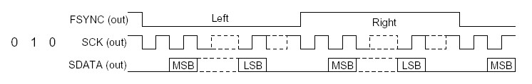

Fsynk is WS and its low for the left channel word and goes high one bit before the MSB of the righ channel word starts. Then it goes low again one bit before the next leftchannel word starts. There are more than 16 bit transmitted in each frame the WSis high (low). There are as posted somewere before 32 bit transmitted, but the number is not of interest for us. We only need the 2nd to the 17th as this are, MSB first, our 16Bit containing the sample. The others are garbage.
As i understand until now.

till said:Fsynk is WS and its low for the left channel word and goes high one bit before the MSB of the righ channel word starts. Then it goes low again one bit before the next leftchannel word starts. There are more than 16 bit transmitted in each frame the WSis high (low). There are as posted somewere before 32 bit transmitted, but the number is not of interest for us. We only need the 2nd to the 17th as this are, MSB first, our 16Bit containing the sample. The others are garbage.
Okay, FSYNC low left, high right.

Back to correcting the LSB, i'll try to explain. If you feed my design with 16 bit words it is very easy: We have WS toggling at LSB. Thank god for that!! Delay with one ff as i have done and you know where the data is. Now XOR WS and WSdelayed and you have this:
MSBXXXXXXXXXXXXXLSBMSB data
1111111111111111000000 WS
1111111111111111111000 WS delay
0000000000000000111000 WS XOR WSdelay
So you have a 'marker' for the LSB. That can be used to not invert data if this is high. Since the data is 16 bit now, the shift register needs to be two times 16 bit. So the connections to the 4517 should not be 32 and 64 output, but 16 and 32. Minor cut and
a small wire.
I will have a look at some receivers to see if i can find one that works with 16bit words i2s out. If it exists, i will use it and correct the LSB error.
And again, a nice programmable cpld can do this easly with 32bit words...

This is very difficult to understand without seeing the design.
But still:
Why shall only 15 bits be inverted ?
guido said:copy/paste the timing diagram into notepad.
makes more sence then....😉
Which timing diagram ?
