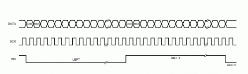

So when offset is connected like D1 (check the schematics) you get +2/-2 on the i/v circuits. The TDA1541 does not have the +2mA offset pin, so you put 0/-4 on i/v ciruit. Q is can it handle it?
Answer: probably not, otherwise the D1 would not have the offset pin connected (?).
Not inverting the MSB is a bit difficult, since it is in the middle of the dataword. Remember this is 32 bits. One easy solution i see for my DAC: find a spdif receiver which outputs i2s with 16 bit words (dont know if there is one, i'll have a look).
This would but the LSB just before the MSB of the new dataword.
I have WS and WSdelayed. XORing them would give me a signal which is low, except for the time when the LSB is on the dataline!
I can then easily reprogram the GAL to not invert the dataline if (WS XOR WSdelayed) is high. However, the shiftregister i use has to be modified from 32+32 to 16+16. That's a hardware change...

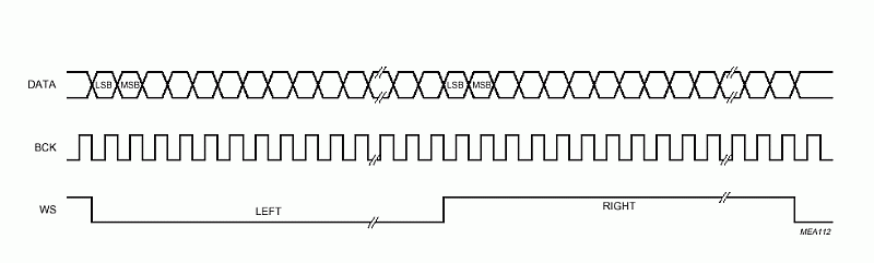

The +-2 or 0 to -4 mA problem should be easy to solve in the one or other way.
For inverting the dataword i don´t see why inverting all but the MSB is the right way to the inverted word. If these words are twos complement formated inverting the sign would be inverting the word and then increment by one.
2nd picture in #51:
-2. = B'11110'
INV(11110) = 00001
INC(00001) = 00010
B'00010' = +2.
This made with logic ICs i can´t do. I would need software. Or some kind of logic chip i can program like software.
The device desired looks for me like : serial I2S clock into device, now we have 16Bit words. Invert a copy, inc the copy, clock serial out the noninverted and the inverted with a stable isochrone SCLK at the same phase to two DACs in the format they DAC likes.

Let's see if we can easilly invert the SOny format.
If I remember correctly, it's an unsigned format. So for a 16bit data, 32768 means zero

first picture.
description here http://www.diyaudio.com/forums/showthread.php?postid=341183#post341183
we don´t add one bit, we need to invert the words by first step: invert it, second step, increment it by 1. Its still a 16 Bit word now. The 17th bit is truncated --> example inverse of 0. = B'0000000000000000' would be B'1111111111111111' now we inc (B'1111111111111111') and because we truncate result is again 0. = B'0000000000000000') works for all other values also, check http://www.diyaudio.com/forums/showthread.php?postid=341156#post341156 picture 2
The words are marked by the Wordclock, but to make things not easy god made the word not start at the WCLKs transient but one bit later. Word is bit 2 - 17 of 32 bits, the others are garbage. Bit 2 in one frame of the WCLK is MSB.
I hope this is correct.
