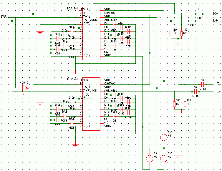

Why did this one use Inverter on Data and Fsynk?
The difference would be, in his Retro- Dac he uses one AD1865 for L +/- and one for R +/-, whereas this would use one chip for L/R + and one for L/R -. What are advantages/disadvantages?

The picture you posted hasn't a DAC for L+- and one for R+-
Each dac has L AND R, one has the + the second has the -
Thats what i said.

but inverting the dataline (-> havine one dac for r+ l+ and one for r- l-) is a far more easy solution. At least for I2S signals.
Using Xor gates is better than the inverter
I don't precisely know the audible effect of time differences between the non-inverted and inverted signals, but they can be simply preventd by using xor-logic for both signals.
Connect L and R to each input of a separate XOR-gate (74ls86)and connect the other input to 0 (you get L+ and R+). Mirror this solution but connect inputs to 1 and you get L- and R-.

So the point is phase difference between the Data and INV(Data) is not exactly 180° with inverter in one line? are there high speed inverterts?
Or what about a unity gain phase splitter (one transistor) or a differential pair instead of inverter?
You can probably split the datastream with anything. In the general scheme of things I doubt that it adds up to much, though I am sure there are those who are certain to claim they can discern a difference between a circuit with the inverter and one with the xor while at the same time overlooking the lack of LSB inversion.
The idea behind using one dac for L and L- is that any noise generated in the dac common to both channels is rejected when the outputs are summed.

Would this work?

As Ray pointed out: inverting the dataline is not a 100% inversion of the signal. The correct procedure would be : invert bit 2 to 16, but do not invert bit 1 (LSB). So by inverting the dataline, you're one bit off.
You have connected the i2s signals incorrect to the tda
In one of your previous posts you connected 180 i/v resistor to the tda1541. That is way too high, i'll get distortion. Check some posts/designs.

The second circuit should work giving +(L/R) and -(L/R) and datasheet covers OB/TWC. BTW, OB is for simultaneous mode only.
The first circuit will not work as the data is I2S. Multibit AD dacs are LSB justified. I2S is MSB justified to 1 serial clock cycle after a L/R clock transition. If the format was correct, there would be an interchannel delay of 11microseconds.
IHO, the easiest way to get +-R and +-L would be to convert the I2S to another format, that uses different lines for L and R
Then, simply feed the DAC with digital L (or R) at one input, and inverted digital L (or R) at the other input

second circuit is posting #32 and first circuit posting #31, right?
so at the #32 circuit i have to look at this -2mA / current source problem.

Is this better or still wrong? #40
- I don´t understand / find this current source issue in D1 circuit, some hint?
- What abaut TDA1543, same problem when I/V with D1 stage?
