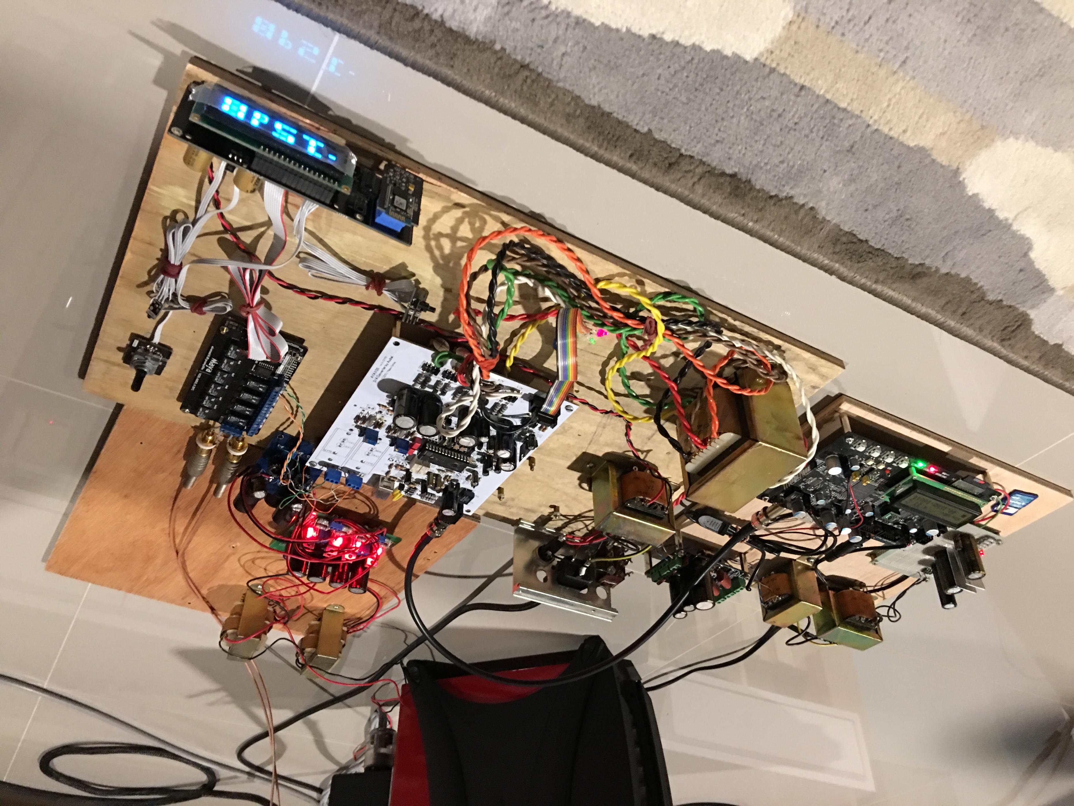

Not so complicated, most of the parts are power supplies.
DAC parts:
- I2S receiver (since I2S signals are provided from external source)
- Ian's FIFO buffer with singlo XO board
- TWTMC Driscoll oscillator with SC-Cut crystal and oven
- Ian's I2S to PCM converter (to feed the TDA in OB symultaneous mode)
- Red Baron
- passive I to V converter with Rhopoint resistor
- AIKIDO with 6N23P as gain stage and buffer
PS:
- TWRPS-pp for Ian's stuff
- TWRPS-pp micro for the oscillator
- Salas shunt for the Red Baron
- on-board AIKIDO PS
- all R-core transformer

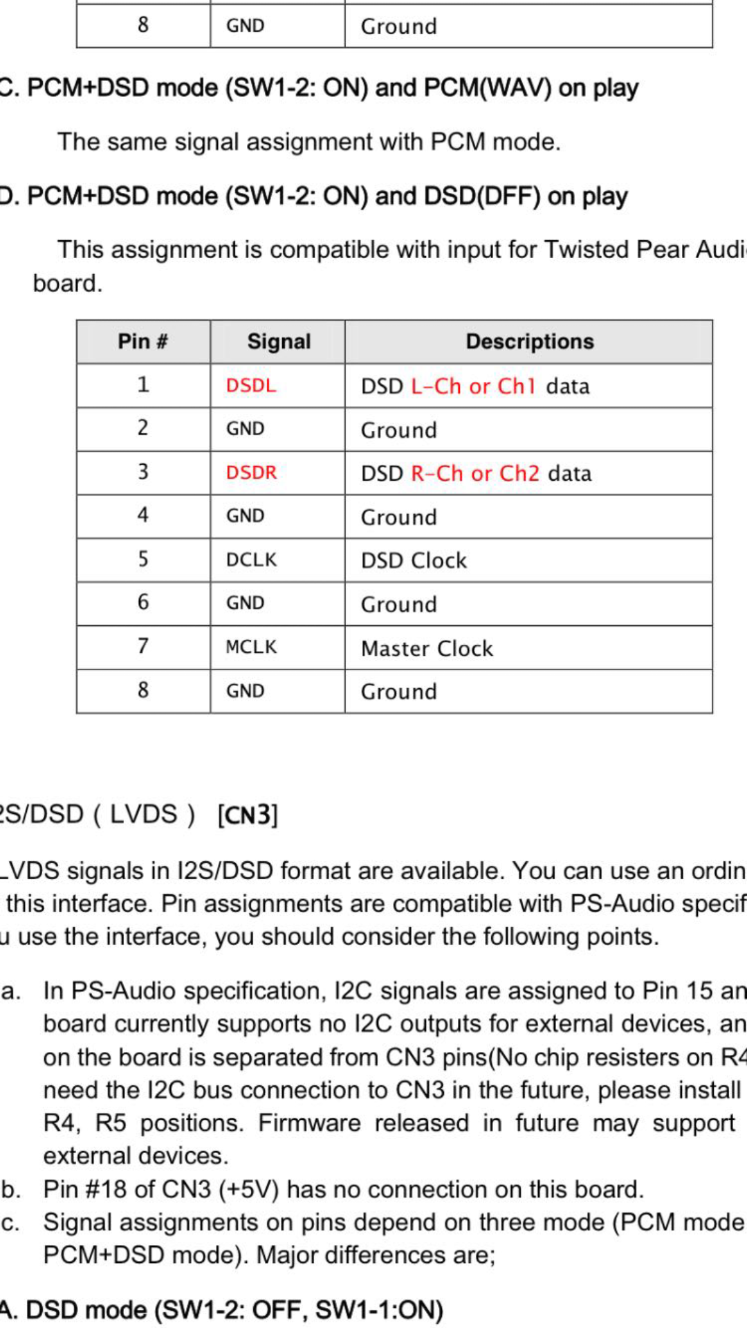

You definitely will...a hugh improvement ...not only i2s...it also has pcm output! Just connect them to pins 1 2 3 4For now

Thks CFT let me go dig out my Sd trans manual
& study. Is pcm connection better then I2S sq
wise ? Sounds like a more direct approach ya
Thks again
Absolutely....
https://www.audialonline.com/topics/tda1541a-and-model-s-usb-part-2-simultaneous-data-mode/
And thats why Pedja is offering a usb to pcm board, and Ian also kindly making those i2s to pcm boards available for us.
PCM mode is incorporated in ryanj's design as well.
Sorry CFT im lost is there a need to use Ian's I2S to PCM board
or are you refering to another source rather then the SD Trans ?
Btw what sort of cables is best to connect PCM from Sd trans to
Aya & is it sensitive to lenght ? Yes I've read Pedjas blog on that
but forgot all about it & also wasn't aware of this PCM mode of
connection.
Thanks from for the advice

Aaah very observant. It's a Buf 03 in mono mono config
Actually this buffer is to be used in my half completed
hybrid Hypex Oem module.
Thanks Jaffie.. It looks like the buffer is wired directly to your passive linestage at the moment. Good luck with your projects.
