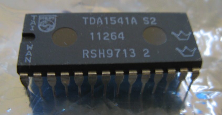

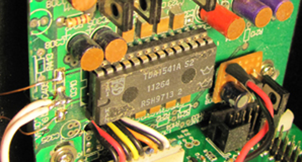

Hi Ludwig,
So sorry my chips strangely have no markings on country of origin
but the minute you play them you'll immediately hear the difference.
S1 , S2 sounds much closer but much more refine or should I say
polite in certain ways
No labels?.. hmm
LH/S
Hi Ludwig,
You can decipher the date and place of manufacture and using the serial number. Follow this link and scroll down to the stamp coding section:
Philips TDA1541A d/a converter - DutchAudioClassics.nl
