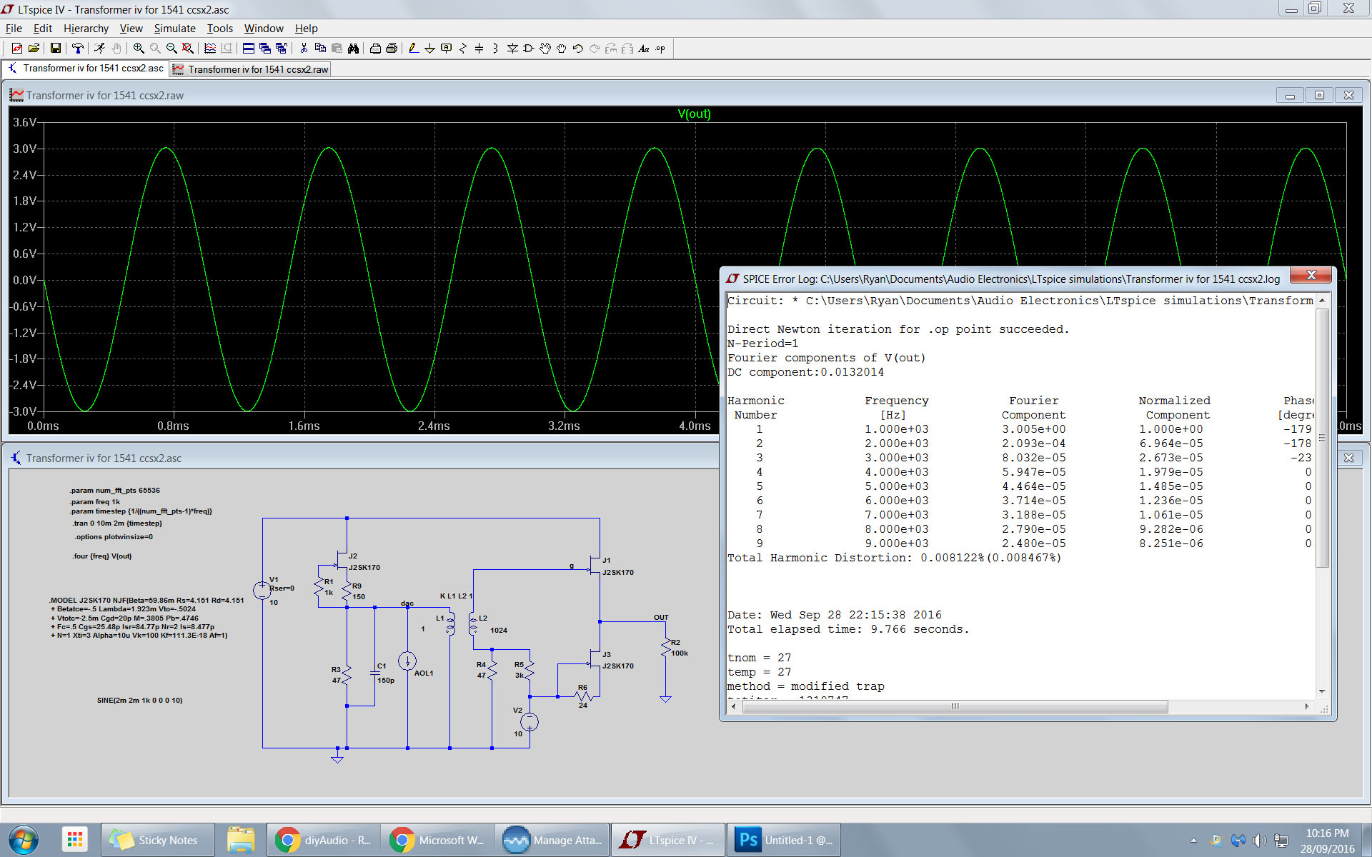

Since we are on the topic of output stages, i've attached a circuit that uses a Lundahl LL1678 using 1:32 turns ratio option. It has a CCS for TDA1541A current offset, a source follower for the current gain after the transformer. THD simulates at 0.008%. No where near as low as the CEN/SEN though, maybe worth trying, I have not tried this circuit yet.

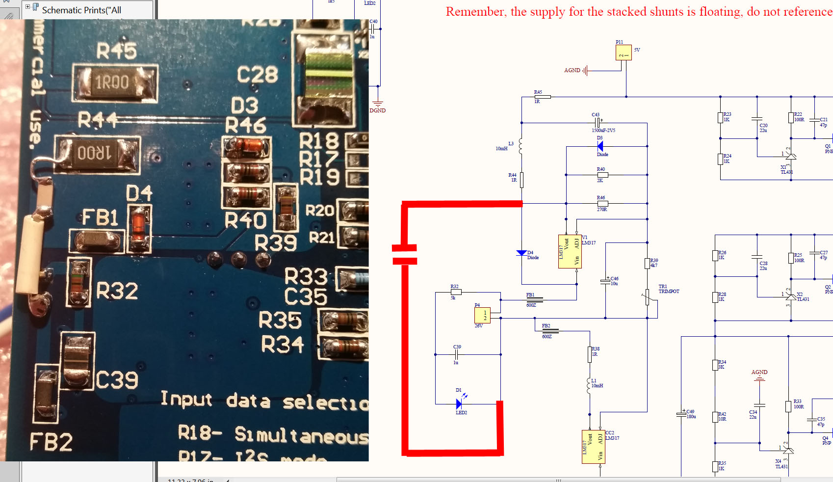

Hi Guys,
I've assembled another PCB today and ran into a stability issue.
If you run into the same issue just remove and short the pads of L3 and replace R44 with 10R instead of 1R.
Sorry for the inconvenience, at least I ran into the problem first, and its an easy fix thankfully.
It's strange that this didn't show up before.
I'll update the schematics and include this mod.
Ryan
Hi Gary,
Your welcome.
The first thing you will notice is very low current draw of about 10mA from the 26V supply, and as a result very low output voltages. Once I started probing around I found the output of V1 was oscillating at 6.2meg.
If you do get this problem, replace:
L3 with: WSC452710R00FEA -check footprint size with MSS1210-106KEB, as I havn't tried this yet, but looks like it will fit up fine.
R44 with: CRCW25120000Z0EG
L3 + R44 should equal around 10 ohms to keep the circuit at the correct DC operating points.
Good luck with your build Gary.
Ryan
If you do get this problem . . .
Ryan,
I wonder if the problem might also be solved by putting a small capacitor right at the output of V1 (LM317). The datasheet recommends at least 1uf from Vout to ground. The current schematic has a big capacitor (1500uf) but it's isolated by L3. Admittedly putting in the extra capacitor is harder since there isn't a convenient set of pads for that. Just thought I'd throw out an alternative that would let one keep the inductor in place.
---Gary
Ryan,
---Gary
Hi Gary,
Thanks for the tip. A 1uF from V1 out to ground certainly did the trick. It also works the same with 1uF from V1 out to the negative of input supply.
At this point I just have to laugh at myself, heres me worried about noise from an LED and putting 1uF across it... LOL
Thanks for having faith in a total amature guys!
Ryan
Photo of mod.
Hi Guys,
Just thought I'd upload this photo to show how to fix the oscillation issue if you come across it.
I used a 100nF (C3216C0G1H104K160AA) from V1 out to the negative of the 26V supply.
