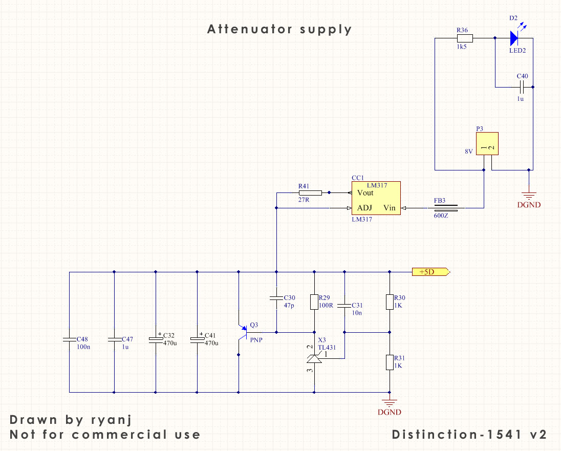

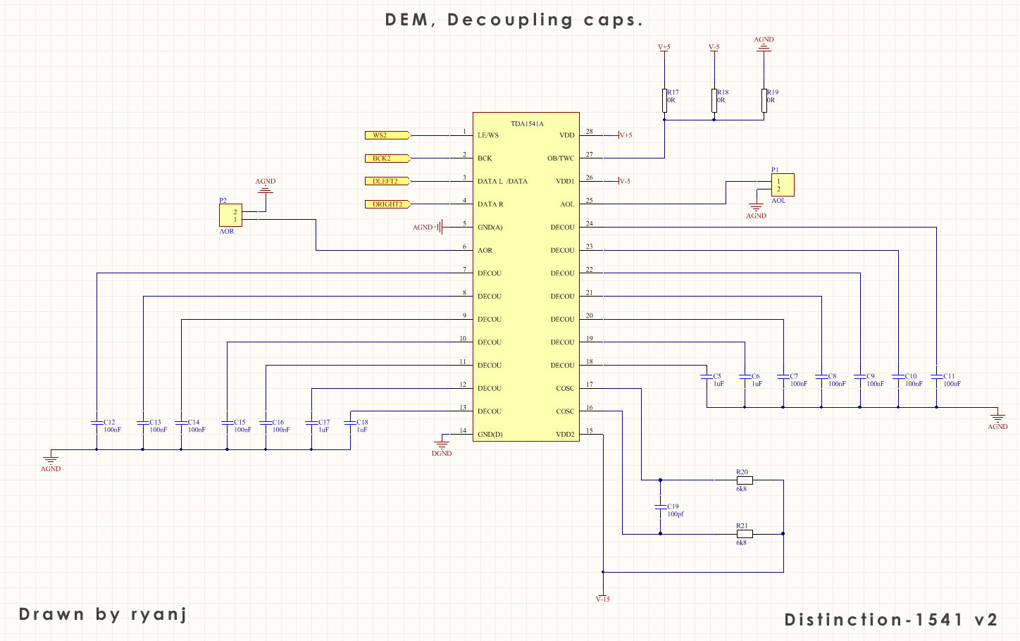

Schematics
Hi All,
Attached are the schematics for what I have on the Distinction-1541 v2 PCB.
Ill post the Attenuator schematic soon.
PDF of full project schematics will be made available at a later date.
BOM will be posted soon.

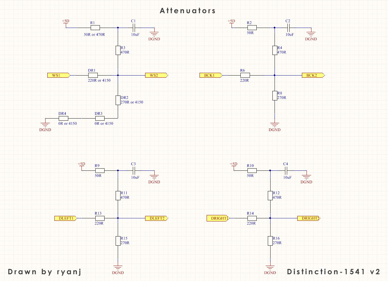

more schematics
Attached are the attenuator schematics and DEM, Decoupling schematics.

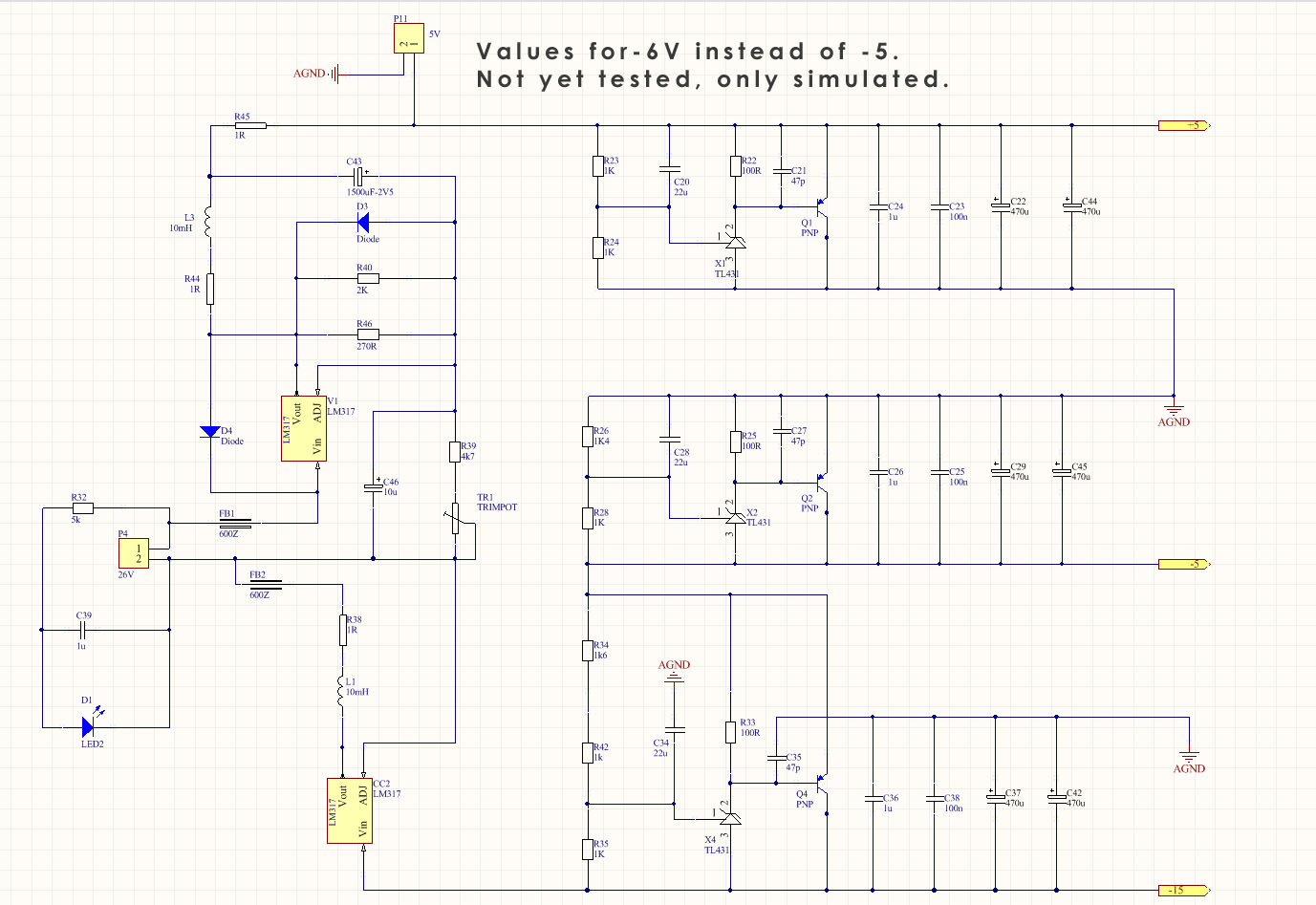

Alternative values in schematics.
I Attached schematics of alternative values to obtain -6V instead of -5V as was done in some Philips players.
I have not tested this approach, I should though, its only 3 different values.
R26 from 1k to 1k4
R34 from 3k to 1k6
R42 from 10R to 1k
I'm not sure what to expect from this variation, anybody had experience with -6V instead of -5V?

Thanks for sharing! I imagine you did some simulations to optimize behavior of the TL431 circuit… also some practical testing somehow?
What part do you use exactly for TL431 (X1) and Q1 in SMD?
Hi Berny,
Your welcome.
The simulations I performed for these circuits were of great help and played a very integral part in the design. Compensation caps and unity gain caps were used to improve specs. I was lucky enough to have the guidance of some great teachers and engineers on this forum, one in particular was very helpful.
My practical testing was limited by the testing gear I have. Aside from probing around with a scope and doing some FFTs on basic hardware/software, there was not to much else I could do. I will eventually invest in better test gear.
Listening sessions for me always helps decide whether a circuit is good or not. I know that in the engineering world this is considered inaccurate - for a multitude of reasons. But you can't measure how enjoyable a listening experience is with electrical testing gear (that im aware of). There is always blind testing etc, but personally I still find it helpful just to listen. Plus that's most of the fun of this hobby - listening to your circuits with your favorite music to see what's changed.
The TL431 im using is NCP431 from ON Semiconductor and the PNPs are PZT2907A also from ON Semiconductor.

Hi Ryan,
Thanks for the elaborated answer, you listened for a difference with or without the 22uF caps (I suppose these are the unity gain caps you mention)?
I'm using a diy AYA dac and it doesn't use this kind of caps...

Hi Berny,
In my simulations a 22u cap provides an output impedance of 2mohm at 22hz. Without any cap is 3.6mohm at 22hz. ~45% lower. The 22u PMLCAPs from Rubycon that are used in the circuit for AC gain look like they are some of the finest quality parts available, which should mean lower distortion in the audible freq range. The pads on the PCB for these caps could easily facilitate a substitute.
