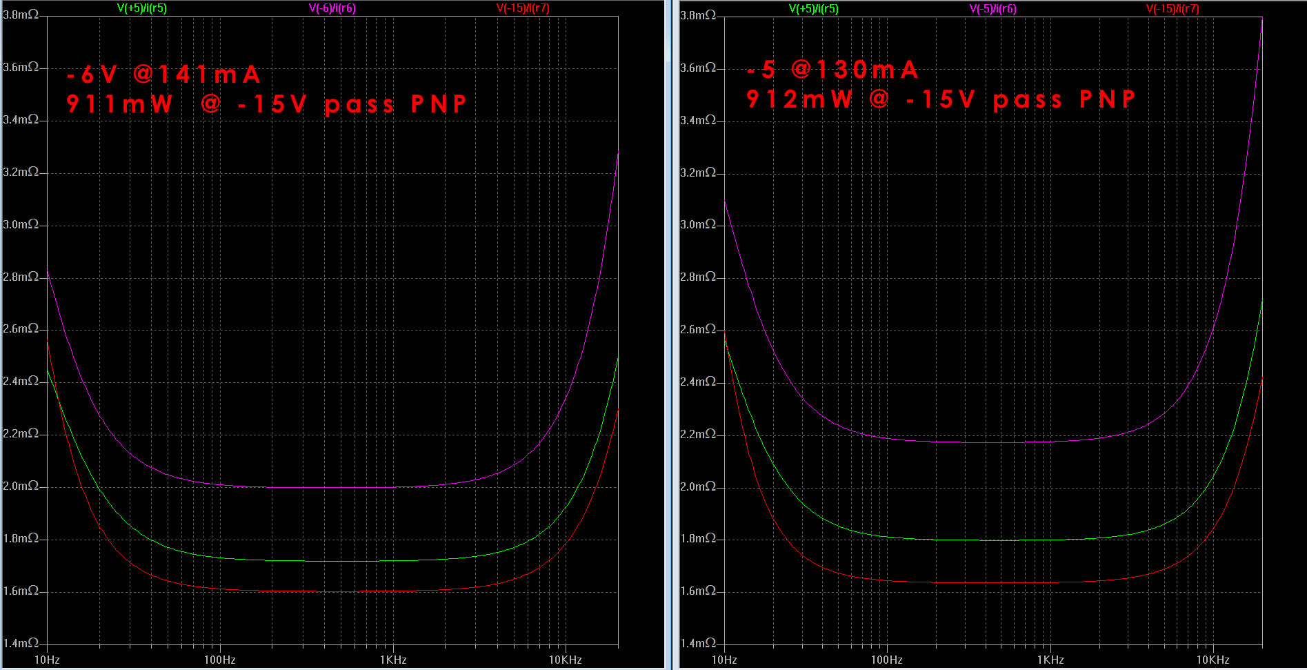

Quick sim
Hi guys,
Just thought I'd share this simulation to compare the two circuit scenarios of -5V and -6 within the zener string stacked supply.
I mentioned this a few pages back but now i've upped the current to match the heat dissipation off the pass PNP for -15V (main circuit restriction) when operating with -5V to demonstrate there really is no downside to this -6V config, although input voltage to the supply should be no less than 26.5V instead of 26V.
cheers
