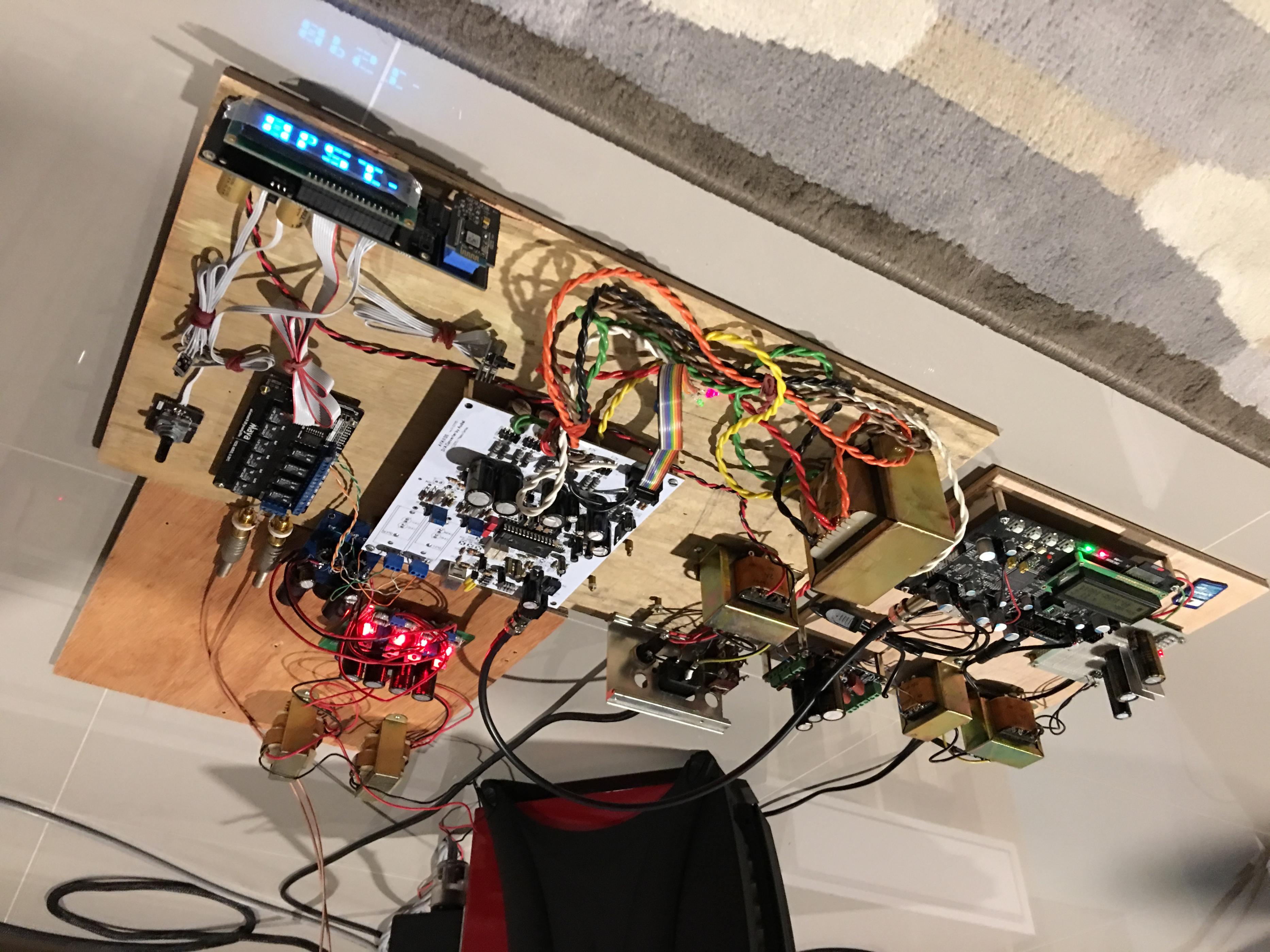

the S1 sound wonderful on my tweaked AYA
BTW Luke pls build the Aya as is & tweak from there
My way is to direct Aya direct with passive pot or
whatever passive device you choose. Once your
satisfied then you can connect to a preamp of
your choice. Reason for doing this, you don't
want the pre amp to affect the sound of Aya
& misguide you in optimising its performance.
Besides it'll like you hear if changes that you
make is in the right direction.
For me it's a really tuff job cause I listen to
all kinds of music & this makes it a very slow
& long process in tweaking.

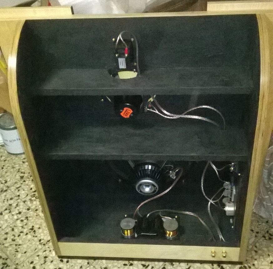

Hi Eldam,
the mid is the L CAO Alnico FA8, it's an 8 inches chines full range that sounds very fine. The tweeter is the ribbon Harwood UR 2.0, the same of Aurum Cantus G2si.
I'm building this system for a friend, the sound is very balanced and never get you tired. In this setup the standard '98 from Taiwan sounds better than the S1, maybe it depends on the mix of all the components of the audio chain.

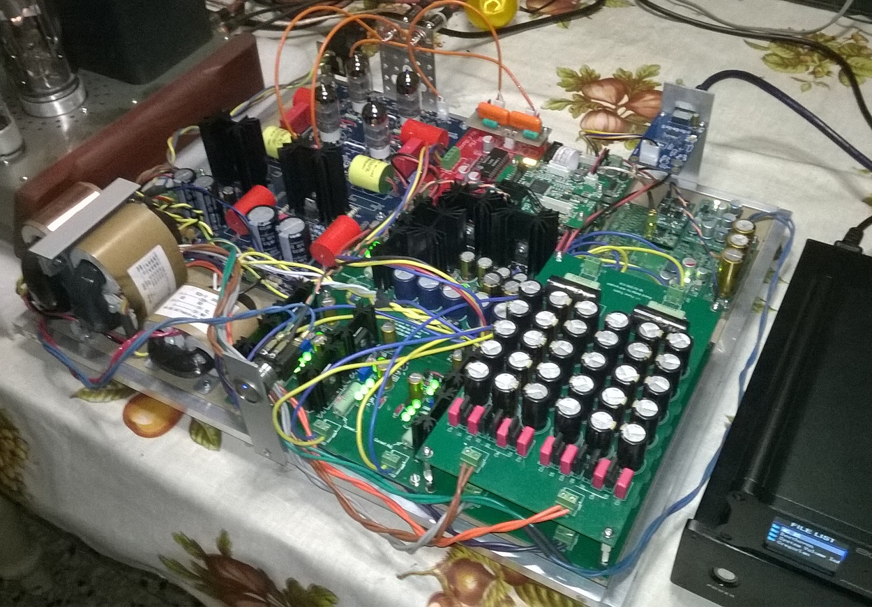

For example, in the IV stage I used a wirewound resistor from Rhopoint, that's very smooth. In the same stage I used VT rather than solid state devices, the 6N23P gray shield from 1975, that's very detailed and smooth. Then VT again in the power amp, the Psvane WE845, that's the best power DHT I have ever heard.
But the big difference I found is changing the clock of the system. I have tried many options, and each time I changed the clock the sound changed dramatically. The same thing changing the clock of the source.
I believe that after a long time tweaking the system I did reach an optimal combination.
So the standard Taiwan '98 keeps its detailed character without any harshness. With unplugged music it's so realistic, Baremboim and the Steinway grand piano at home!

Your Dac is wow complicated Andrea. welcome to the spaghetti club. LOL
Regs are LM/LT stuff ?
