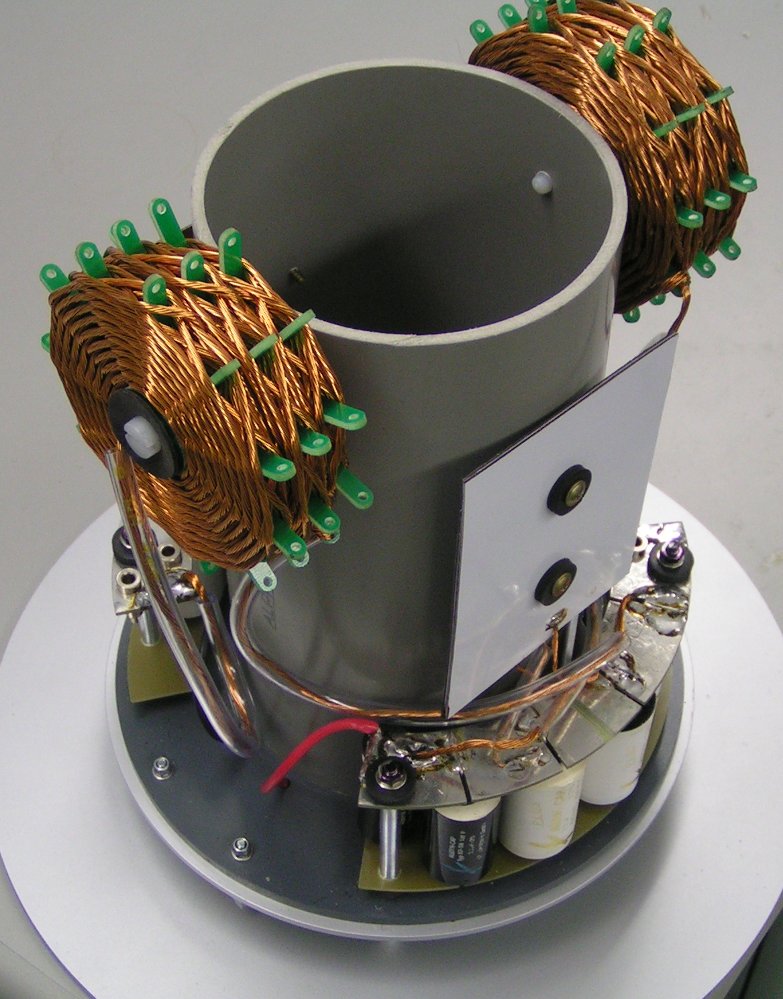

The speakers are semi 2-way omni-directional systems with very high resolution passive crossovers, and a third internal speaker that acts as corrective element (magneto-dynamic correction loop) and as acoustically driven subwoofer. Efficiency is better than 100dB (1W / 1m).
Passive crossover filters consist of two home-made multi-segmented honeycomb air core chokes, based on home-made 12 x 0.4mm litz wire, and two hybrid caps. Crossover frequency equals 5 KHz. Filters are second order (12dB / octave).
I attached a photograph showing this passive crossover.

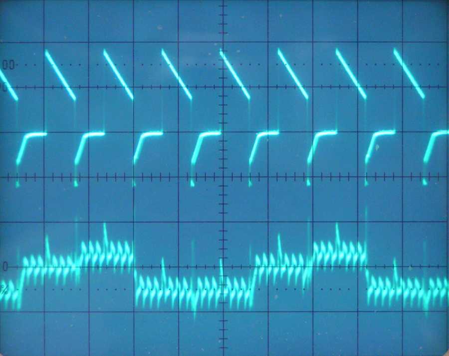

DEM syncing with input data would remove statistical average, so with a good pcb layout(tracing) and capacitors with low leakage, low ESR, ESL and impedance(1-10u 1206 X7R) standard asynchronous solution sounds better.
Asynchronous DEM clock would introduce a second clock source in the system. Since there is on-chip crosstalk between both DEM clock and bit clock (BCK), inter-modulation between these two frequencies will occur. Other problem is that the DEM oscillator has significant DATA induced jitter (frequency fluctuates with I2S DATA pattern). I doubt if external filter caps can prevent increased timing jitter at the output latch that is a result of this inter-modulation.
I attached an oscillogram showing typical asynchronous DEM clock during playback (upper picture), and synchronous DEM clock during playback (lower picture).
I also attached an oscillogram of an unfiltered active divider output (decoupling cap removed). The BCK crosstalk is clearly visible (DEM clock rate equals 352.8 KHz here. The stair-case signal is caused by tolerances in the passive divider that drives the time averaging matrix. First two passive divider outputs match quite good, but number 3 and 4 (active divider has 4 outputs) show significant tolerances.
Higher active divider decoupling capacitor values will increase peak currents. Increasing DEM clock rate (works up to approx. 2.8224 MHz) may affect settling time in the time averaging matrix.
The trick is to use optimal synchronous DEM clock rate, and optimal active divider decoupling caps.

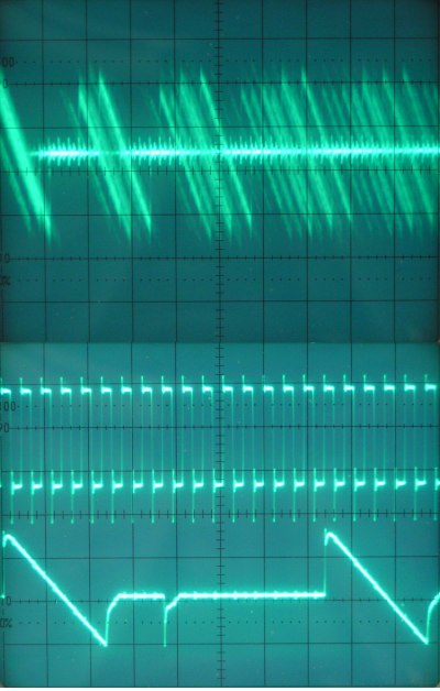

yes yes, ground is everything...This depends on the application, both square (ground-bounce) and sine wave (trigger uncertainty) signal injection increase jitter and affect jitter spectrum. The trick is to determine the lesser of these two evils. I had slightly better perfo
forget it, use good decoupling, and statistical averaging help get you the best sound😉Asynchronous DEM clock would introduce a second clock source in the system. Since there is on-chip crosstalk between both DEM clock and bit clock (BCK), inter-modulation between these two frequencies will occur.
no-noOther problem is that the DEM oscillator has significant DATA induced jitter (frequency fluctuates with I2S DATA pattern).
somsing wrong with you asynchronous DEMI attached an oscillogram showing typical asynchronous DEM clock during playback (upper picture), and synchronous DEM clock during playback (lower picture).

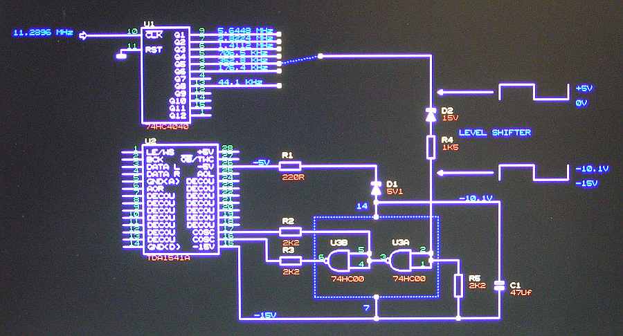

I'm also trying to build a DEM reclocking circuit. At first I built Henk ten Pierick's circuit (first page of this thread), but it didn't work too well, so I started searching for another circuit. I found it
Kind regards,
Joris
I will be happy to see your schematic diagram🙂...I will find a circuit-draw program tomorrow and upload my schematics, but only if it works of course😉
Kind regards,
Joris
Here is my schematic.
I built it with reference to -ecdesigns- circuit, he's the one who set the
basic setup for this circuit. All the credits go to him.
Instead of taking the -5v power line into a resistor and a zener diode I decided to use a 7805 voltage regulator. This ensures that the 74HC74's will not cause noise on the power lines. The circuit is pretty sensitive for noise in the environment, so copper shielding the whole pcb is a pretty good idea.
Also use of shielded cable to connect the pcb to pin 16 and 17 is usefull.
The input of the 74HC4040 is connected to a clock source, in most cases that clock is 11.2896 MHz, in some cases it is 12.2880 MHz, the DEM frequency will increase to 384 KHz, this isn't a problem. I haven't tried what the maximum DEM frequency is yet. I can't guarantee that a sampling frequency of 96 KHz will work, this will result in a DEM frequency of 768 KHz.

Refer to EC's circuit R3, 4, 5, 6 should be 10K.
2K2 goes to -15V in oder to stop the internal clock.
Hi fastvideo,
I guess you have a different schematic. It sounds quite reasonable to connect the outputs through a resistor to -15v, but that is when the inverter outputs signals referenced to the ground. In this circuit, the signals are referenced to -15v already, so the connection to the -15v hasn't got to be made. The circuit works very well after a few tries, is it possible to increase the DEM frequency to 706,5 KHz? I'm willing to rewire the pcb, but I don't want to destroy my 2 TDA1541A's...
I must admit, after listening for some time, I noticed that there is better detail retrieval and tighter bass. This modification was worth the effort after all!
I attached the schematic EC drew.
