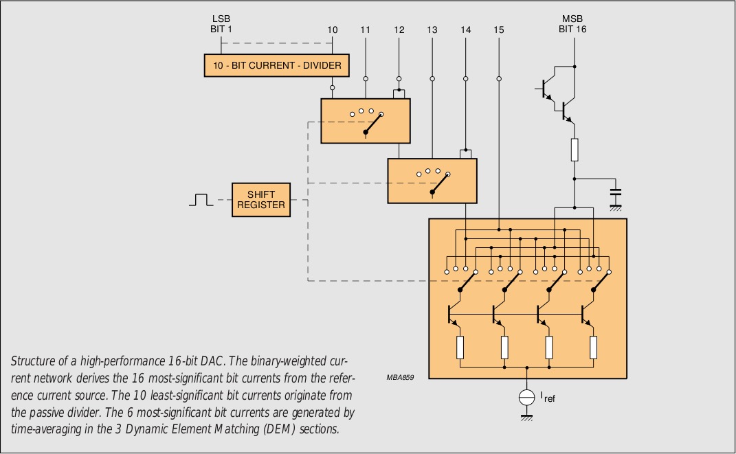

DEM clock is required to drive the switch matrix, part of active current dividers. The DEM clock basically changes switch matrix position (4-way electronic switches) after each DEM clock pulse. The TDA1541A has an on-chip DEM oscillator that requires one external capacitor (usually around 470 ... 560pF).
I attached a Philips block diagram illustrating DEM operation. The block "shiftregister" is connected to the DEM oscillator. DEM circuit provides 4 closely matched (time averaging) active divider output currents. This in turn increases DAC (long term) accuracy.

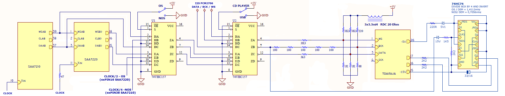

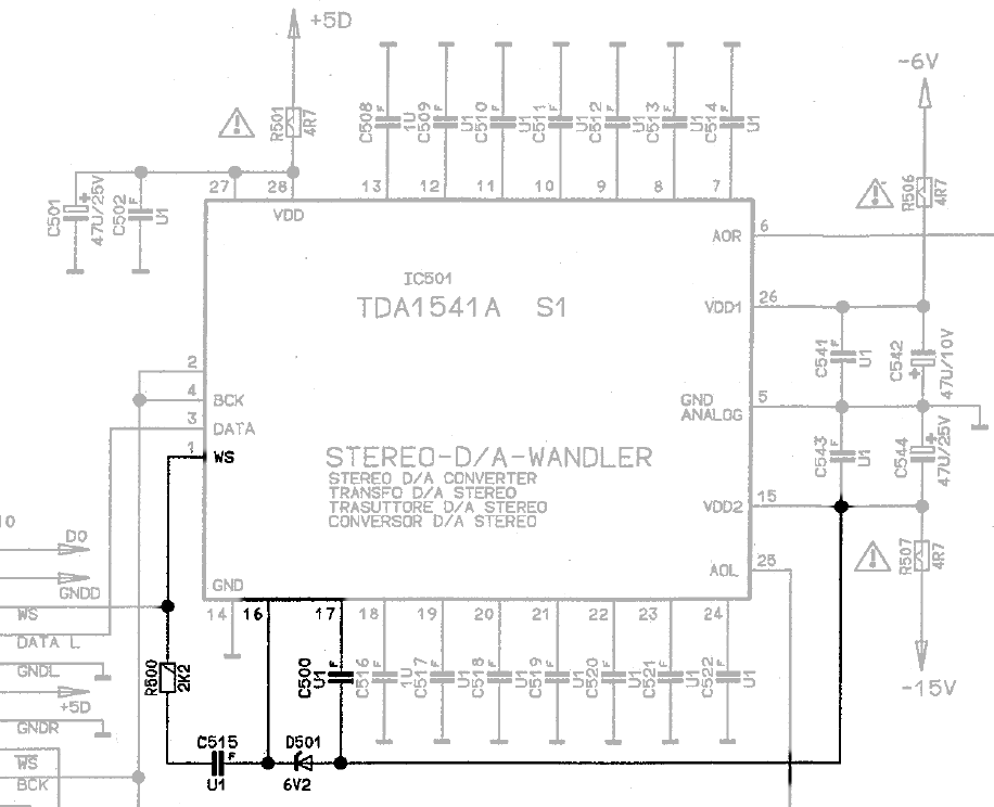

can you confirm that this circuit TDA1541 DEM reclocking will work
It will work, but when you read above explanation, you will notice that this approach doesn't allow ultimate performance (multiple dividers plus an extra D flip-flop).

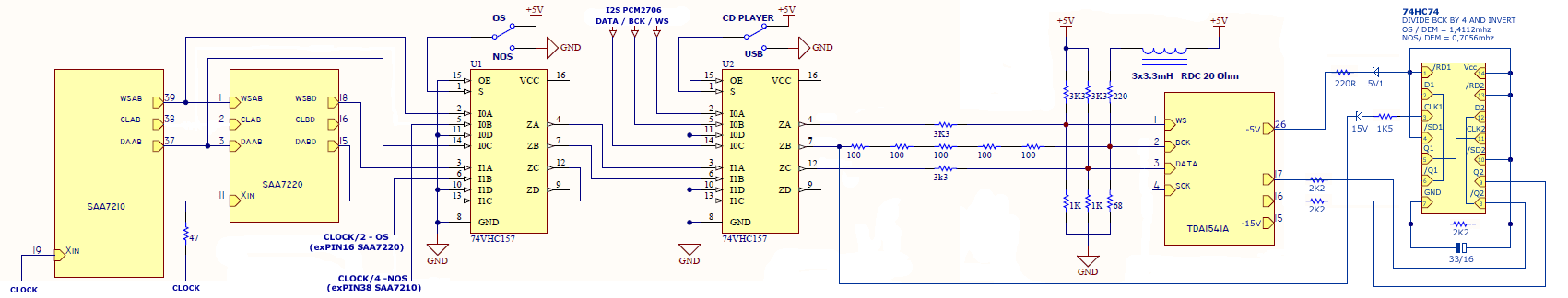

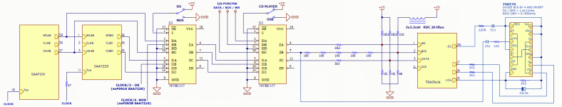

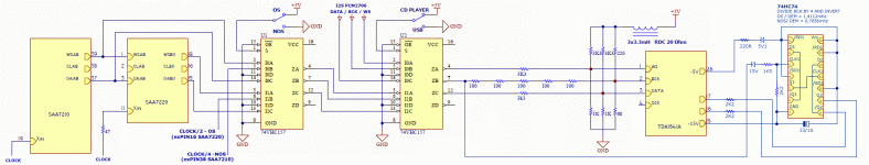

Hello ecdesigns,
many thanks for growing that DEM stuff out of you!
I will try the DEM-synchronization by chip first bevore your version with injekting over shottky and resistor. First bevore trying i will ask if the embed of the 74HC74 in the attachment is doing right.
Q1: can you confirm that this circuit TDA1541 DEM reclocking will work?
Q2: wich effekt will have to change the TDA 16 and 17 (16 to Q and 17 to /Q against 16 to /Q and 17 to Q) in this circuit?

and prevent DEM clock with our music from inter-modulating you need good decoupling of DEM currents
Yes you are correct,
I now plan to use 1206 size PPS or PEN SMD film caps that will be mounted underneath the TDA1541A in order to provide shortest possible connections. The tiny SMD parts use stacked foil construction and should have low inductance (more effective decoupling).
Active divider decoupling caps don't fully prevent crosstalk between DEM clock and bit clock. That's why I decided to use same frequency for both bit and DEM clock. This eliminates on-chip inter-modulation as both frequencies run in exact phase and have same frequency
I also plan to use two dedicated decoupling cap GND return paths, one for each channel. This also prevents interference with GND supply currents that might be super-imposed on the decoupling cap GND traces. This in turn keeps the active divider output currents as clean as possible.
Highest available value (1206) film cap is around 47nF/16V (AVX / Panasonic). This should be sufficient when using 8 times higher DEM clock frequency (1.4112 MHz).

good progress, i use 1206 underbody many years, it gives excellent results, but PEN or PPS have strong soldering thermal layout, and in this place lose X7R, NP0 (better ESL, ESR, capacity = lower impedance)
if caps with right capacity,ESR,ESL - completely.
statistical averaging. Philips engineers were not fools 🙂
not sufficient 🙁

I don't see the point of WS frequency equal to DEM frequency. Shouldn't it be 4x, 8x, 12x, or even 16x the WS frequency?
Should it be synchronous to WS at all? I am thinking of trying a digital PRBS (Pseudo Random Binary Sequence) generator for driving the DEM circuit.
With typical 4 times oversampling, WS frequency would equal 4 x 44.1 KHz = 176 KHz. This falls within datasheet DEM oscillator frequency specs. When running the TDA1541A in NOS, WS frequency equals 44.1 KHz, this DEM frequency is too low.
The reason the DEM clock must be synchronous with the I2S timing signals is that there is on-chip crosstalk between I2S timing signals and DEM logic. This can be proven by tuning the DEM oscillator cap (trimmer), on a certain moment the DEM oscillator will "lock" to the bit clock, this is only possible when there is sufficient crosstalk between bit clock and DEM oscillator.
When the DEM clock is not synchronized with the I2S timing signals, both DEM clock and I2S timing signals will inter-modulate, causing extra on-chip interference that leads to increased on-chip jitter and increased interference signals on both analogue outputs.
The active divider decoupling caps only filter the 6 MSB static bit currents, they cannot prevent the degrading effect of on-chip inter-modulation.
If the DEM clock runs from WS, that is one DEM cycle per sample, no matter in OS or NOS. So the question is: which is better: one DEM cycle per sample, or as many as possible (within the specs). If the latter is the case, could the DEM run from BCK? That would be about 1.4 MHz is NOS.
