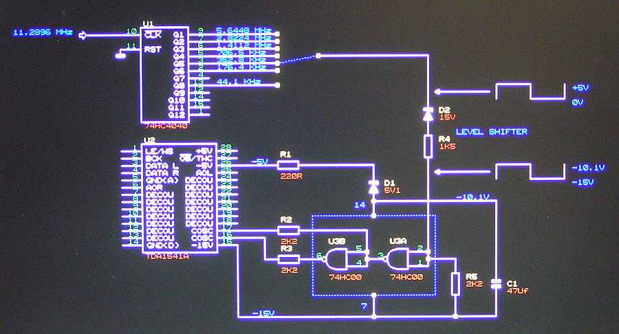

Sorry for the mistake. This is the first circuit i have tested, but it doesn't work well with me. http://www.diyaudio.com/forums/digital-line-level/146841-4xtda1541a-nos-dac-project-7.html#65
Hi fastvideo,
I guess you must have taken the wrong output of the 74HC4040, since the output frequency is twice as high as intended. What signal is at pin 2 of the 74HC00? You have to verify that the signal is 352,8 KHz at that point.
I saw a bit too late that you already have a working circuit🙂

Hi fastvideo,
Do you know what frequency sounds best when using 220nf decoupling caps?

Hi fastvideo,
I guess you have a different schematic. It sounds quite reasonable to connect the outputs through a resistor to -15v, but that is when the inverter outputs signals referenced to the ground. In this circuit, the signals are referenced to -15v already, so the connection to the -15v hasn't got to be made. The circuit works very well after a few tries, is it possible to increase the DEM frequency to 706,5 KHz? I'm willing to rewire the pcb, but I don't want to destroy my 2 TDA1541A's...
I must admit, after listening for some time, I noticed that there is better detail retrieval and tighter bass. This modification was worth the effort after all!
I attached the schematic EC drew.

You mean the easy one from post #3063 ?
This one from ECDesigns.
Except I connected the the 74HC00 supplies close to the Power supply regulators, not at the 1541 pins and on other side of ferret beads that supply the DACs.

I am using BCK divided by 8.....whatever that pin is on the 74HC4040....
But I have 48 bit I2S from a CD-Pro that is reclocked with low jitter clock. So its BCK is a little slower....than 64 bit.
Seems to work very nicely....
johnk
johnk

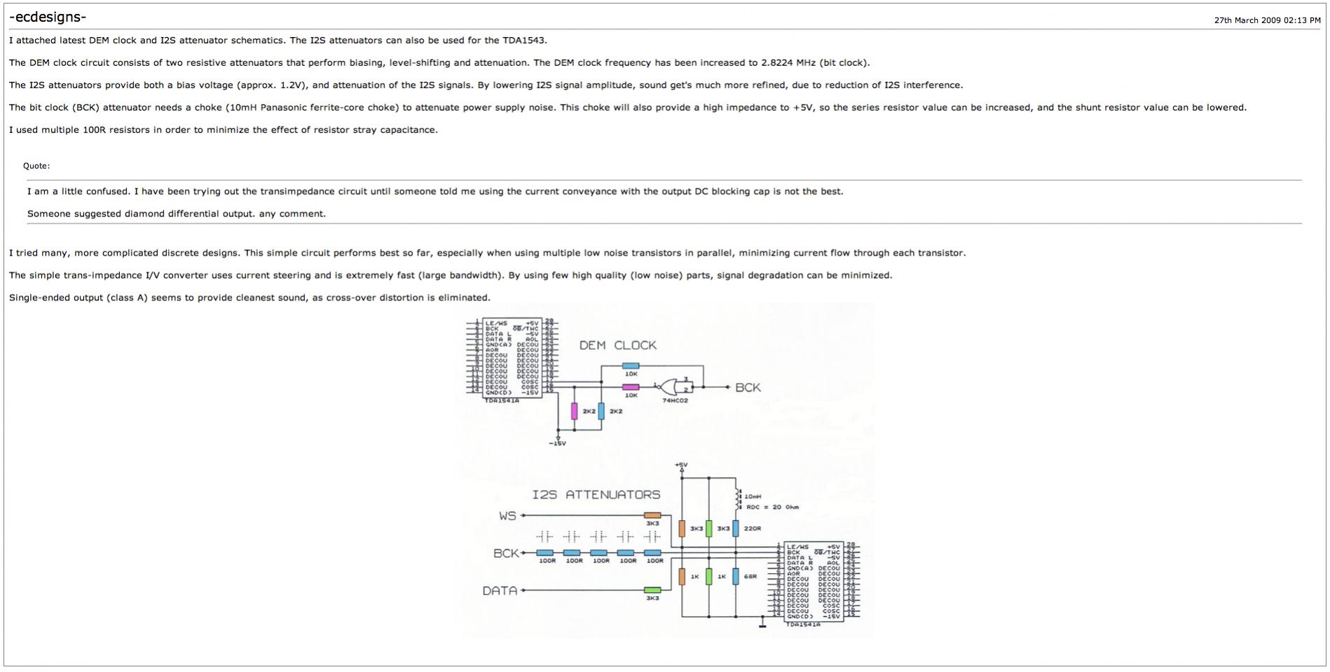

If i want to use the latest circuit from ecdesigns in the attachment for more than one TDA1541A, must i use only one 74HC02 ?
Could i simply parallel the output to Pin 16 & 17 ?
Have a look at Joris circuit in the right
PS. Grüße aus der Nachbarschaft (Anrath)
😛 Na die Welt ist klein!!
So only one 74xx for all TDA´s with decoupling R´s...
Only one 74hcxx with resistors will do. I tried to use one 74hc74 per TDA, but that made
things much worse. There was an awful lot of noise on the power lines, causing the logics to malfunction...
When anyone is building my design, please have a look at the 74hc4040 datasheet, I have misdrawn the schematics, the Q number is right, but the pin number doesn't match it.😉
Same at the schematics of ecdesigns ?
