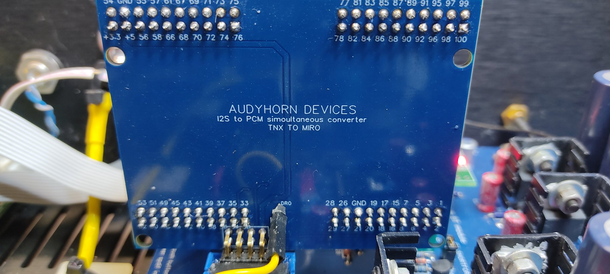

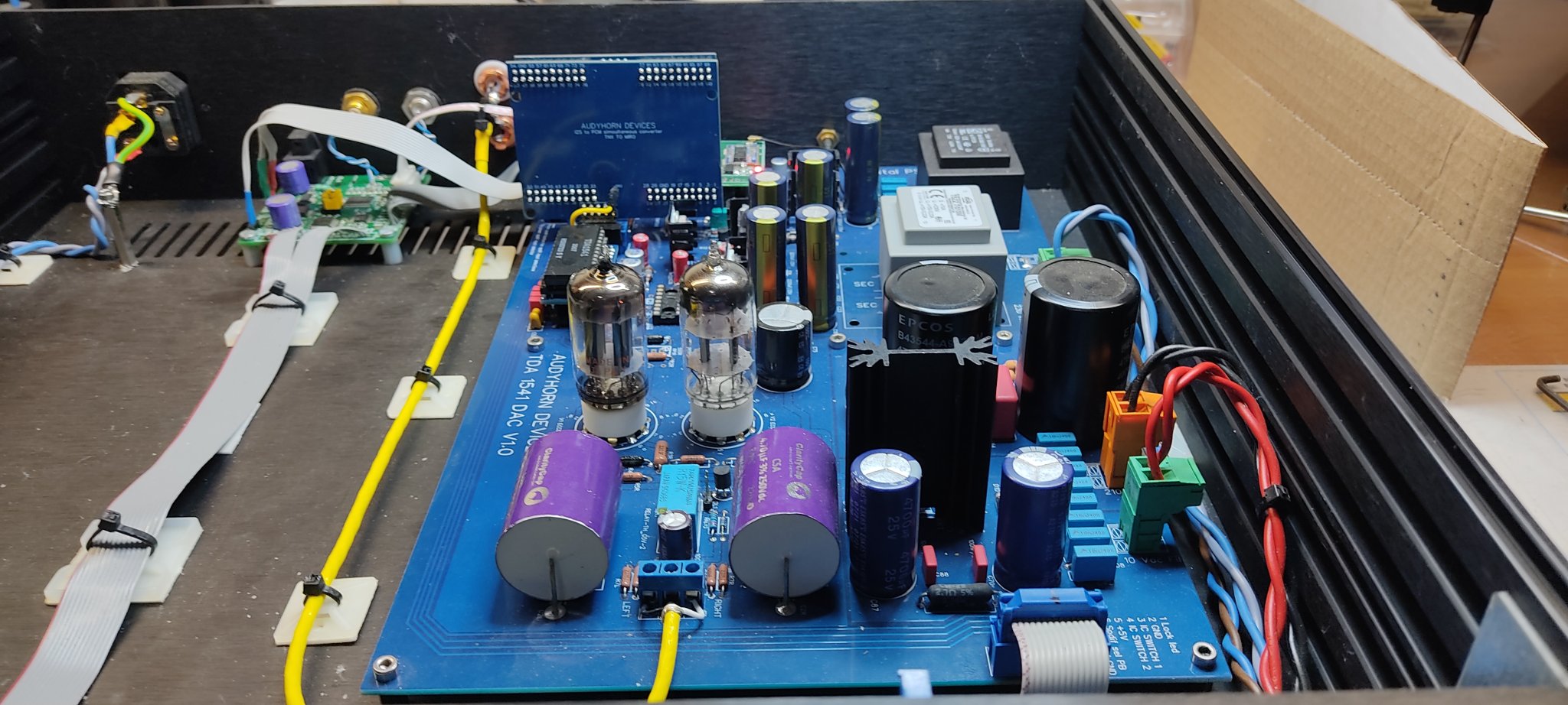

Antonio, I don't recommend using tantalum capacitors on the upmost two bits as seen on your photo. They are leaky, unreliable, sensitive to vibration, just to name a few of their issues. Just tap them with the handle of a screwdriver while playing, you will hear it yourself. You'd better use a conventional audio-grade electrolytic capacitor.
You're right...and I've already thought about replacing them the first time I disassemble the pcb again, but it's also true that they've also been used in the past by some famous brands and on players that sounded very good, so I wanted to try them.

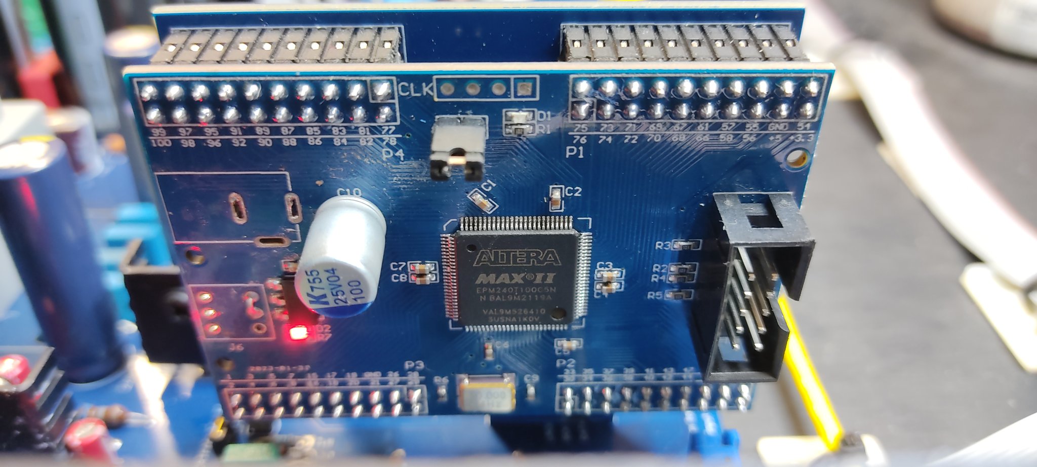

Hi Fabrice, yes I have built 3 types of i2s to PCM converters and they all work fine, but I prefer this one.
Miro DIY member gave me all the useful information, I adapted everything to my needs.
