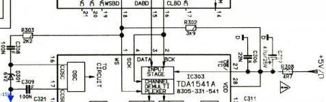

Hi: will you please share the schematic of your implementation?grunding solution

Usualy I use the one attached.

I have used the Grundig DEM circuit which I far prefer to the Phillips reference. I settled on the 100hz DEM with 100u decoupling proposed by ecdesign. This DEM with a very good clock and supercaps on the +-5v will take you to musical nirvana.

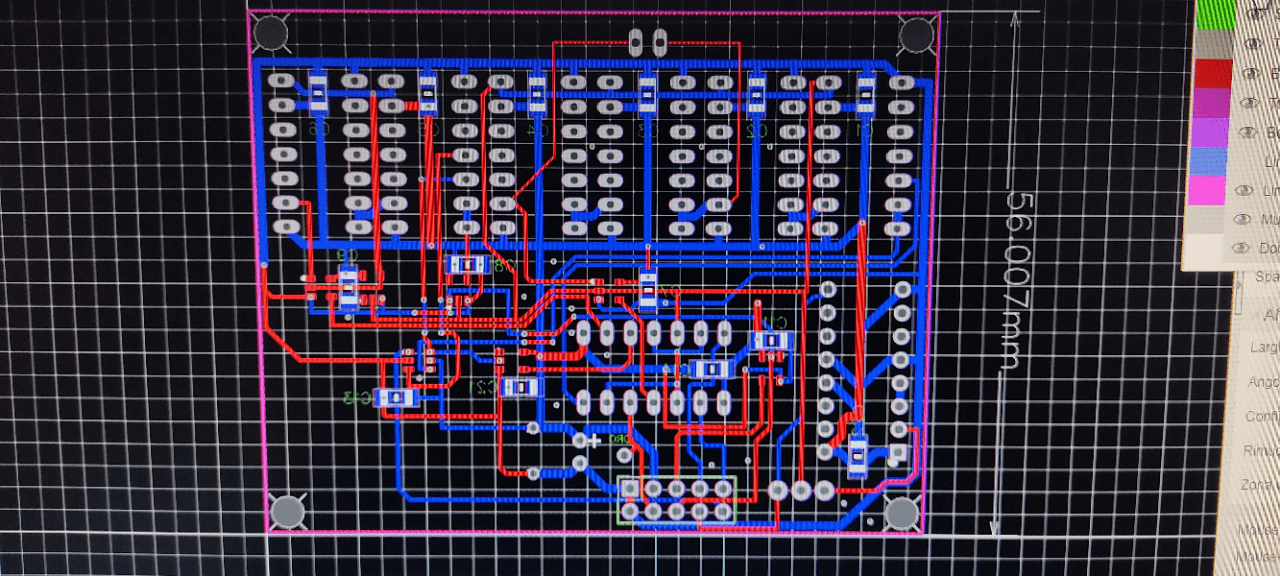

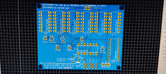

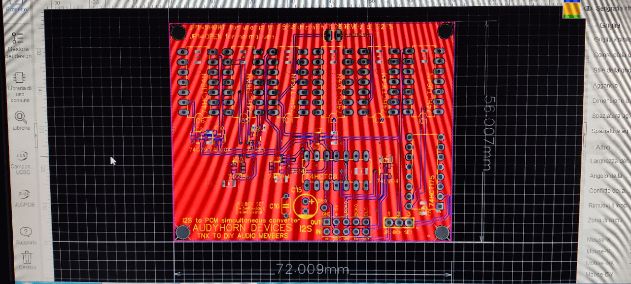

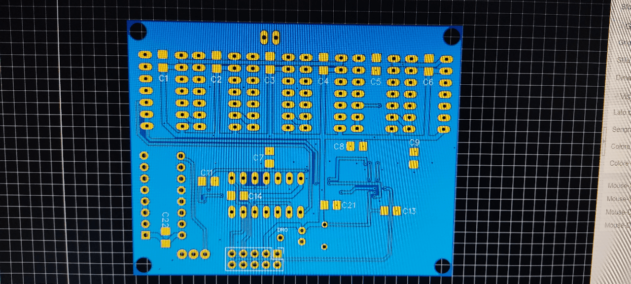

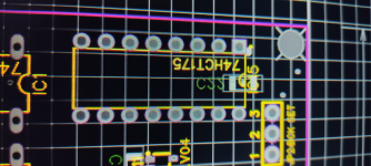

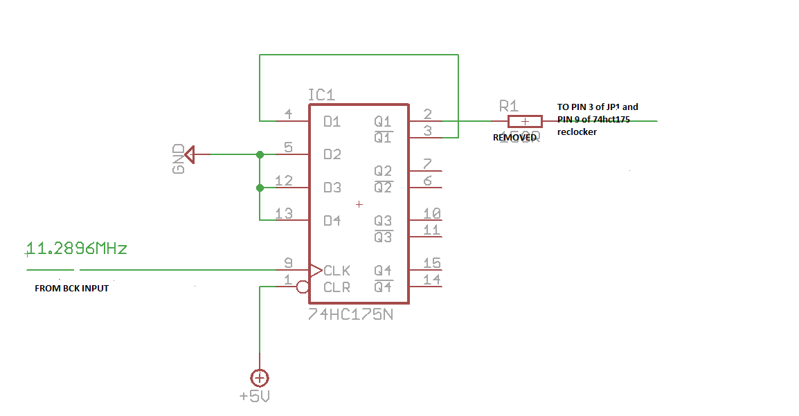

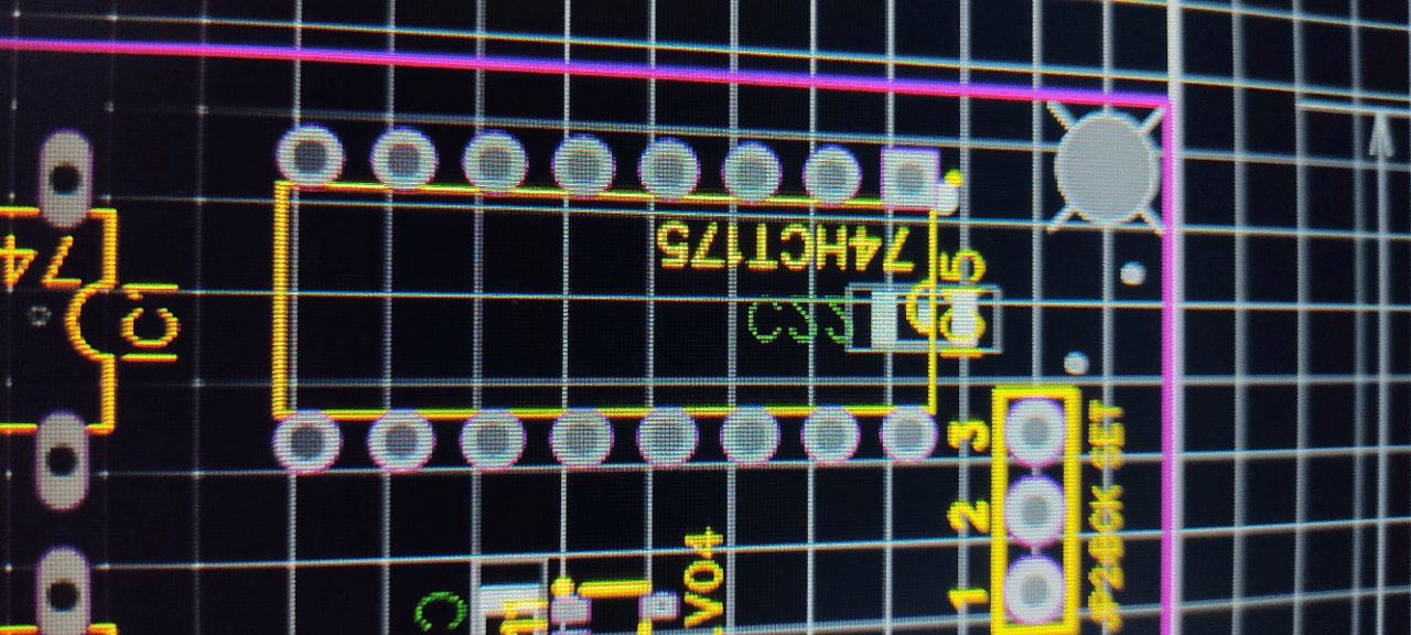

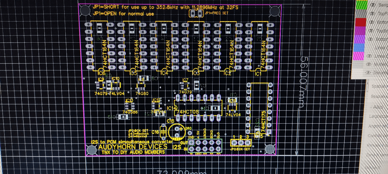

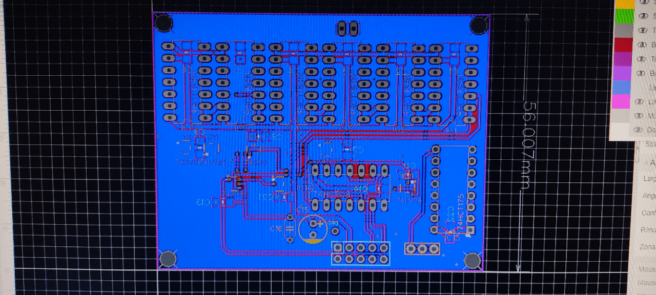

HI Guys!
after having spent some time studying the possible solutions, and reading here and there in the different threads, I think I have found the solution to my problem.
Nothing of mine (be clear...because I'm not capable of it) except the addition of 74hc175 as divisor of Bck (optionable via JP2).
I also added JP1 as well
for use up to 352.8kHz with 11.2896MHz at 32FS.
I would like to have your opinion.

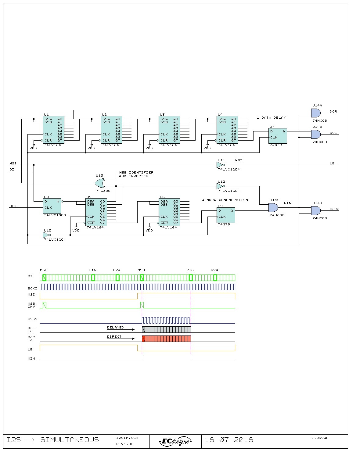

Thanks to ECdesigns for the wiring diagram of its intellectual property.

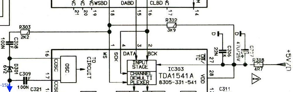

For use you will need to change your DAC mode from I2S to simultaneous (pin 27 (OB/TWC) connect to -5V) ... dac pin 1: LE, pin 2: CL, pin 3: DL, pin 4: DR

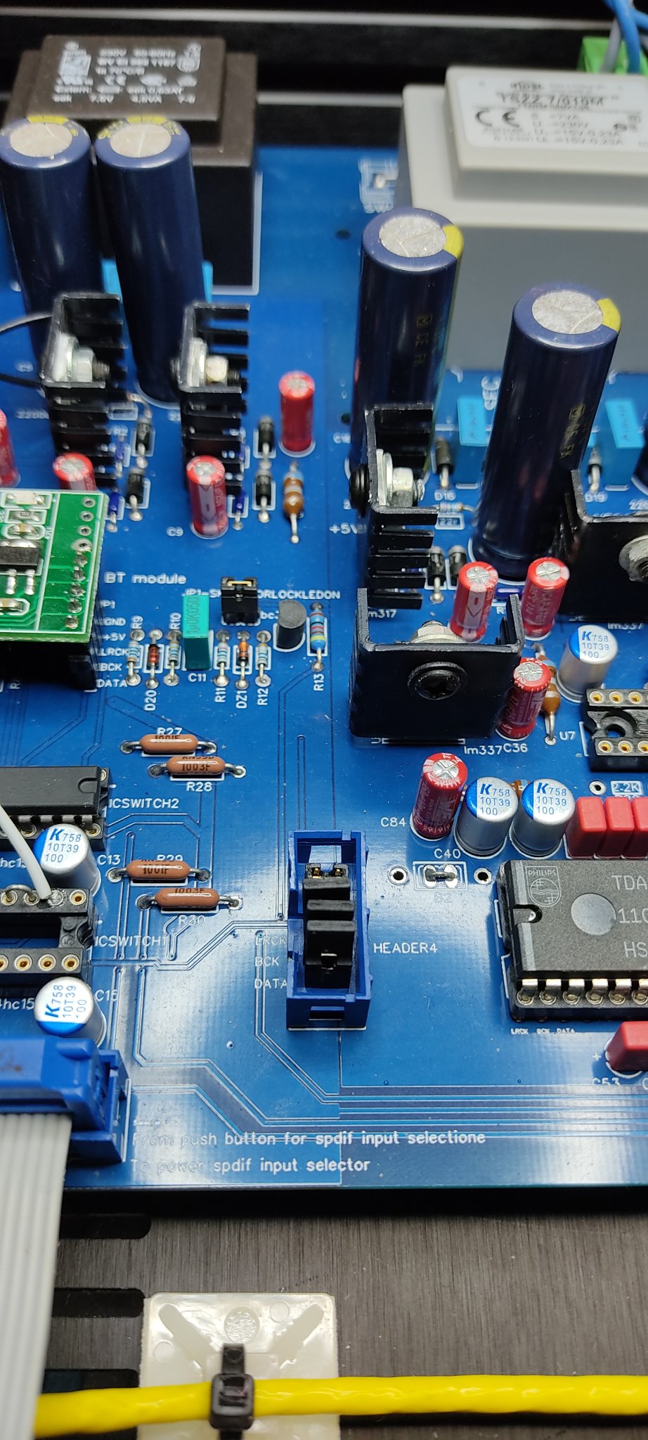

Unfortunately having prepared HEADER 4 did not save me from the modifications I will have to make to the MAIN pcb to pass from i2s (3 wires + gnd) to PCM (4 wires + gnd).
So now he will have to cut and sew some traces under or over there....
For the Community both the Gerber files and the JSON file.
I hope to do what you like.
You will notice that the I2S in/out connector is designed for a 10-pin HEADER vertical installation type plug and play referred to my DAC.
Obviously I had already foreseen +5v and GND on the HEADER pins.
Any advice is welcome.
Antonio
Antonio

Try to find the latest posts in EC design topic about the I2S-TS some members build it and seems that does not work?

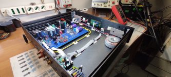

I implemented the Grundig DEM clock (along with 100uF electrolytic + 100nF ceramic filtering) and it sounds indeed good, even in NOS mode.Hi,
In NOS yes as I am using NOS not 4x oversampling.

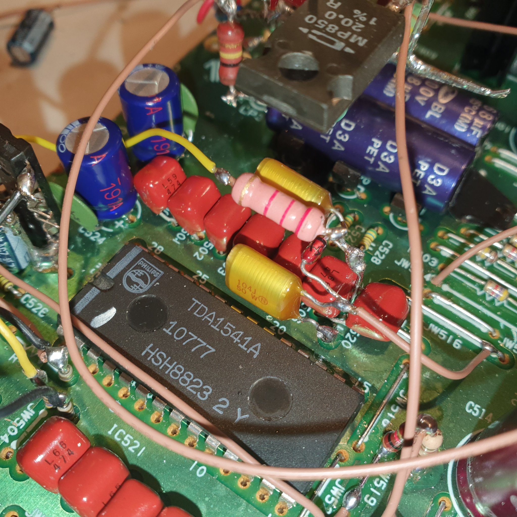

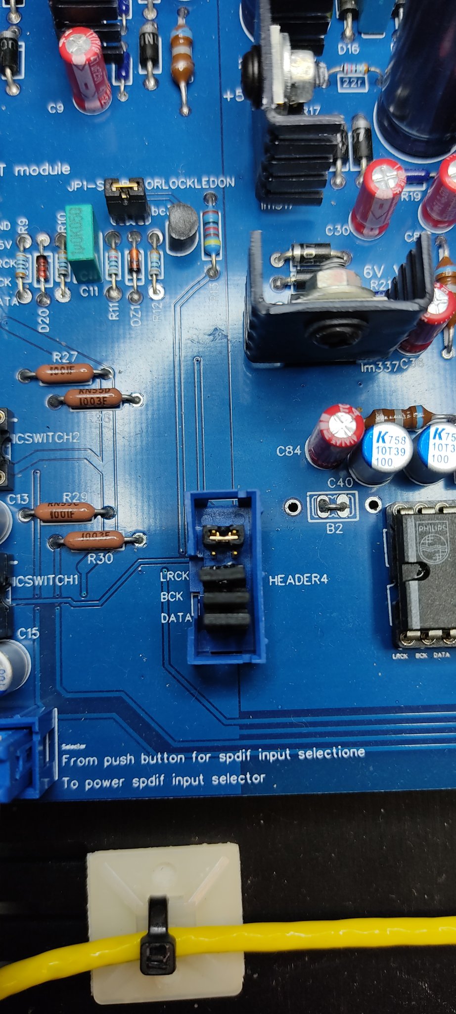

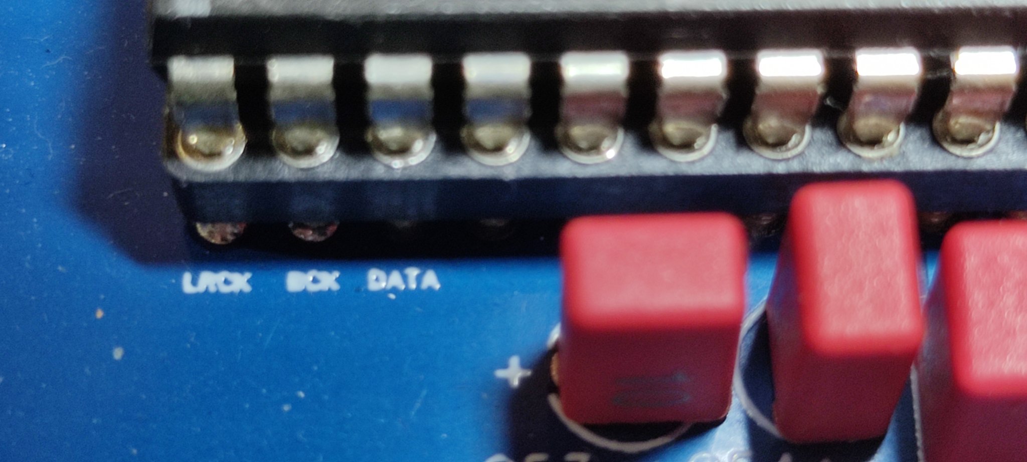

Antonio, I don't recommend using tantalum capacitors on the upmost two bits as seen on your photo. They are leaky, unreliable, sensitive to vibration, just to name a few of their issues. Just tap them with the handle of a screwdriver while playing, you will hear it yourself. You'd better use a conventional audio-grade electrolytic capacitor.Any advice is welcome.
Antonio
