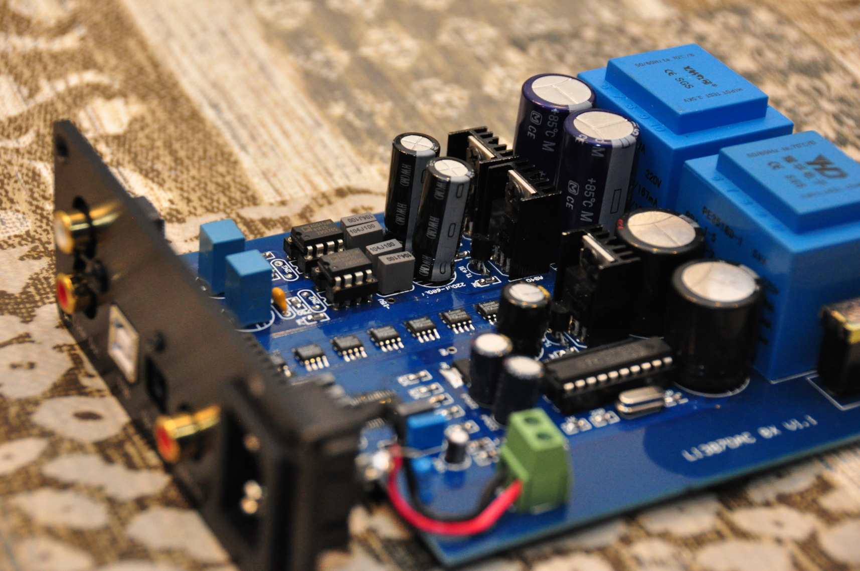

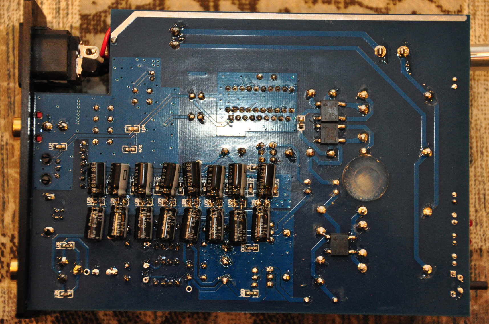

Here's what I've done to the pin7 caps - now two 470uF/10V in parallel, original ceramics removed, chosen for a slim profile so hopefully if I ever get a case for this board they'll fit snugly between PCB and case.
Well, Abraxalito, you inspired me to finally take a soldering iron to this board. I wasn't in a huge hurry, because simply dropping in the better opamps made it quite enjoyable. But, you mentioned before, the pin7 caps bring a little goodness to the bass, and indeed I found the bass a bit lacking in comparison to an off-the-shelf sigma-delta DAC I'm playing with right now. You were right, upping the capacitance across pin7 does appear to kick up the bass noticeably. While I was in there, I removed the 2n2 caps and replaced the 220 decoupling caps with 820s (still haven't added as much capacitance as you suggested there, but this was quick and easy).

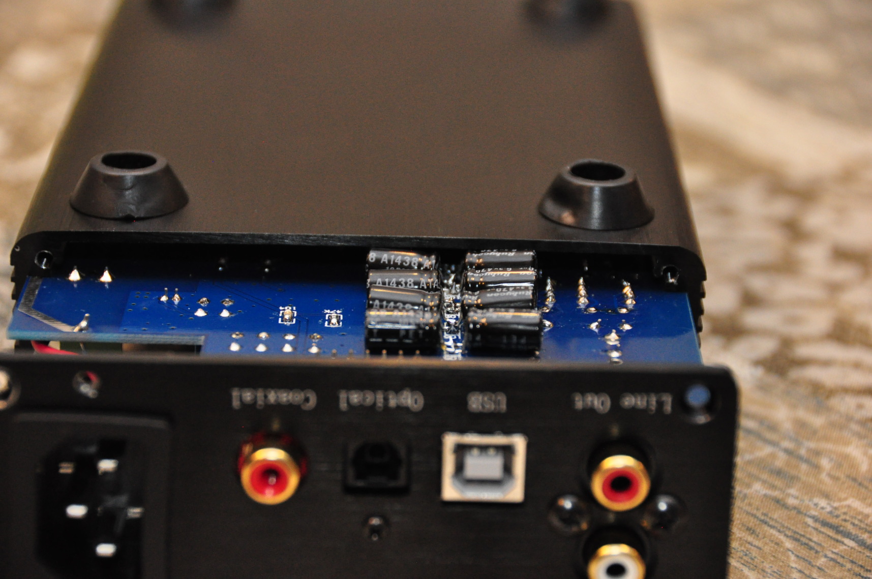

Now I face a more pedestrian problem: despite using those small 470uF/6.3V caps for pin7, they still stick up about 1mm too far for the PCB to slide back into the stock chassis. I'm not sure if the case of those electrolytic caps is conductive either, maybe they shouldn't touch the case? I'm thinking of taking a grinding bit to the bottom of the case where the caps are hitting it, hopefully I can make enough clearance? Then run some strips of electrical tape where the caps will touch. Is there an ideal non-conductive grease or lubricant I can use to help slide that PCB in with the caps rubbing against the case?
Surprisingly this worked first time. Initial impressions - very positive. Its giving less LF colouration than the last set of mods (done on the first instance of this DAC) even without optimization of the power supply (i.e. no outrageous numbers of caps so far).

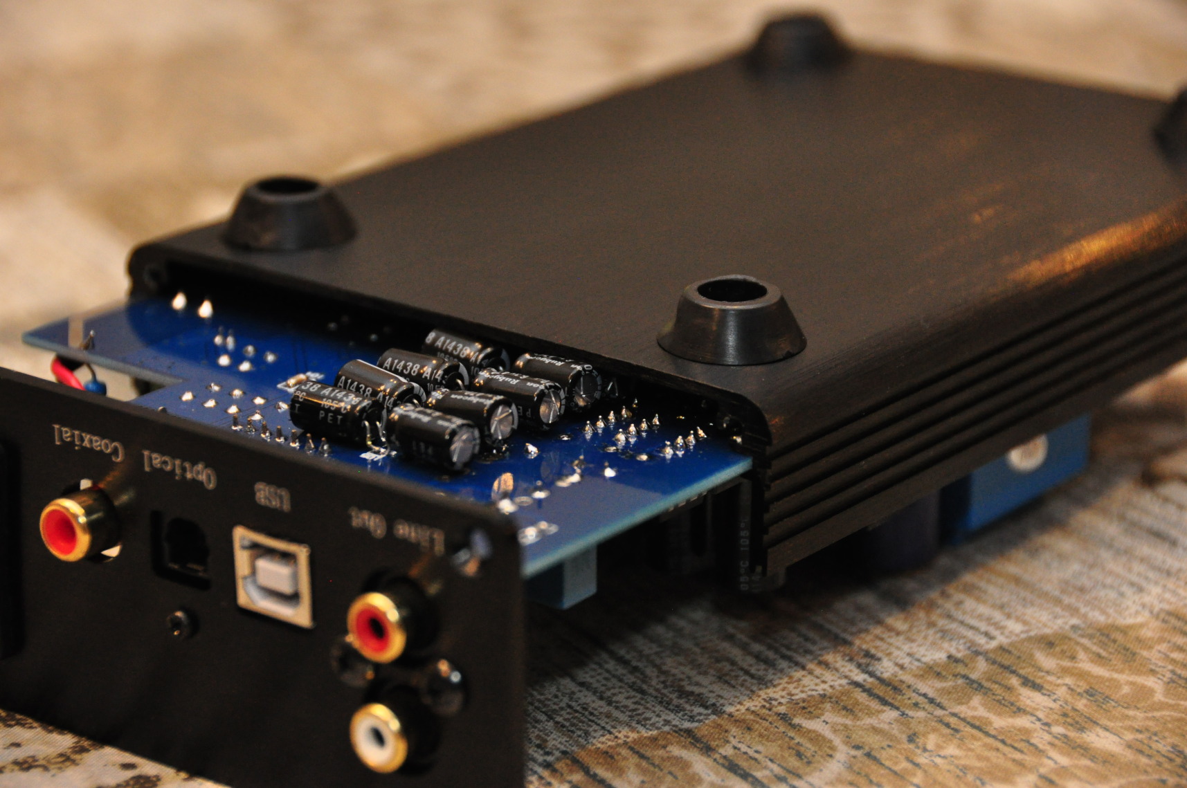

I took my verniers to measure the available height under the PCB - where the stuck-on bump is, the total thickness is 7.8mm. The PCB is 1.6mm so this gives 6.2mm before the caps protrude beyond the bumper. So I wonder if your caps are more proud because of some of the soldered joints absorbing clearance? I trimmed the IC socket legs to allow mine to sit flat to the PCB.

Yeah, it was that simple: opamp socket solder joints pushing the caps up just a bit too much. I trimmed 'em down, and could fit the PCB in the case. Unfortunately, that caused something to go askew: in this state, one channel was dramatically muted and the other channel was noticeably noisy.
Those electrolytics were touching random solder joints, the PCB, and the case. I suppose the cans themselves are conductive? Presumably something was shorted. Anything obvious from my description?
I took it out of the case, and now it's running fine. Damn if this thing doesn't sound great! Thanks Malefoda and Abraxalito for the awesome find!

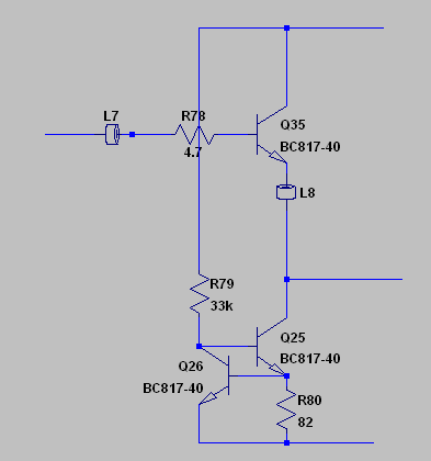

Here's the schematic for the classA buffer I'm using (four off) in the latest DAC mods. The two transistors at the bottom form a constant current source - its this CCS which can also be used to bias an opamp into classA. The bias current is set here by the 82R resistor for about 8mA. The transistors are literally 'two a penny' types in SOT23.

Definitely clearer, thank you! (A big part of the problem is that I lack some fundamental EE knowledge, though I'm slowly picking it up as I go.)

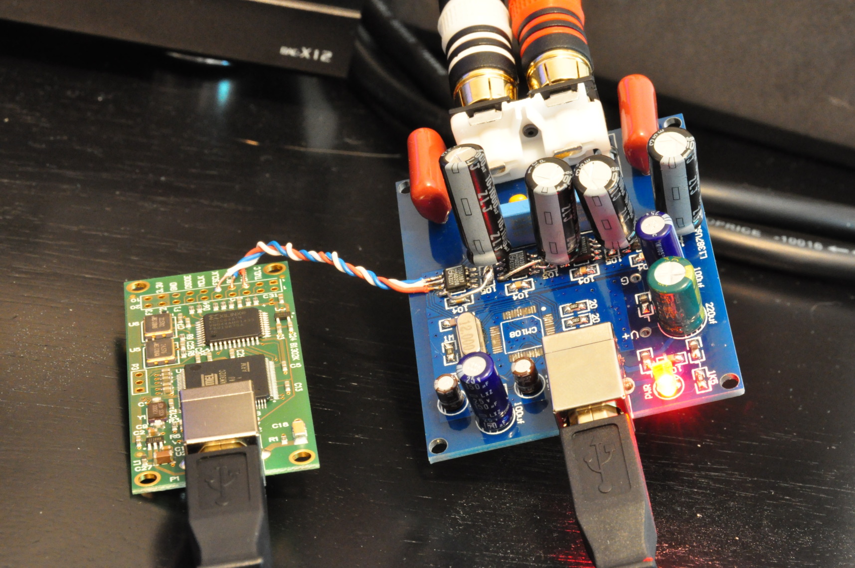

I bought a couple of the tda1387 x4 DACs. When I saw these, I really got my hopes up, that there was a simple parallel tda1387 board that could be easily modded to do what I want. And it is that, to some extent... but the board is kinda chintzy, or maybe I was just too cumbersome with the soldering technique. Either way, I pulled up a couple solder pads while trying to put some 10v/10k uF caps across pin7. You can probably see in the pics where I botched the solder pads, and had to make up for it by soldering extra lead directly to the IC pin4.
But, on the positive side, despite my miserable soldering job, the thing actually works. I removed the CM108 USB IC, and replaced it with an Amanero. The DC blocking caps were no-name electrolytics, so those got replaced with Pansonic 450v/1uF polypropylene caps I had on hand.
Power is still coming from USB. What would you guys recommend as a good DC power supply? I have my eye on this LT3042-based PSU from DIYINHK, though it seems a bit pricey.
It's hard for me to do quick A/B testing, but, listening to it now, I'd say this modded x4 is not too far from its fancier x8 big brother. I'm assuming there's some goodness still to be extracted with a real power supply, instead of my PC's USB power. Although I've only done the three or four easiest mods on the x8... waiting to see what Abraxalito has up his sleeve for that one. 🙂
