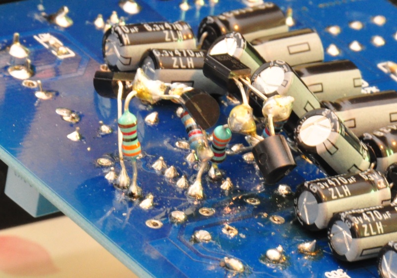

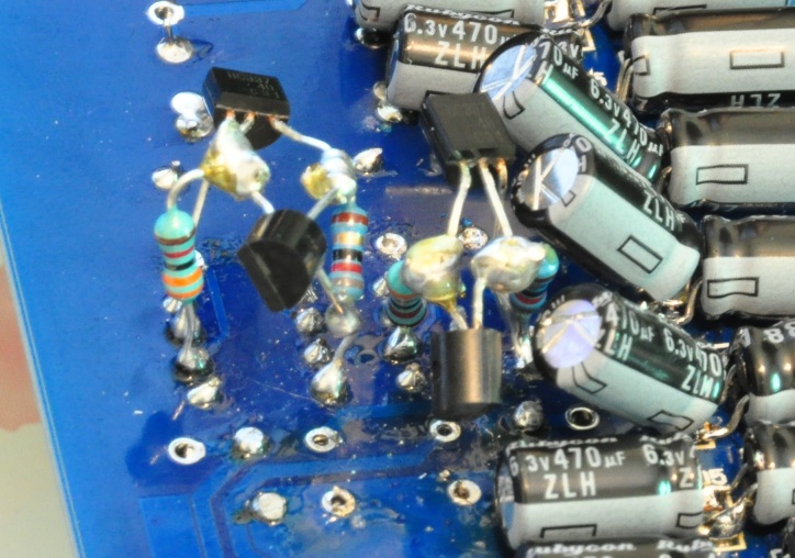

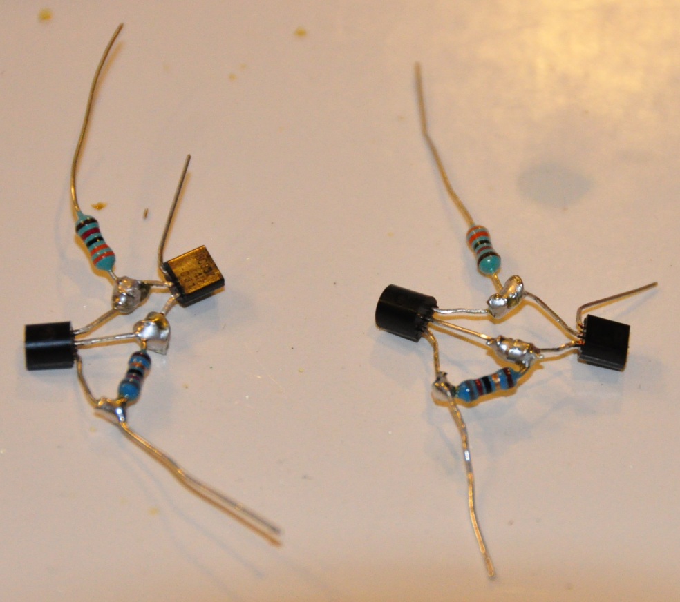

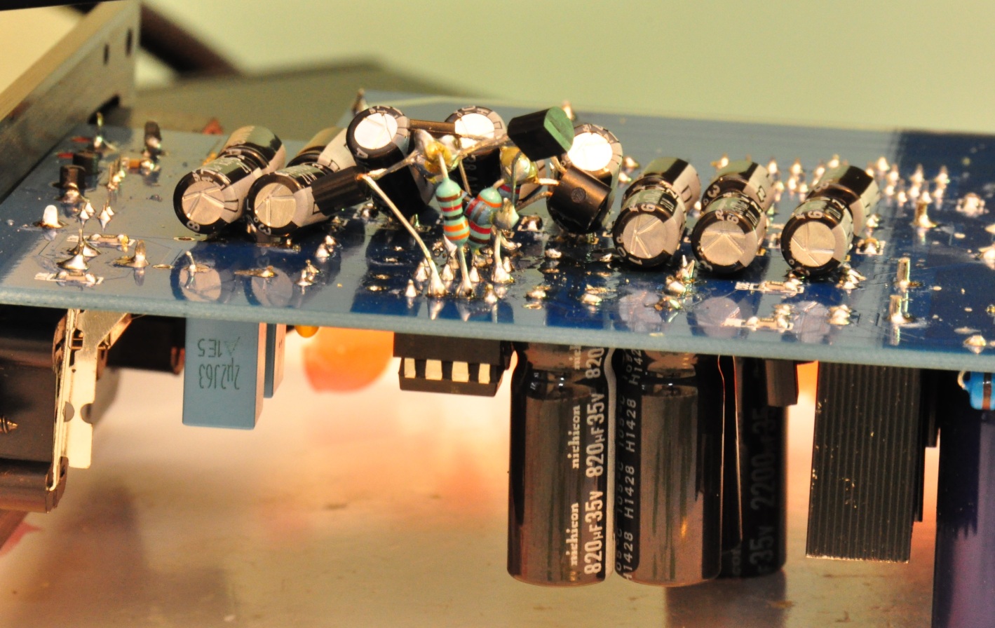

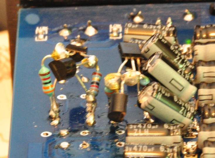

Op-amp constant current source mod completed! As Han Solo said, "She may not look like much, but she's got it where it counts." I definitely gave up any chance of ever putting this back in the case. But, I decided that this one I've been hacking on will be the "beta" version. When I've completed all the mods I think I'll go through and redo them all more neatly on another unit. (Or if I'm feeling courageous, maybe try to design a purpose-built PCB...)
I thought point-to-point would be easy... it's not hard so much as it is tedious. Just getting everything to stay in place before I actually started soldering required a lot of lead-bending with tiny needle-nose pliers.
Anyway, here are some pics.
Love all those 'air sculptures' - maybe I'll post up some more of mine soon
So how's the temperature of the AD845s now? I remembered after posting this mod that you'd not decreased their supply yet so they must be getting quite toasty with the extra 8mA or so of bias? Oh and any change to how it sounds?

That is correct, I have not decreased the supply voltage. Though based on what you said, seems like there is no reason not to. Maybe I'll try to do that before the weekend is over...
I let the DAC run all night, after I finished around midnight. So it's been running for almost 10 hours straight. I used to have one of those infrared laser temperature guns, but now I can't find it. I'll have to use the "finger on the IC" method of taking the AD845's temperature.
As for the sound change... it's not dramatic, but I think things are just a bit smoother, maybe a bit more bass tightness/definition. But maybe that's just expectation bias? It's definitely not hurting anything, that's for sure (well, unless I'm cooking the opamps).

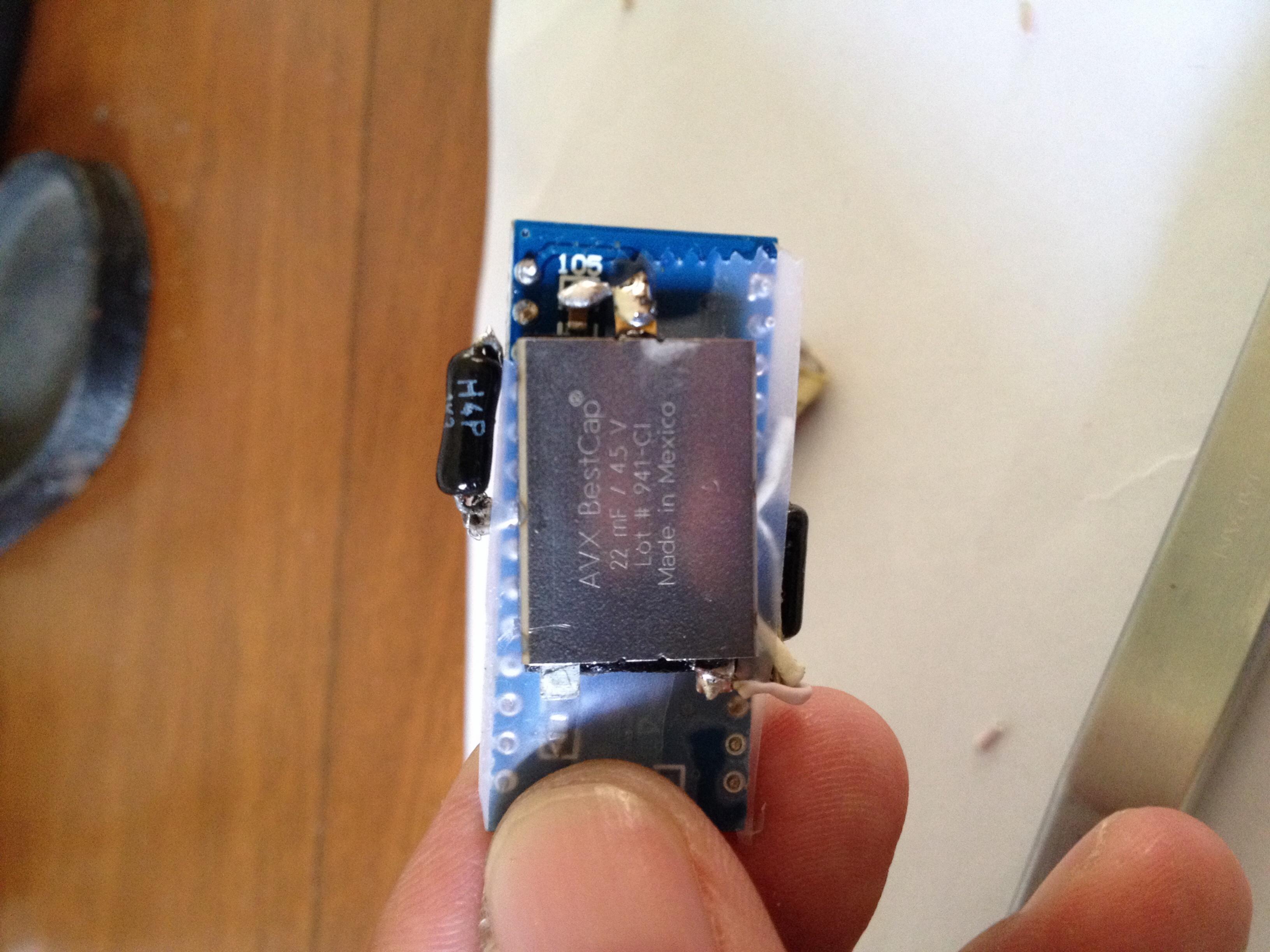

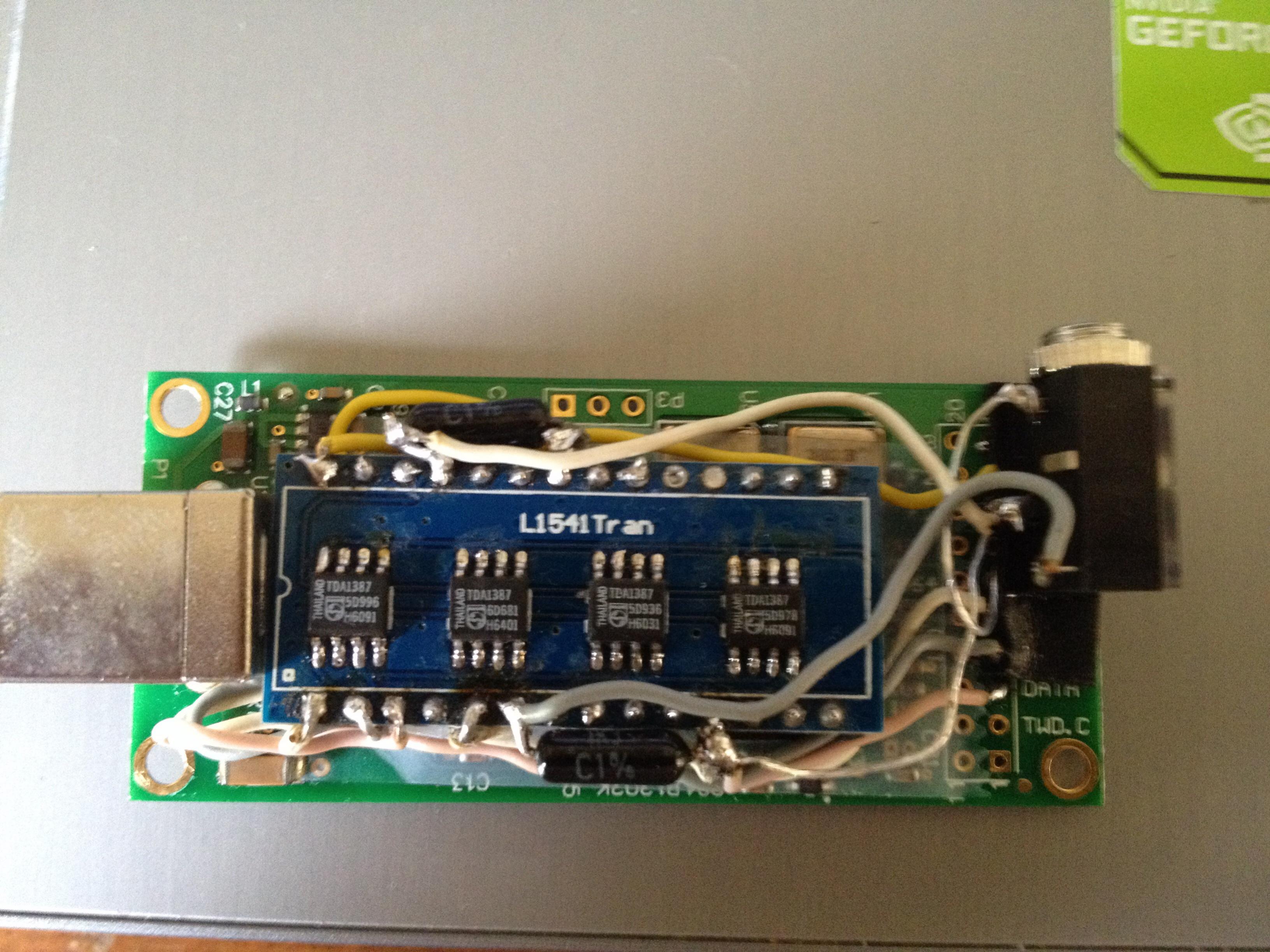

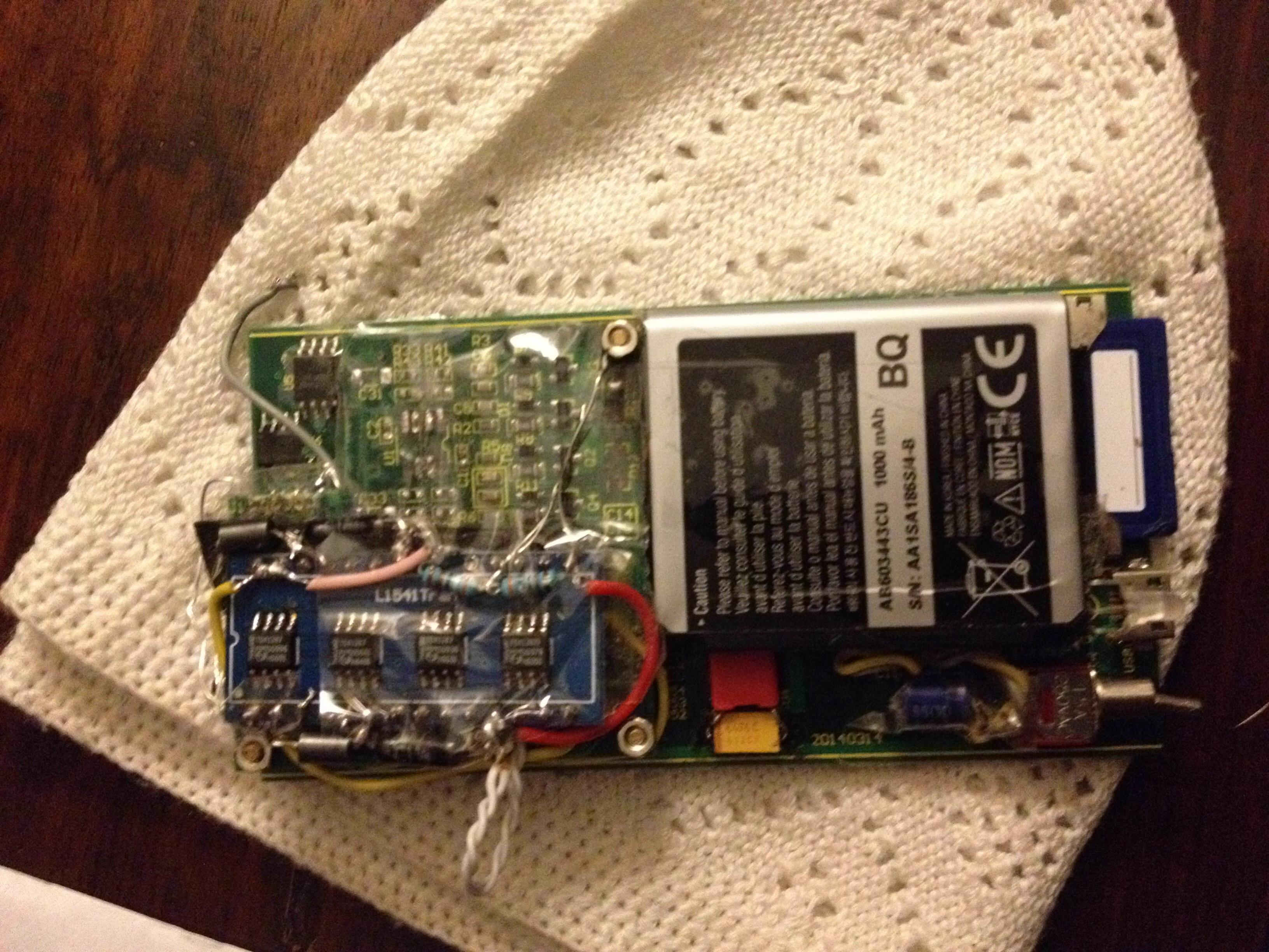

tda1387x4
hi,
this is my implementation of 4xtda1387 on my aune m1 dap. it by passibg the headphone stage and volume, using 1.3k iv resistor directly to headphone jack out to drive my 16ohm iem.
the other is when i attached to amanero using coupling capt om pin7 avx edlc low esr for 0.022mf
any suggestion on implement the tda on my dap?

So are you saying you have 4 TDA1387s (=4mA) and your I/V resistor is 1.3kohms? This gives too wide a voltage swing so you'll get clipping. But if you put the resistor in parallel with your 16ohm headphones you'll be in effect current driving the 'phones. But with only 4mA peak-to-peak current your peak power is just 64uW - its going to sound jolly quiet, perhaps 30dB down from maximum level?
If you're using an external amp to drive the phones and just want the Aune to work as a DAC then your maximum swing of 0 - 3.5V needs to be divided by the current (4mA) to get the I/V resistor - in this case 820ohms (nearest standard value).
If you put the headphones in parallel with the resistor the DAC will 'see' the headphone resistance and the I/V resistor is largely irrelevant (coz the headphones are much lower resistance).
